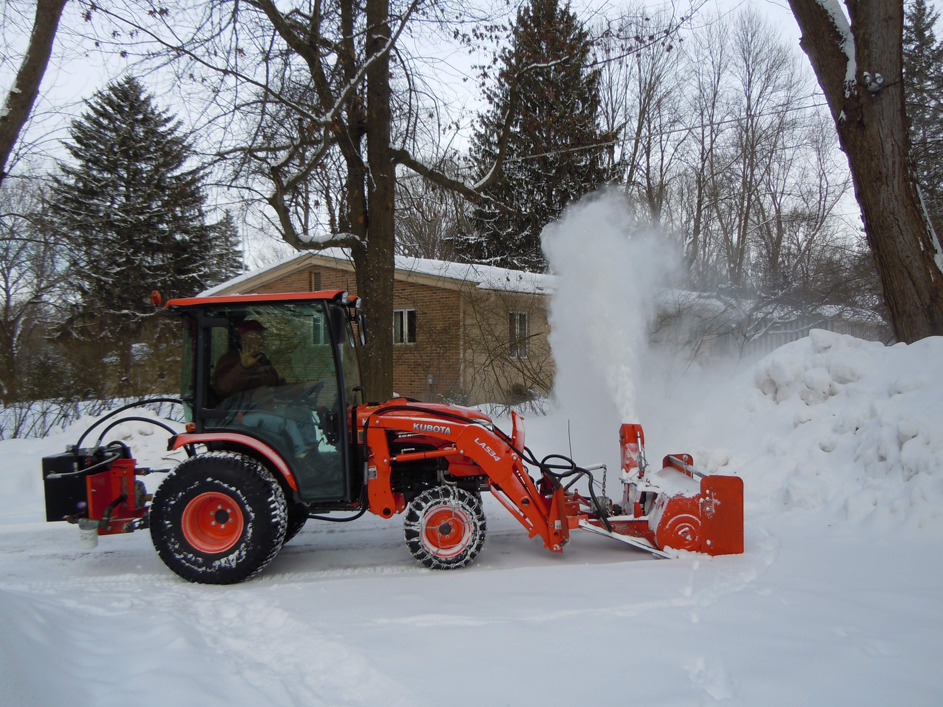

I want any mechanical ideas on how not to break the hoses or fittings when I inadvertently raise the FEL and tip all the way down-- Picture A. I'd like to take the slack out of the hoses and mount the cushion valve but too short and I'll break them on some numbingly cold day when I forget I can't do that. Picture B shows the about 3 extra ft of hose. I'm going to order shorter hoses but haven't figured length. I thought of a chain from the cross bar of the fel to the top of the disconnect. Looking for better idea.
Thanks in advance. Rob
Looking at your picture A, I'm wondering how those tires do in the snow? R4's seem terrible in snow.

I haven't used this L39 setup in years because of the poor performance of the blower. We don't get a lot of snow . I have used the below but the summer/ winter changeover got me thinking about this motor change and the excitement of a 2 minute changeover.
