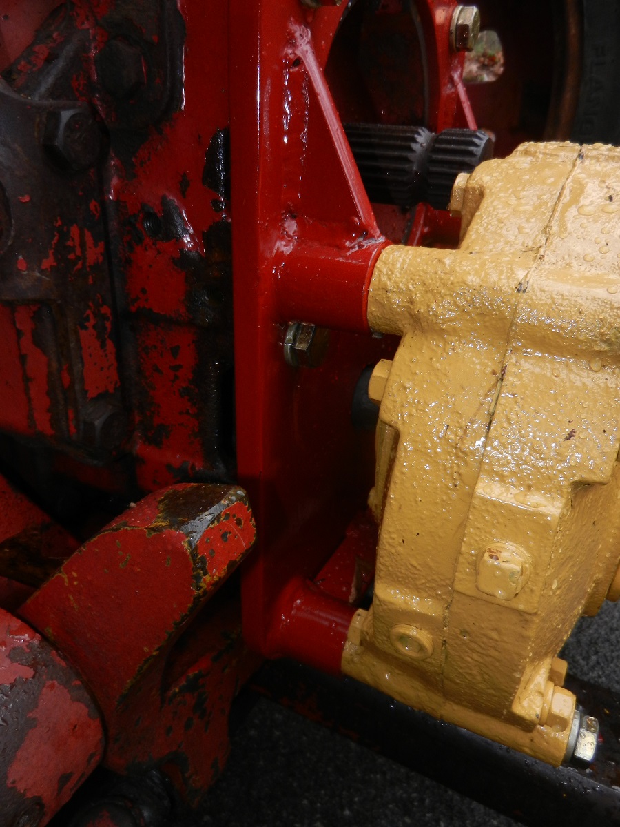

I've got this 1/2" plate mounted to back of PTO. I mount my mower to it.
The plate has an approximate 4" hole for the 1000 shaft to poke through and and a (don't know the measurement) 1 1/8" hole for the 540 shaft to poke through. It totally fits around the 540 shaft but it gives me the heebie jeebies that one side of it is too close. (I know that as long as it's not hitting, it's not too close but I'd like it slightly further away)
The 540 shaft is (slightly) but noticeably off center. I'd like to enlarge the hole maybe 1/8" to maybe 3/16"
I currently have bracket removed and in my hands.
I was thinking maybe a stepped drill bit?
Reading up on them, people use them for thin metal, wood.... not seen anything about 1/2" steel so it might not be up to the job.
What's best tool to simply ream out an existing hole a fraction of an inch??

I can't really tell what we're talking about from that picture. If this plate can be removed, I'd try a die grinder of some kind. Just grind out the area you need, even if it goes a bit oblong.
You might even be able to do it with a rat tail or half-round file if you have room to work.

Sorry late to respond.... where to start...
The plate is currently off and in my hands. It DOES mount rigidly to the tractor, I have no reason to think it might flex.
I had a shaft snap and as it snapped, it must have wobbled a bit (?) At the "4:00" position, there is a hot spot and a SLIGHT deformation where the shaft rotated. (shaft is 100% clear of hole when shaft is intact, the breaking of the shaft caused this)
If the shaft is (I don't know) 1 1/8" wide, this must be 1 5/16's wide. It clears but it's close. (you can tell it was well executed and well measured when I had it made.
