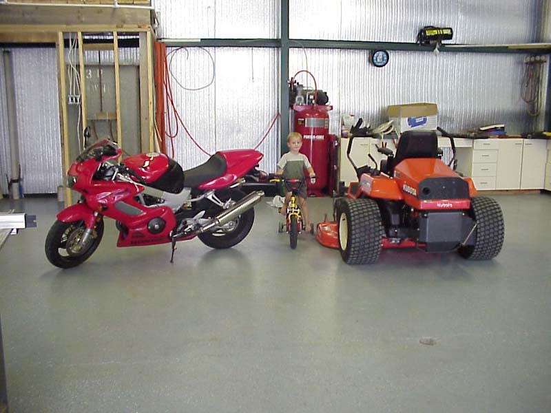

Ahh. A discussion on Harleys, and someone brings up a Superhawk 996. Makes me feel all warm & fuzzy inside.
The sport bike guys say "that aint no sport bike, it's got a V-Twin."
The cruiser guys say "That aint no cruiser, look at all that plastic."
I believe only the Ducati guys truly understand.
...the pic is of my most recent family members.
