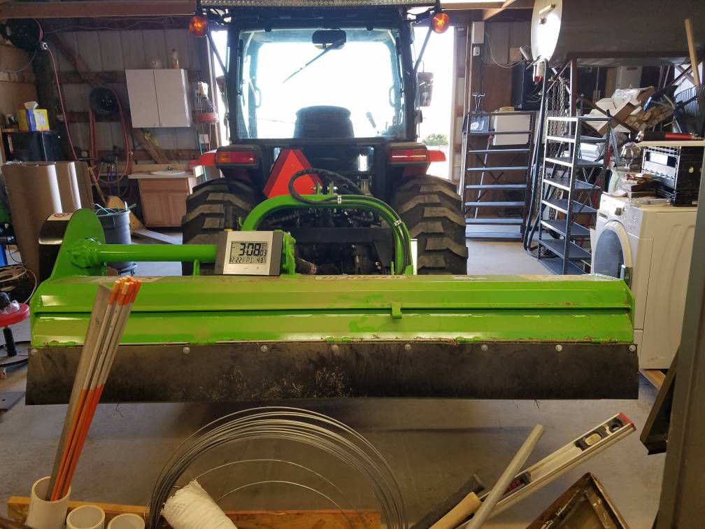

My L4060 is the same machine. Smaller engine, front axle & tires. But within 300lbs of the bigger machines. I can pull a plow or box blade 85-90% as well as the 60hp machine as I'm traction limited rather than power limited most of the time.
I wish I had more HP for mowing & roading, but that's it. I run an excessively big 8' heavy flail mower on mine too. The rest of the time I'm limited by traction or a rough ride. That's wit a 40hp machine that's probably only a 35hp machine with the lack of oxygen up here in Colorado. That's the same base machine you are looking at with more HP. 20171222_150735.jpg
