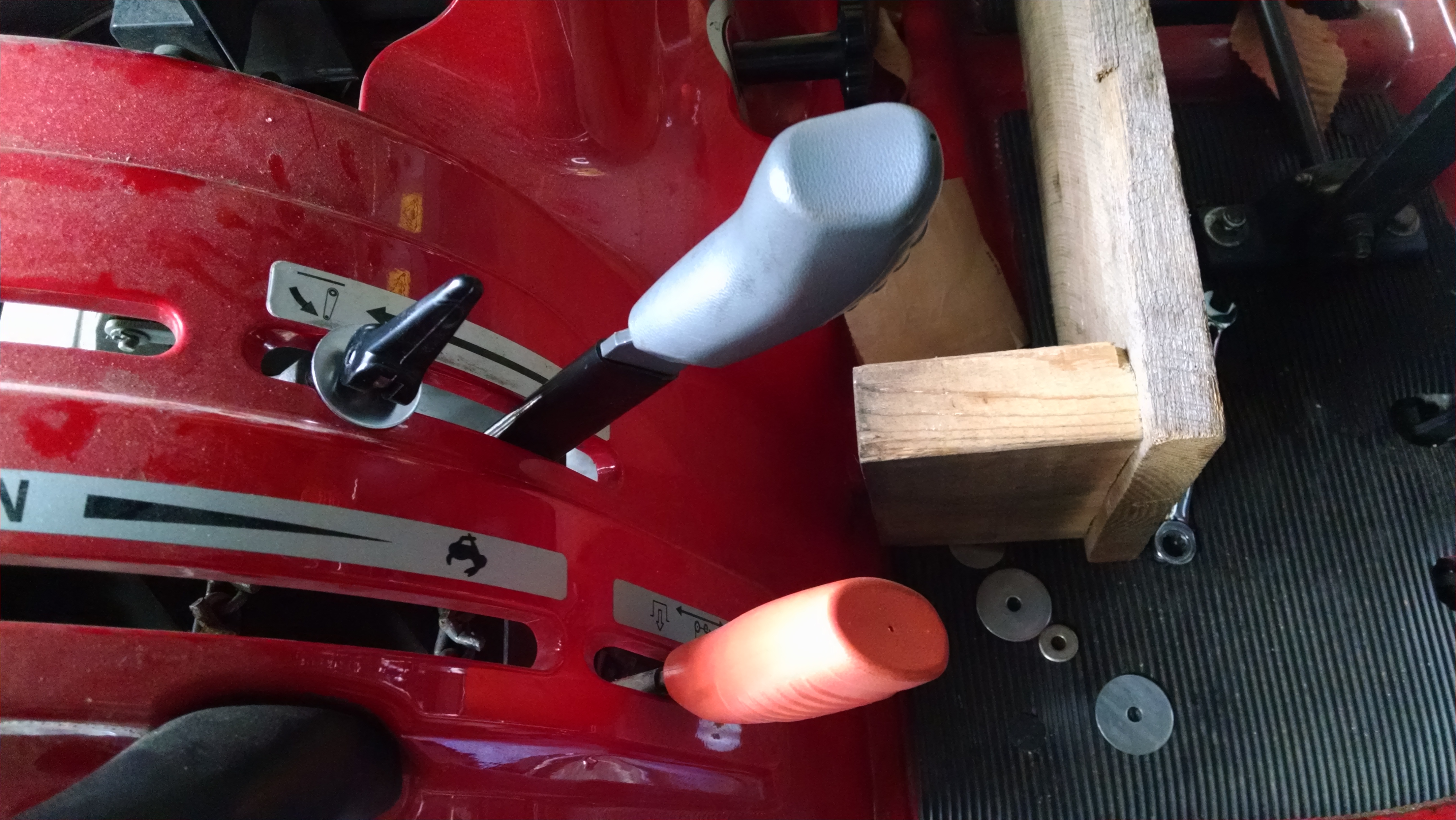

I figured out a way to make the implement float without having a float on my GC1705.. I went to the John Deere dealer and bought a stop (off of a 1025R) and installed it in the slot with the handle that drops and lifts the implement, I had to buy two fender washers at the hardware store.. Now I can drop my blade and the blade will ride along the contours of my driveway..

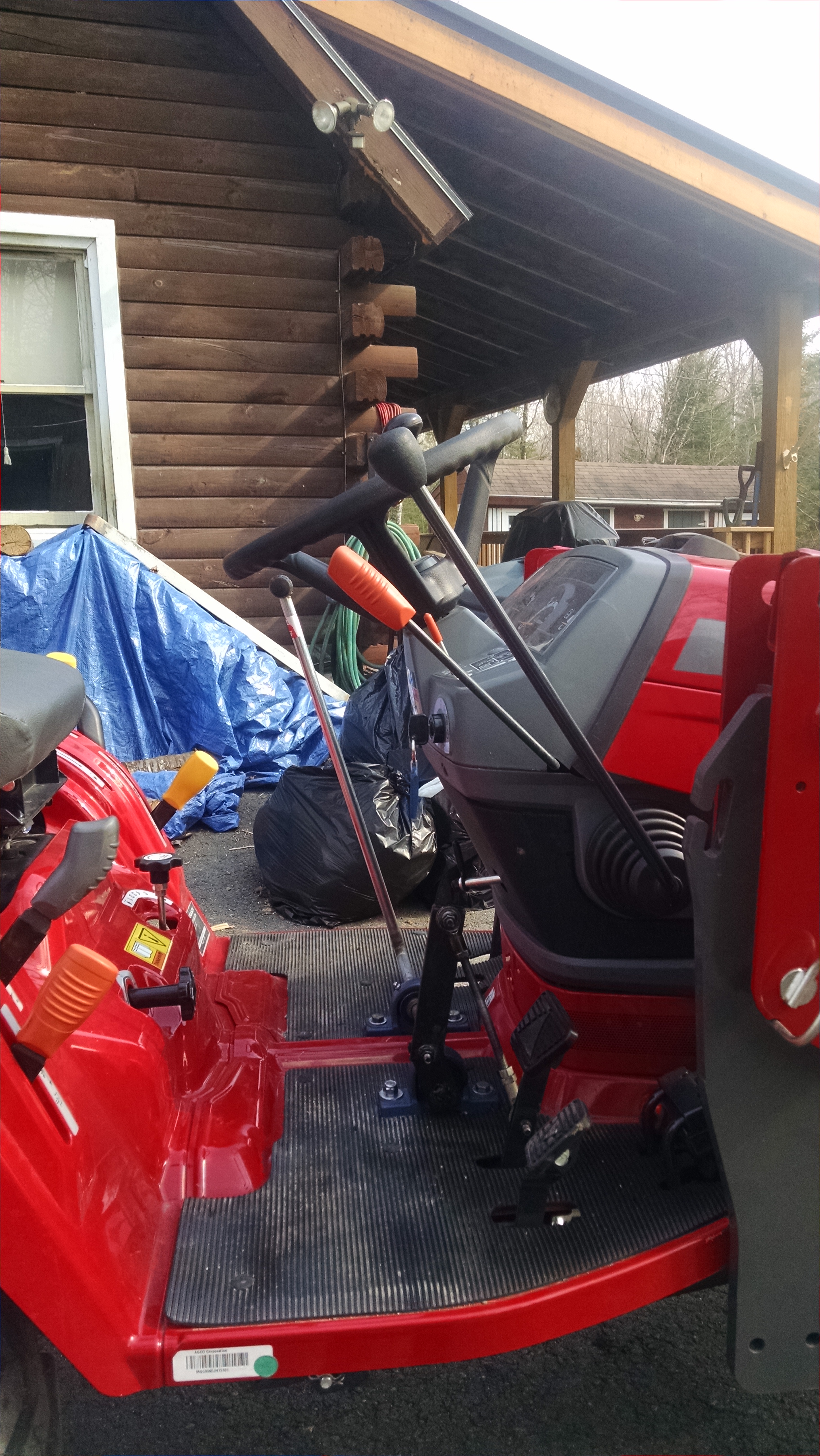

Atsah, what's the rod and bearings for on the floorboard?
   / How does my three point float work GC1705?
#56

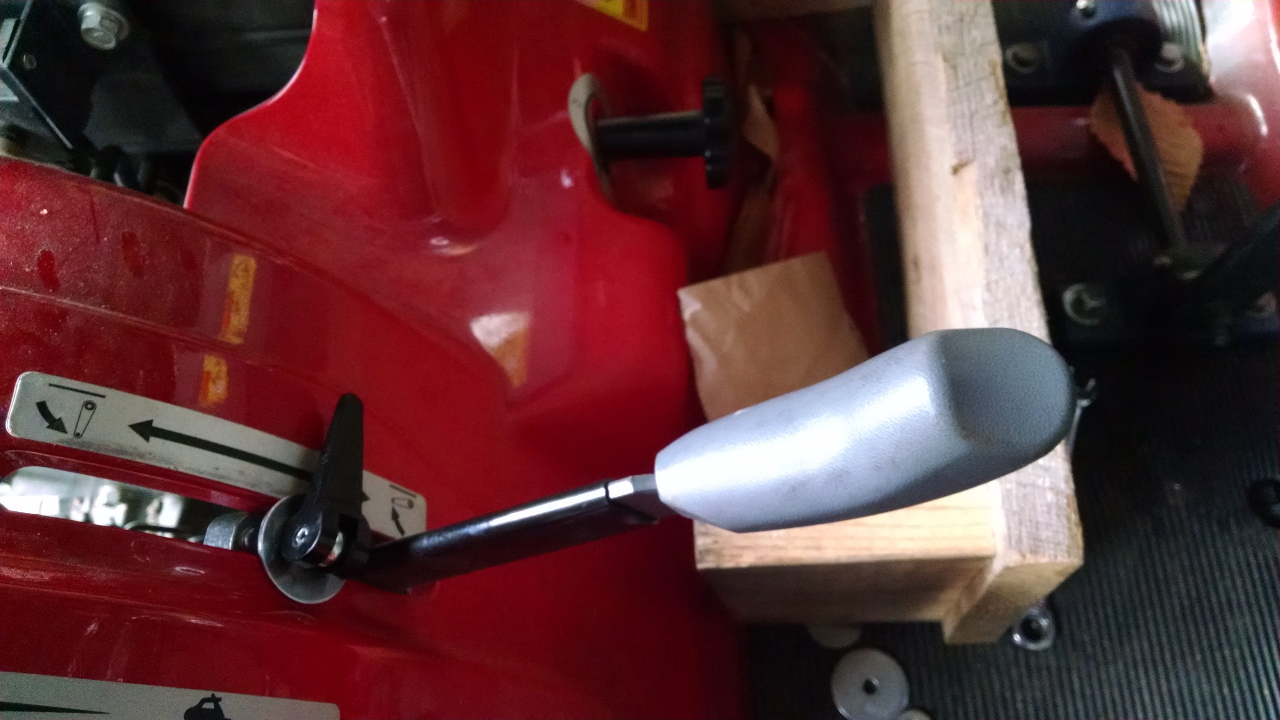

Good observation.. That is my hand control for forward and reverse, I am paralyzed from the waste down and have no use of my legs at all.. I built it and installed it myself, works perfectly..

Pretty ingenious, although I don't see a similar setup for reverse. Set me straight.
#58
Okay so, the forward/reverse is connected on most sub compacts unlike EHYDRO tractors, if you push the forward control the reverse moves in the opposite direction so there is no need to connect to reverse, push forward, you go forward, pull backwards, you go backwards..
