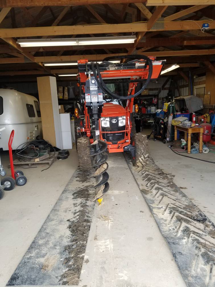

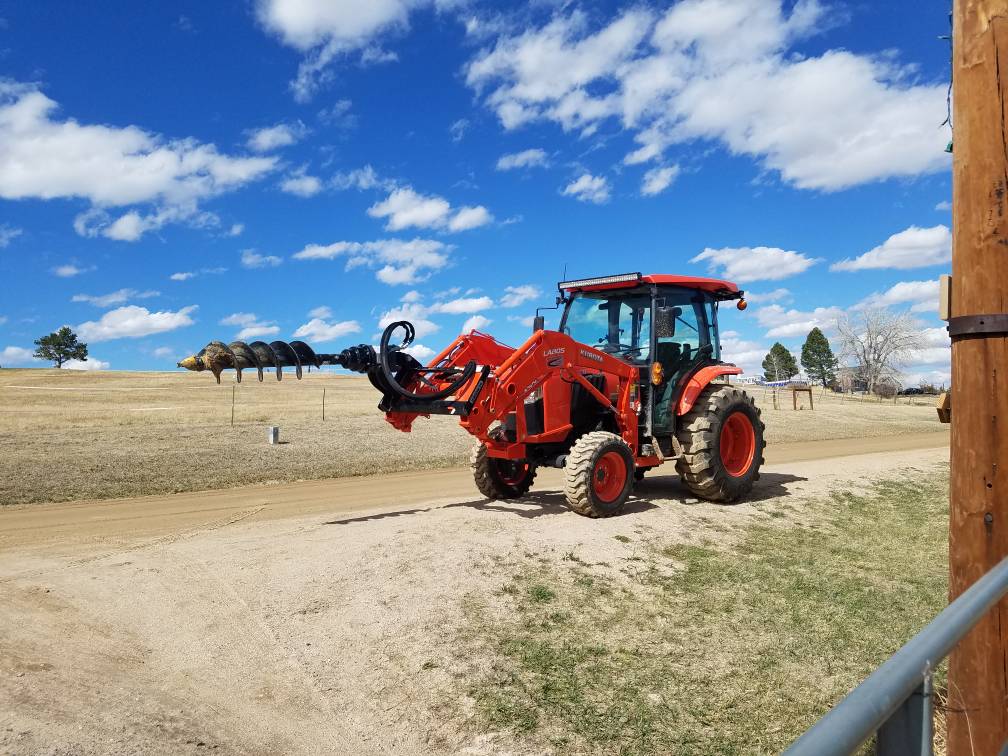

I just got a new SSQA hydraulic post hole digger & did a small job. I could level the auger left to right easily enough, but had to rely on somebody else to spot front to back level. I had pretty much the same issues with my 3pt PHD.
I've thought about trying to attach a level, but it would be to far away & in the wrong plane to see well. Making some kind of hanging plumb bob mechinism might work, but would have the same wrong plane for good visibility issues. Not to mention bounce around a lot when moving & take a while to settle down if it didn't hit anything & break.
I can see how a skid steer would be better by a lot for visibility than a tractor. The offset mount helps a lot but it's still a ways up.

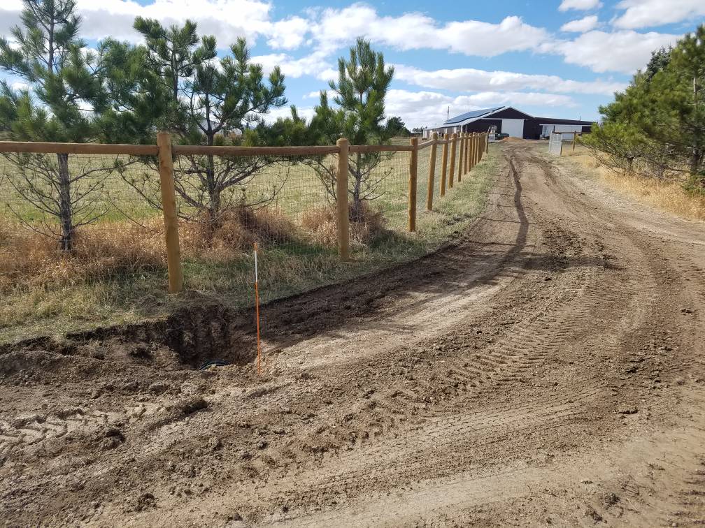

For my personal project I upgraded from a 9" to a 12" auger for similar reasons... needed sub inch accuracy for the mortise & tennon top rails. I also was digging the next hole why my crew was finishing tamping the last one, so had a spotter to help. My Quick Hitch compatible 3pt auger was really bad about it's travel arc, so I had a lot of inching forward.
My new hydraulic doesn't seem to be as bad about travel arc. But the guy I was doing the job for was giving me a fair bit of move forward/back signals. Not a problem & didn't slow us down as I have a HST. But I really couldn't see front to back angles on that auger because I was looking straight on.
Part of the issue was likely him trying to push the auger over the X (never let him get near it when spinning) before I dropped it. But I did have some minor issues with just letting gravity do it's thing to keep it level as I dropped it to the ground.
I agree a bigger auger can hide the flaws a bit. But I should at least try my best to get the holes straight as possible. Looking for tools or techniques short of getting off the tractor to look from the side every time going forward when I have no spotter.
My personal fencing that I had to get the spacing perfect on...

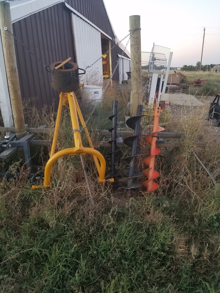

I rebuilt my 3pt PHD to fit on a quick hitch. It required a hydraulic toplink to work, but resulted in down pressure enough to lift the back of the tractor for the first foot & a half of the hole. I also had 200lbs of ballast over the gearbox.

Offset mounting up front is decent visibility. Certainly no worse than on the 3pt. But you don't kill your neck turning around looking at the auger. Center mount would hide behind the hood & suck. I could see the point on the auger to place it just right & run things with only a little gangster lean to the right in the seat.

I never corkscrewed an auger on the 3pt, but got close a few times, despite being cautious. I'll love the reverse function if I ever do it on the hydraulic. I needed an adapter for 2" hex from 2" round ($200). But a friend who was borrowing my good 12" 2" round auger just bought the auger off of me for what I had into it & I threw in $20 in spare teeth. The 12" 2" hex auger was $25 more, but is noticeably beefier in the connector & other places.

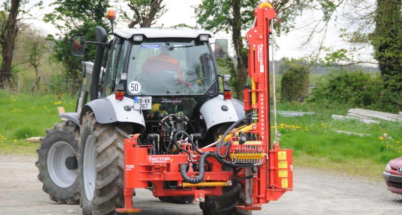

jenkinsph... you might see about renting a Post Driver. It will save you a HUGE amount of difficulty. For 1200 posts... no tamping. In and they are done.
