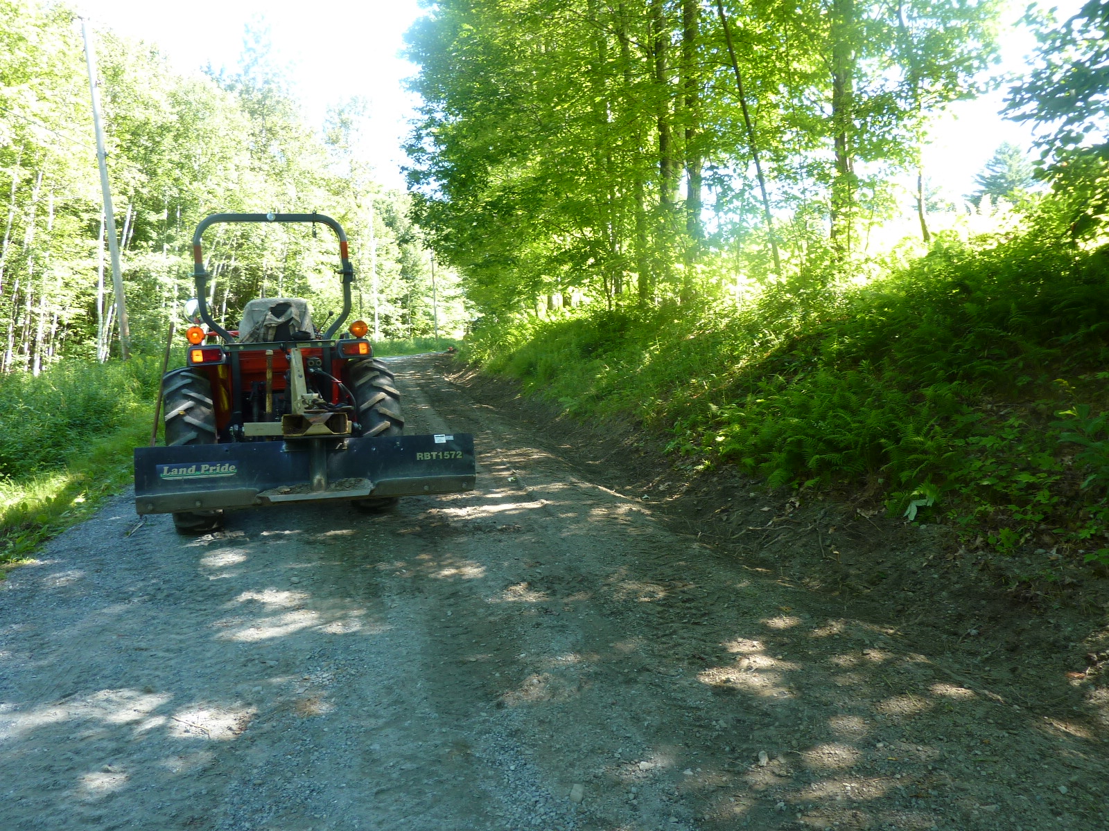

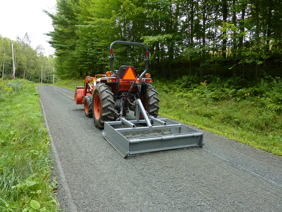

Every road is different and you have to make compromises sometimes. I put in a ditch similar to what you need. I used a offsetable blade and the tire was right in the ditch. A lot of water comes of the hay field on the high side where the ditch is. The road slopes down hill and lower down the ditch depth and width gets restricted because of some ledge. So I decided to minimize the water in the high side ditch to that coming off the field by grading the road with a flat pitch to the low side rather than a crown in this section. In my case I do not find that the flat pitch section needs any more maintenance than the crowned sections. In either case you have to keep the water from channeling down two wheel tracks. The water does have to travel further across on the flat pitch but unless the road is very steep it is not a problem. I also put in a broad based dip to insure to much water flow did not accumulate running across and down the road. The grading picture is several years after the ditch was cut.

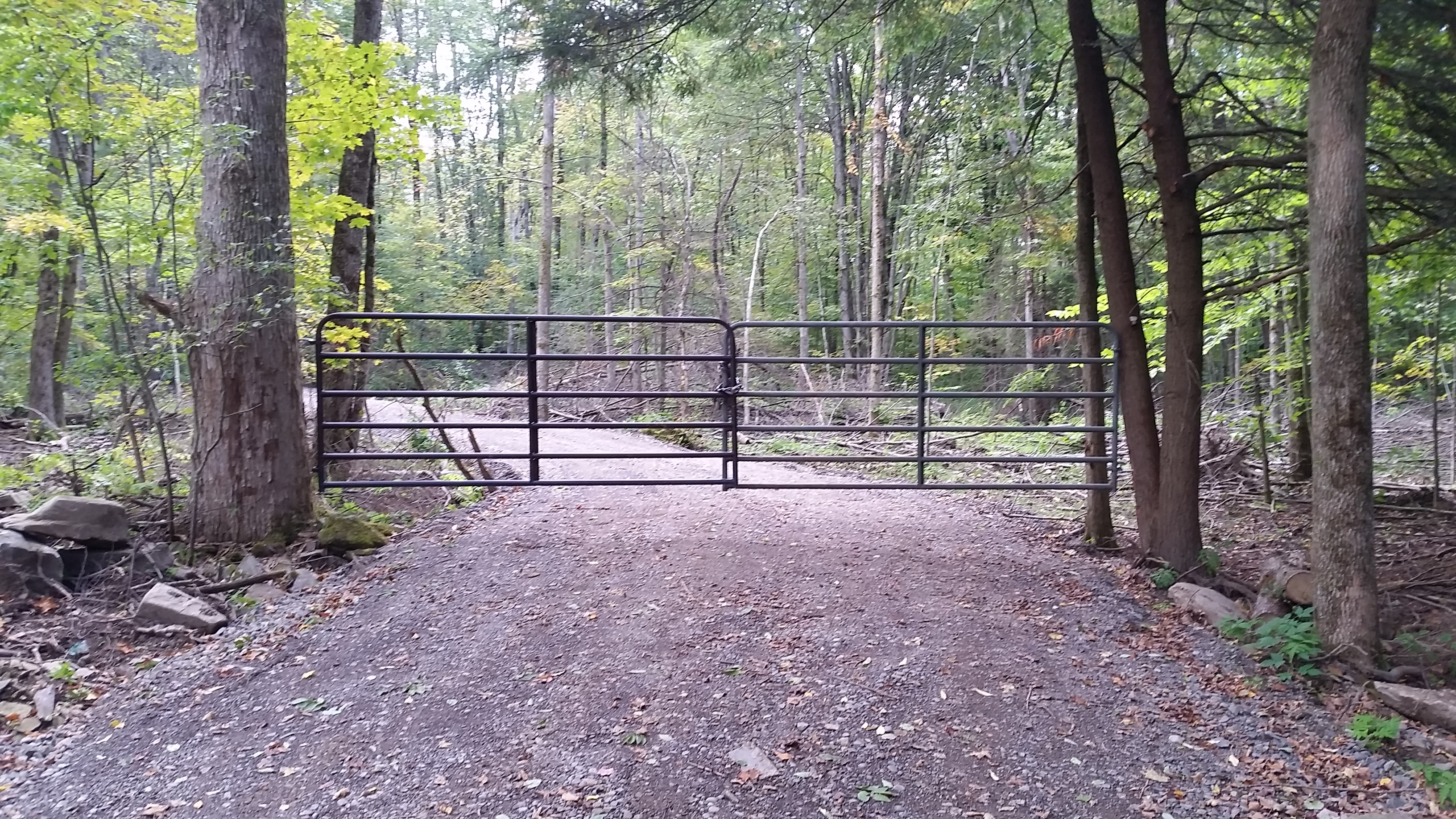

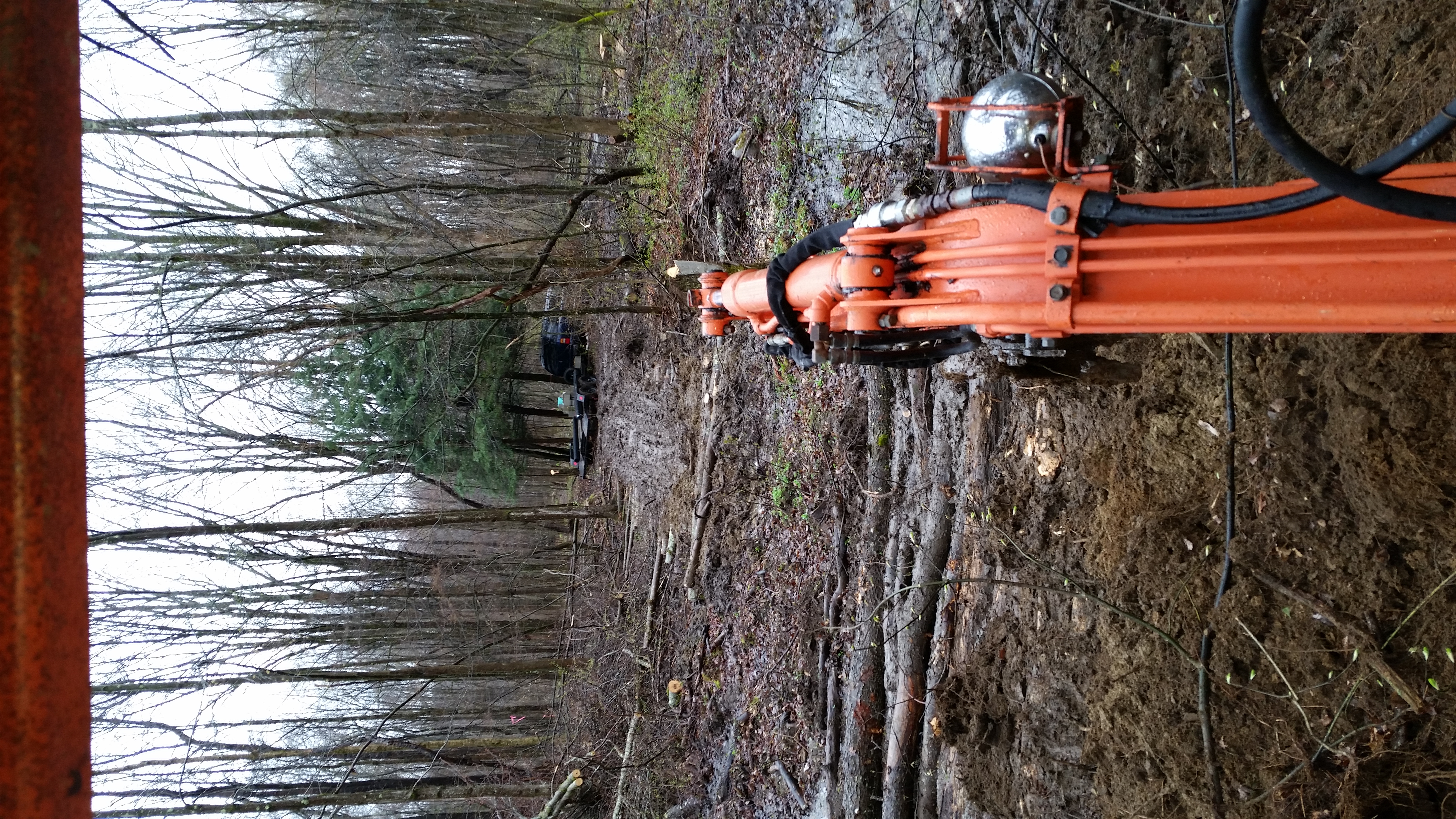

They can be a one trick pony. Depends how you use them and what most of your needs are. I find moving logs easier with my mini than tractor with forks. I have also gone places no wheeled machine could. This year I built a rock solid driveway through a swamp. I was forced to use logs to even get the machine across. Having a 360* swing really helps when digging ditches in tight spots or else your moving the machine alot.
Second pic is the final product. A well packed crowned driveway with ditches on both sides and a culvert in one area. I pushed 80yrds of stone with just the blade that I had made side wings on. It acts like a box blade.
