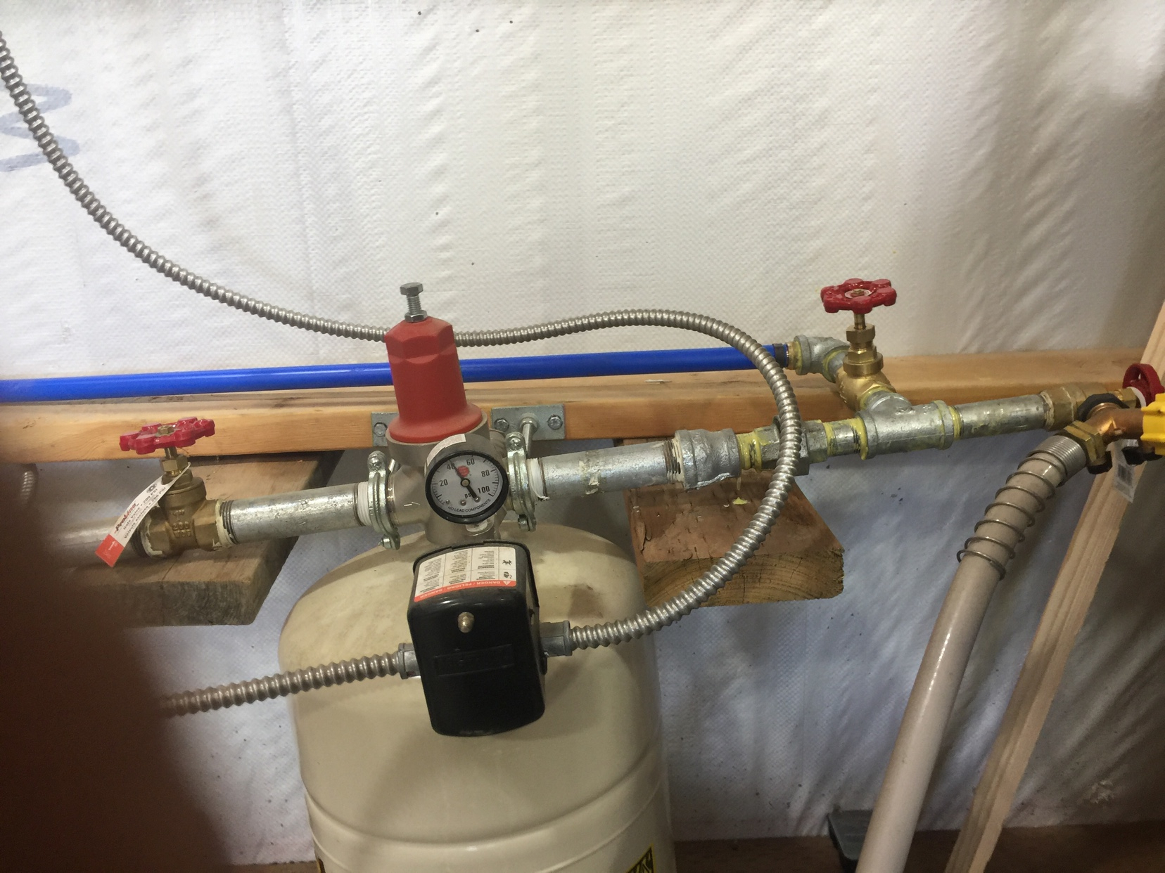

The Cycle Stop Valve I installed on my system was just before the the pressure tank in my basement. There was no need to pull the pump and it was pretty easy to install. The valves work by adding back pressure to your pump at a pressure you set so the pressure can't reach the upper limit of the pressure switch. This keeps your pump running while your water is flowing. Well pumps are centrifugal pumps so there is no problem with the back pressure. Makes your shower experience better as the water pressure stays constant. Once you shut off flow the valve stops performing and the pump can continue on to the upper cut off pressure and shut the pump off.

I installed mine in my shop some 150’ from the well.
