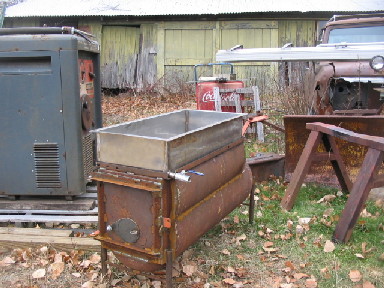

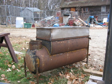

i wanted to make a little maple sugar this coming spring but didnt need anything too big, just a touch bigger than the way we did it when i was a kid, a campstove and a pan, so i set out to make a small wood fired evaporator for next to nothing using stuff i had around, the body of it is a propane tank that i plasma cut so that i could open the top and bend the pieces up to get more height, and then made a door on the front and added a thimble of 6 inch well pipe to the back for the stovepipe. for the stainless pan i took the door off of an old restraunt type refrigerator and flattened out the sheet then laid it out and cut it with a the angle grinder and a zip wheel. i then clamped it down to a length of heavy channel iron and with a deadblow hammer worked back and forth and formed the bends, then welded the corners with my mig welder and stainless wire

and here is one more view with the pan taken off. its not a big evaporator by any means but it was all outa free materials and definatly should be much more productive than the campstove method. the pan has a capacity of just under 12 gallons and has no baffles since i will just use it as a batch evaporator

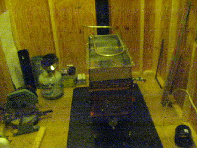

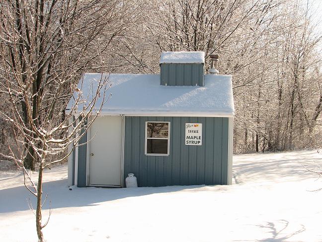

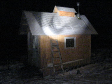

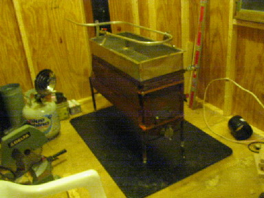

heres a few more pics of it now installed in my sugarshack i built for it, funny how these projects escalate! i will get some better pics of the shack in the daylight, it was nightime so the one pic is kinda dark. the shack is 7ft by 11ft inside.

/ homemade maple sugar evaporator with pics #14
looks like a nice shack! I am thinking of moving my big pan down to the creek/woods but without a shack that means not being able to duck inside to warm up as it is now I HAUL the sap in 5 gal pails up to the house the large wood fired pan sets outside on a cement block burn pit, it is about 2.5 blocks high. (one solid 4" blocks on the very top with a few of the blocks turned so split wood can be slid into the fire under the pan through the block openings. this is also fire breathing room. I have also pulled 1~2 blocks from one side (upwind side) to load wood under it. I didn't notice the wood loading on you're propane tank ? is there a door to load wood into it??

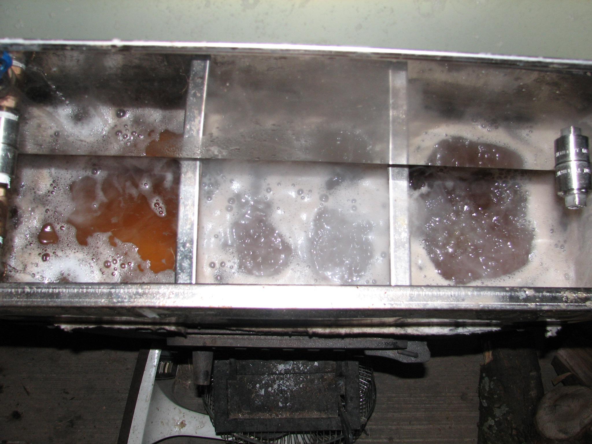

So far our hobby has only cost us a new sugar shack, small evaporator which we have outgrown, 80 taps, storage tanks, sap buckets, bottles, not sleeping many nights. (remember it only takes around 40 gallons of boiled down sap to make 1 gallon of pure syrup). But man what a fun spring time hobby. We sell a little bit each year to friends and neighbors to get a little out of it but what a fun way to spend time with the kids as you can see the fun we have We have four daughters ages 9, 6,6, and 3 and I can't think of a better way to spend a day than outside in the spring collecting boiling and just doing something not many people have the patient痴 for anymore. Their is not a fast instant way when it comes to maple syrup. I have a lot of friends who ask if the syrup comes out of the tree and are shocked when I give them the syrup lesson. It is a great hobby and also another excuse to get on the tractor of course. We have a blast with it every year. You can see some our pics of our fun hobby.

there is a door on the front like a woodstove that is for loading the fire, theres a air damper in the door and also a pipe with holes in it that runs about halfway back the firebox to feed air to the fire also, thats what the second small air damper is below the door

well i did a few more little things to the evaporator like adding two baffles to the pan like the real evaporators have. i fired it up to try it for the first time yesterday, filled the pan with water and got a fire going, it worked pretty good but the one thing i noticed was the rear of the pan always had more boiling than the front, and the fire was mostly build at the front, it seemed better with the draft cut back but seemed that whatever i did the back would boil like crazy and the front just barely. any thoughts, i was thinking maybe its not as bad as i think since the back is where the fresh cold sap will be added so maybe that sorta counteracts this? or is there other tricks that i dont know?

MarkCt
My evaporator has fire brick across the back about 4-6 inches from the flu with about three inch clearance to the bottom of the pan. This seems to "slow the heat down" as it vents to the stack. Also if you can line the stove with fire brick that will hold the heat in a little more evenly thus you may see a little more even boil
