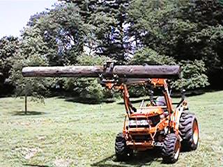

homemade grapple

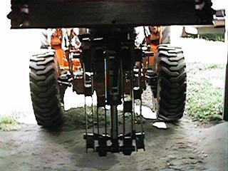

more. I wish i could figure out how to put more images on one page

Ekim, nice looking equipmnet. How well does it work. do you have a picture working....
   / homemade grapple #4
Ditto that... Looks like you put a good deal of work into building it. How well does it work?

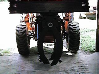

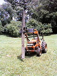

Thanks guys; it works pretty much as i hoped(surprisingly).The loader will lift 1000lbs with the bucket so i figure its alittle less with the grapple because it weighs alittle more. Ive picked up a 10'x12" telephone pole no problem, actually had some already installed 4' in the ground that i wanted moved. Just drove over grabbed it and lifted it straight out of the ground.Ill try and post some picts of me picking one up.Idesigned it so i can hydraulically rotate it but right now i just pull a pin and turn it by hand.It will fit on any loader with the same spacing as the LA481.Also designed it so i can use a different bracket and mount it on the 3ph to possibally(sp) skid some small logs/trees .Posted other picts in the attachments forum but here`s another.

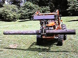

more picts of grapple in use . ill pick up and transport with poles horizontal then pull pin and rotate to put in holes vertical
