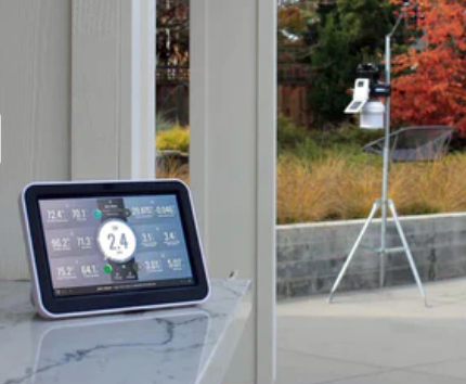

Davis Vantage Pro 2 is what I suggest like others here I have had mine well over 15 years now. If you shop the web you can get them below MSRP.

+1 on the Davis Vantage Pro 2. I've had mine for almost 35 years now, with very little trouble.
There are wired and wireless units available and both come with a fully customizable color display

@kawaiiitakko While you can buy less expensive stations, I'd buy my Vantage Pro 2 again in a heartbeat. The Davis systems were developed here for commercial use in farms in California, and the ruggedness and reliability shows. The strength and reliability of the radio link is, I think, impressive.
Regardless of the brand you end up buying, I think that choosing a good location will improve the quality of your measurements. E.g. on an open area on grass, with the anemometer up to 30', if you can manage it.
