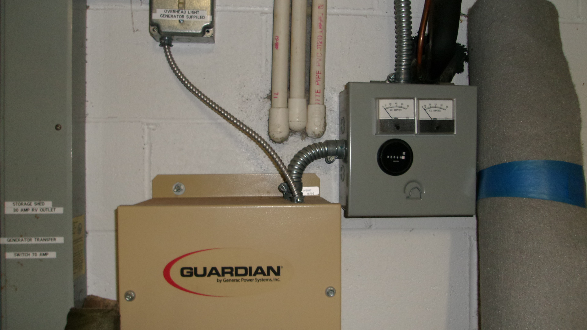

there is no cheap way haha. i have a program from generac to calc generator loads. its part of my powerplay software. i use it when i size my jobs.
If theres elect heaters...theres always problems. When i get houses with electric backup heaters and or electric water boilers, i always need to shed those loads....unless i go big.
i reciently hooked up a 45KW unit on a house with electric heat, elect backup heat, elect water heaters and heat pumps. took some doing. It works great though. On this application, he had 2 x 200 amp panels so i installed 2 x 200 amp transfer switches and joined the feeds together in 16x16 J box with single 200 amp feed to generator.
care has to be taken to link both switches EXACTLY the same. i use color coded wires .... it gets confusing at times.
Very nice job. I sure wish you were closer to me. I would like to get your thoughts on my set up!
