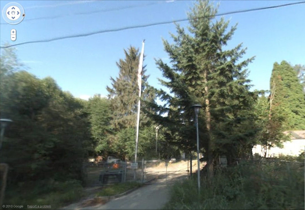

Here's the entrance to our property and our flagpole just inside the gate. 42 feet made from recycled aluminum street light poles with an 8x12 flag.
Image courtesy of google maps.

Not really. This was made from 3 old poles which I had sleeved and assembled to make the current pole. I used to work building Traffic Signals & Street Light Systems and as foreman, it was my responsibility to get rid of the old stuff we removed. I always had things laying around the ranch. I used one of the three companies here in Washington certified to make repairs & modifications to signal & lighting poles so that I was comfortable with the structural integrety of the pole. I also used one of the trucks from work to auger a 4 foot diameter 9 foot deep foundation for the pole and standard street light bolts poared into the foundation for attachment. It's sort of a one-of-a-kind. The top twelve feet was made from the same kind of pole which sits on either side of the drive. These have a 3" top which fits standard pole hardware perfectly and the lanyard runs down the inside of the pole.
Unfortunately, my flag deteriorated enought I had to remove it last year and I haven't had the $300+ needed to replace it yet so it hangs empty right now.
