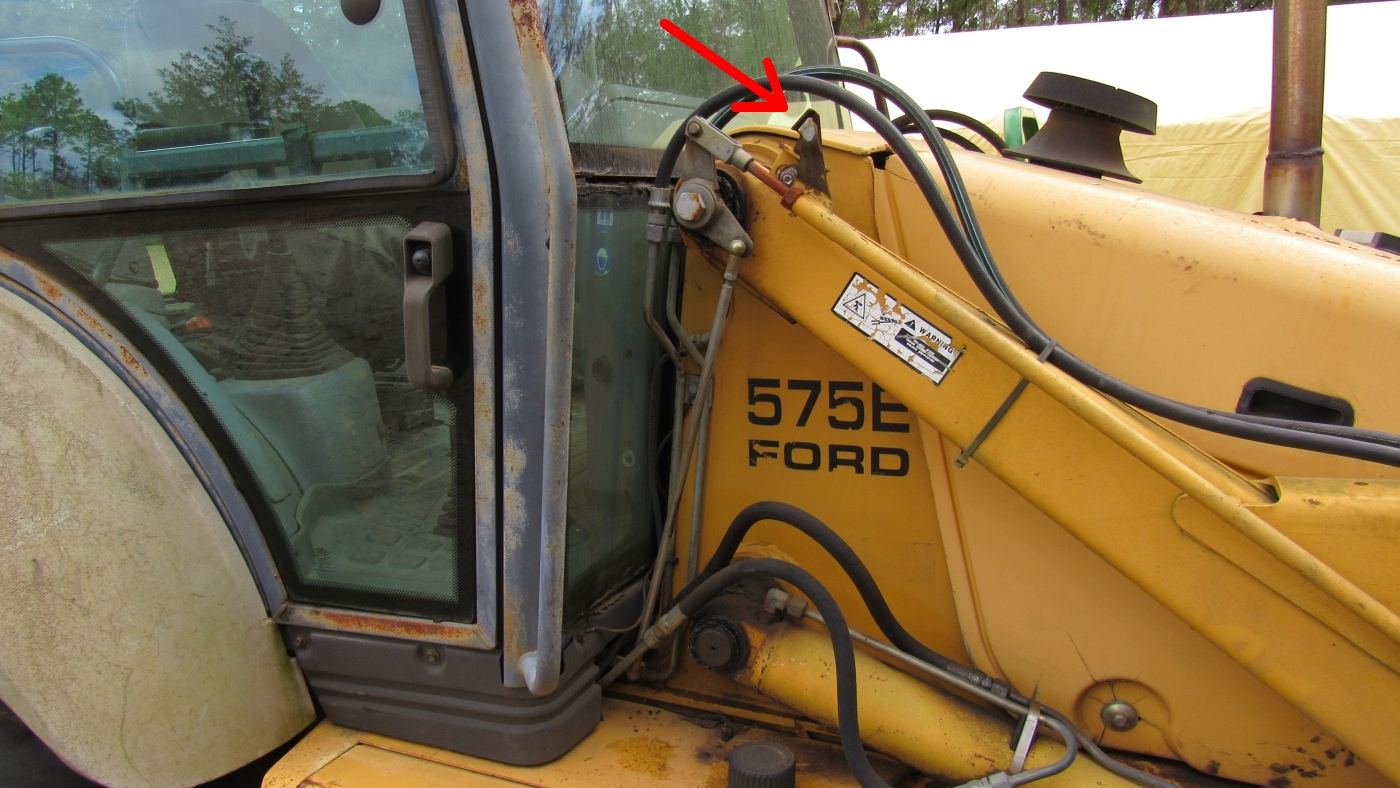

The bucket level indicator on my backhoe has a tab on the rod and an adjustable tab in a slot. You set the tabs so they are aligned when the bucket is flat on the ground. The linkage going under the cab controls the hydraulic self leveling system.

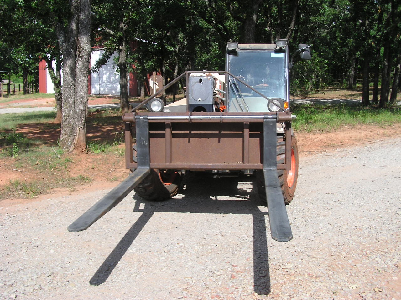

My compact telehandler uses a gravity pointer for boom angle also:
But does it indicate when bucket (or forks) are parallel to ground?
Dale
No, it just indicates boom angle relative to the center of the earth.
I use the top of the bucket to know what angle the bottom is at:
And can see the bottom of the forks from the seat:
