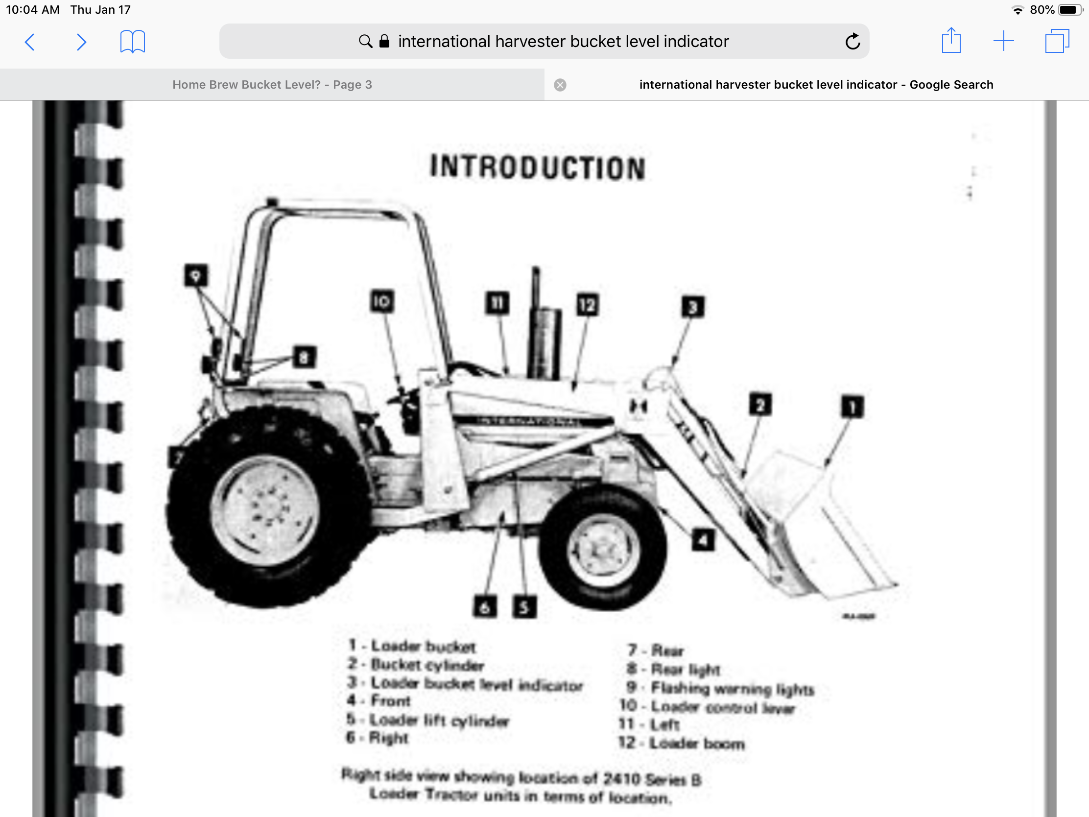

I had a bucket level indicator on our old IH2500b. There was a half-round piece of metal with indicator marks on a pivot hanging on the side of the FEL arm at the bend. There was a pointer for the marks fixed to the arm. There was a rod connected to one edge of the round piece and the other end was on the bucket bracket above where the right dump/curl cylinder attached, so the rod was parallel to the arm.
When you'd dump/curl the bucket, the rod would make the disk rotate on the pivot, and the marks would move behind the pointer. It was pretty handy.

HA! For kicks I googled it and found a grainy image from an IH manual that shows one on a different model, but it's the same thing. Item #3 in the picture.

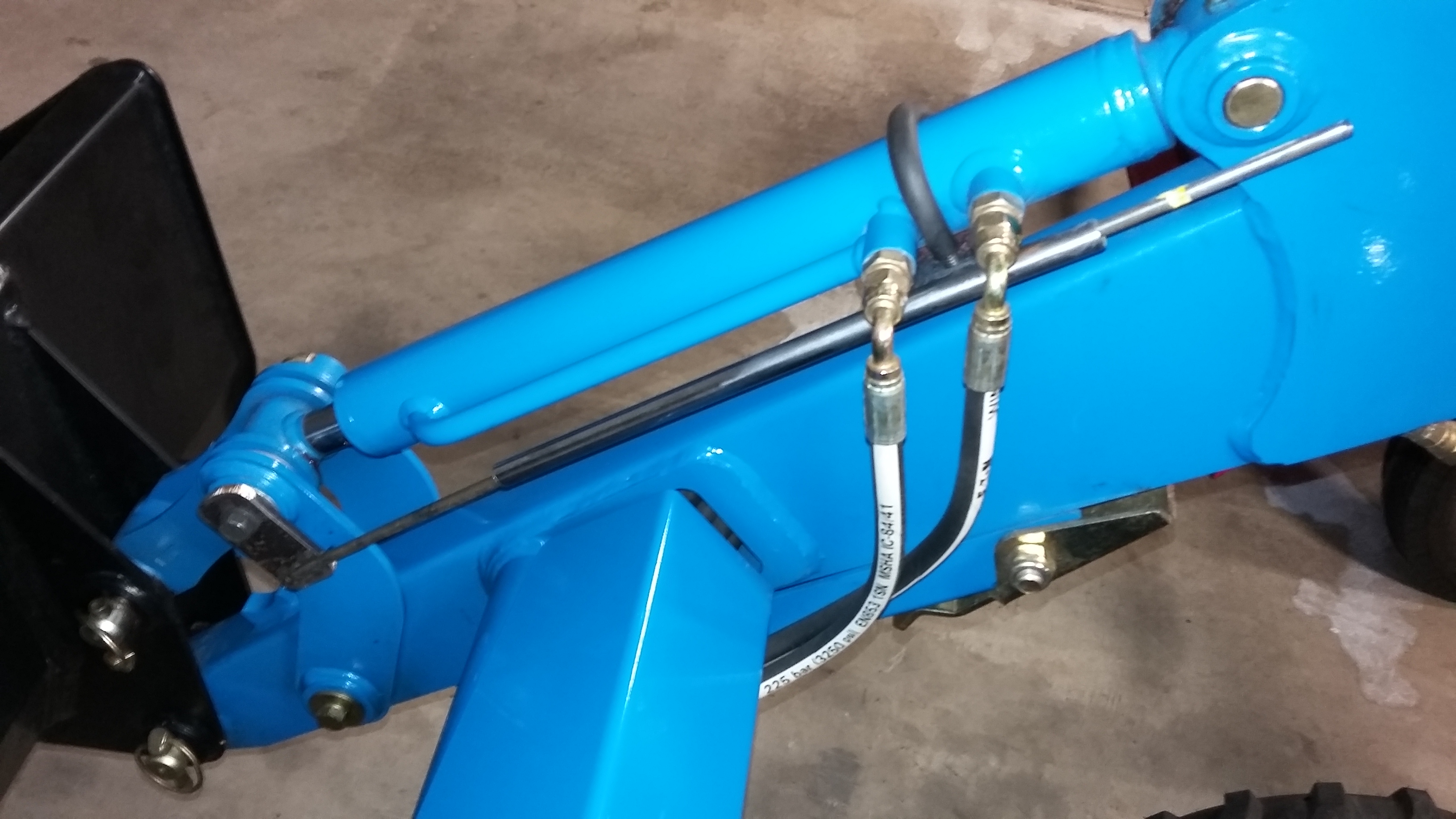

I have the tube with rod. I have thought about cutting a slot into the tube so that I could see the end of the rod. For the hay spear to be level, the rod is below the end of the tube. However, after loading, moving and unloading 90 rolls of hay, I think I will wait. After the first 20 rolls, I never looked at the rod.

The ability to level the "bucket" with the loader raised above ground level should be handy when using forks particularly when loading or unloading from a truck or trailer bed.
