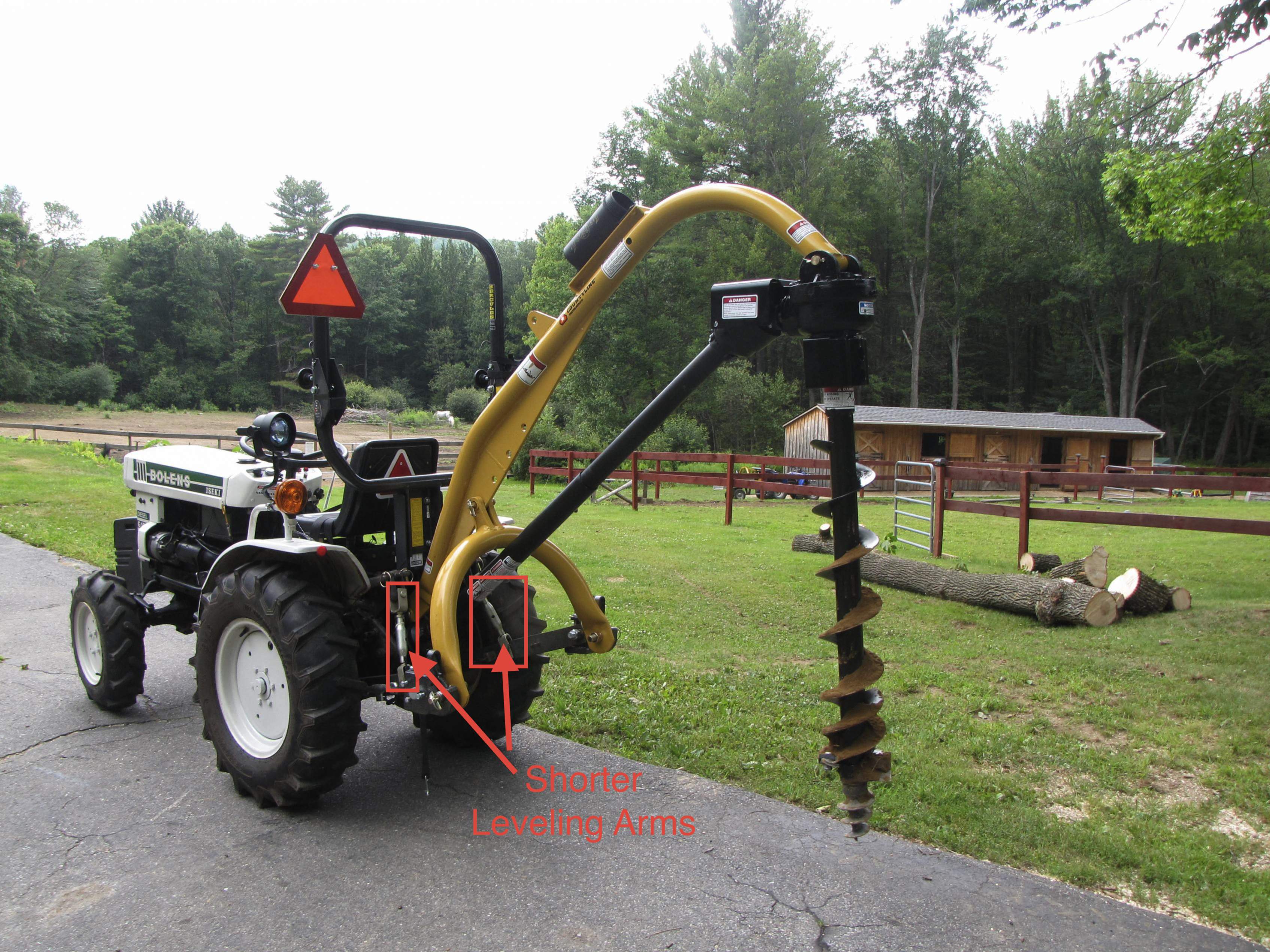

basic question folks - what factors will affect the height my Iseki TX1510 will lift my Rotavator off the ground ?
Looking at various Youtube videos the rotavators all seem to be much higher off the ground than mine
I have tried changing the 'length' of the existing centre part of the hitch - would a new shorter one make any difference?
I'm assuming the hydraulics are working okay - does the weight of the attachment have any effect my Rotavator is a 4 foot
King Cutter
Any help greatly appreciated thanks

Hi, Welcome to the forum! I know it seems rather evident but........did you check to see if the lift lever stops are adjusted all the way to the end? I believe they are movable on your tractor and when you adjust them it will stop the lift at various heights depending on where its set. Just a thought! :)

Hi,
I had the same issue with my dirt scoop. The solution that I had, that has worked great was replacing the leveling arms with much shorter leveling arms. I bought mine at Tractor Supply Company in the US, and I know that they will ship, but if you don't want to ship them across the pond, they are 263mm when closed between the two attachment points. I looked on eBay in the UK, and I did not see any this size, but I am sure that you can find them, possibly at Yenibiz? I hope that this helps a bit. It made all the difference in the world with mine. I can now lift my implements 2/3 higher. Let us know how it goes!
This are the leveling arms that I purchased: Adjustable Leveling Arm - 2600000 | Tractor Supply Company

Thanks Kevin the upper stop is pretty close to the limit but may be worth a go
   / Hitch Lift Height for Rotavator
Thanks once again Mitch will have a look around at sites over here Interesting also you've both sides adjustable only one is on the hitch that came with the Tractor....
