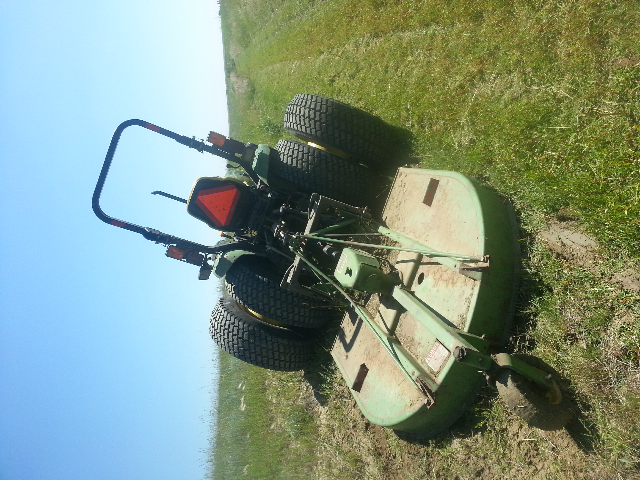

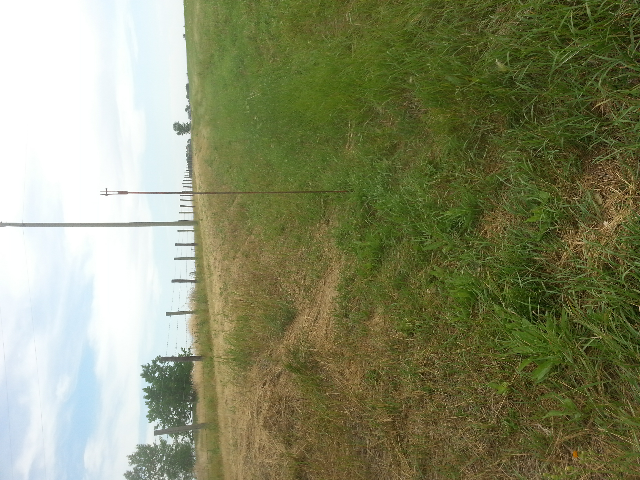

I just wanted people to see what can be mowed if your tractor has the traction and stability. The first picture gives an idea of what an approx 50 - 55 degree slope looks like. The other two pictures are at a different location with less slope. And I have no idea how to get the pictures right side up Grrrr.

Are those duals an aftermarket option from Deere or another aftermarket company? Does deere recommend duals on that size machine? I'm fairly certain Kubota does not, but they would be extremely useful in situations just like you have pictured. I can think of a few places around my place where duals on the 5240 would make it feel much more stable.

The duals are not an aftermarket option from Deere or anybody else for that matter. I was given an opportunity two years ago to mow approximately 10 miles of irrigation ditch for the local irrigation district. I wanted to do the job because it was good money and I could save them money over using their own equipment. So I bought a matching set of tires on ebay and made my own duals. I seriously doubt that John Deere would recommend duals on my tractor but I can't say for sure as I never asked them. I looked at the job I had to do and the weight that I planned on carrying and the diameter of the axles and said I can make this work. I believe recommended tire pressure is around 16 lbs. I run at about 10 on the insides and 8 on the outsides just so that there is some give somewhere. If you want I can post pictures of what I did along with an explanation and what I would change if I was to do it again. Also the front tires aren't a John Deere option either. The tractor came with 27x8.50x15 tires. I bought rims from John Deere and made them an inch wider and installed 26x12x12 tires.
