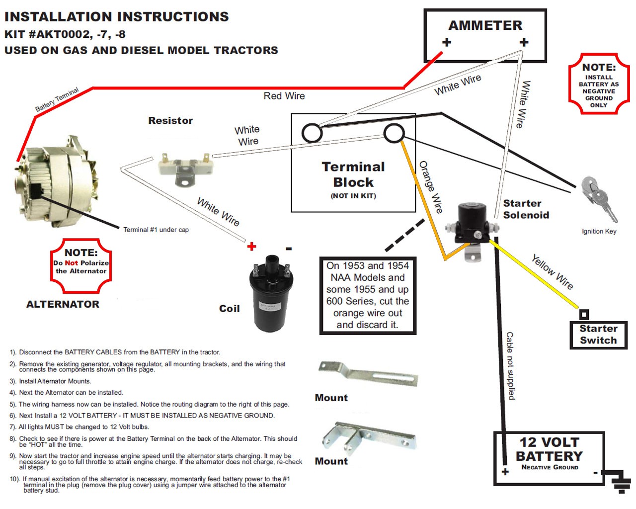

Generators produce power, you don't supply power to them ( from my VW experience ) not sure how they work on a tractor but I converted my VW to an alternator and eliminated the regulator all together, maybe do the same if its possible? That would make it a single wire to the battery (+) to keep it fully charged.

12 volt and generator dont belong in the same sentance when talking about a 640. If you truly have a 12 volt battery and still have a generator, it will never fully charge unless you have a 12 volt generator from a diesel tractor from the 59 to 64 era. You either need a 6 volt battery, or complete the rest of the 12 volt conversion with an alternator and whatever else may not have been done to do a complete 12 conversion.
