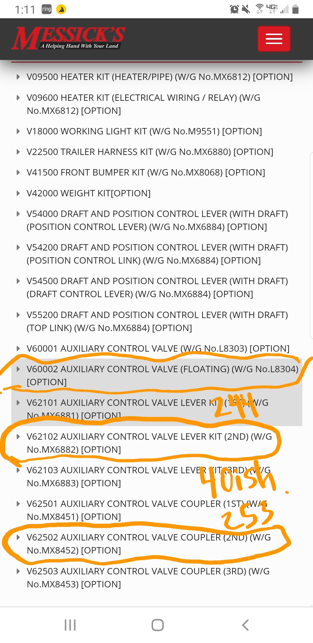

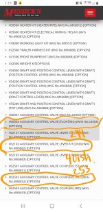

From my research on Messicks incredible website, it looks like all of this will get me were I need to be;
The $40 dollar guess is for the lever. I do not have a quote for that yet.
MX6882
L8304
MX8452

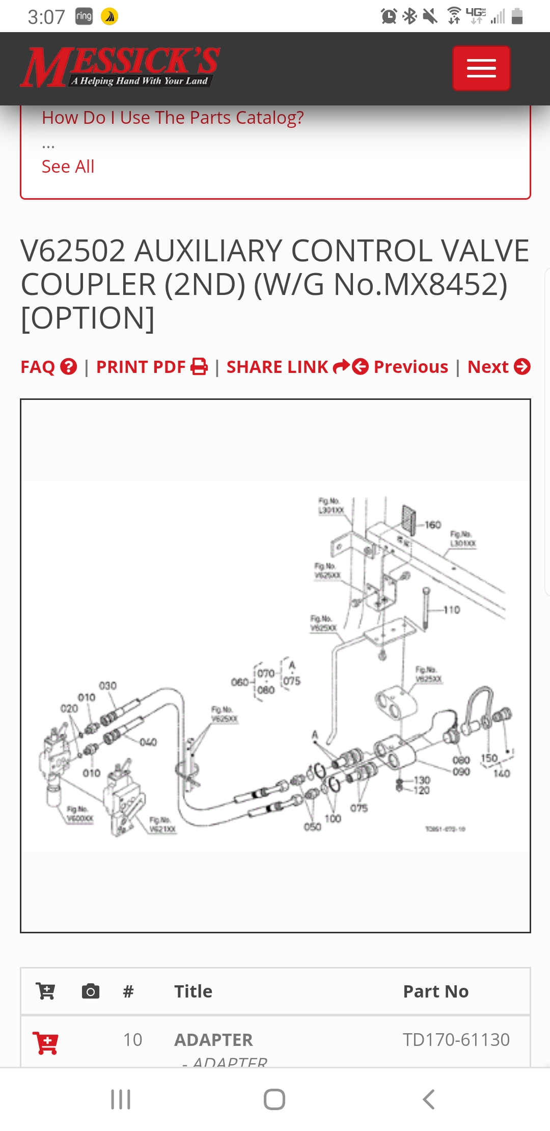

But it is not present on the Messicks pdf:
I wish I knew what w/g meant. And also why the v62502 number?
