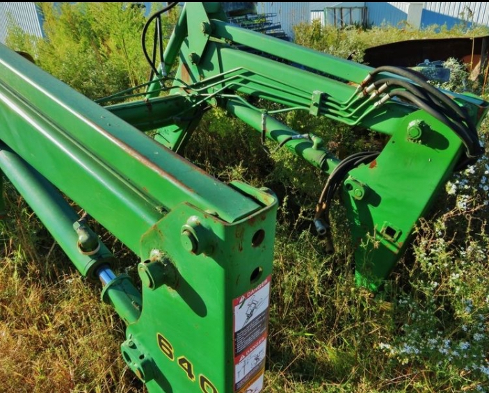

I’m in the same boat. Looking to add a 640 loader to a 6430 Premium I just bought.
I see Shortline has a kit, but I thought I’d check to see if you ever got yours set up?
