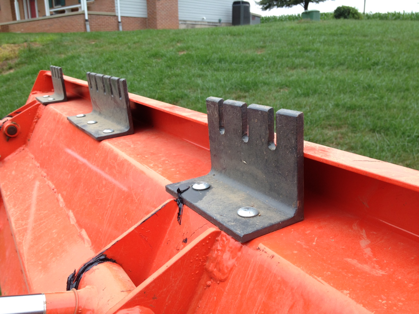

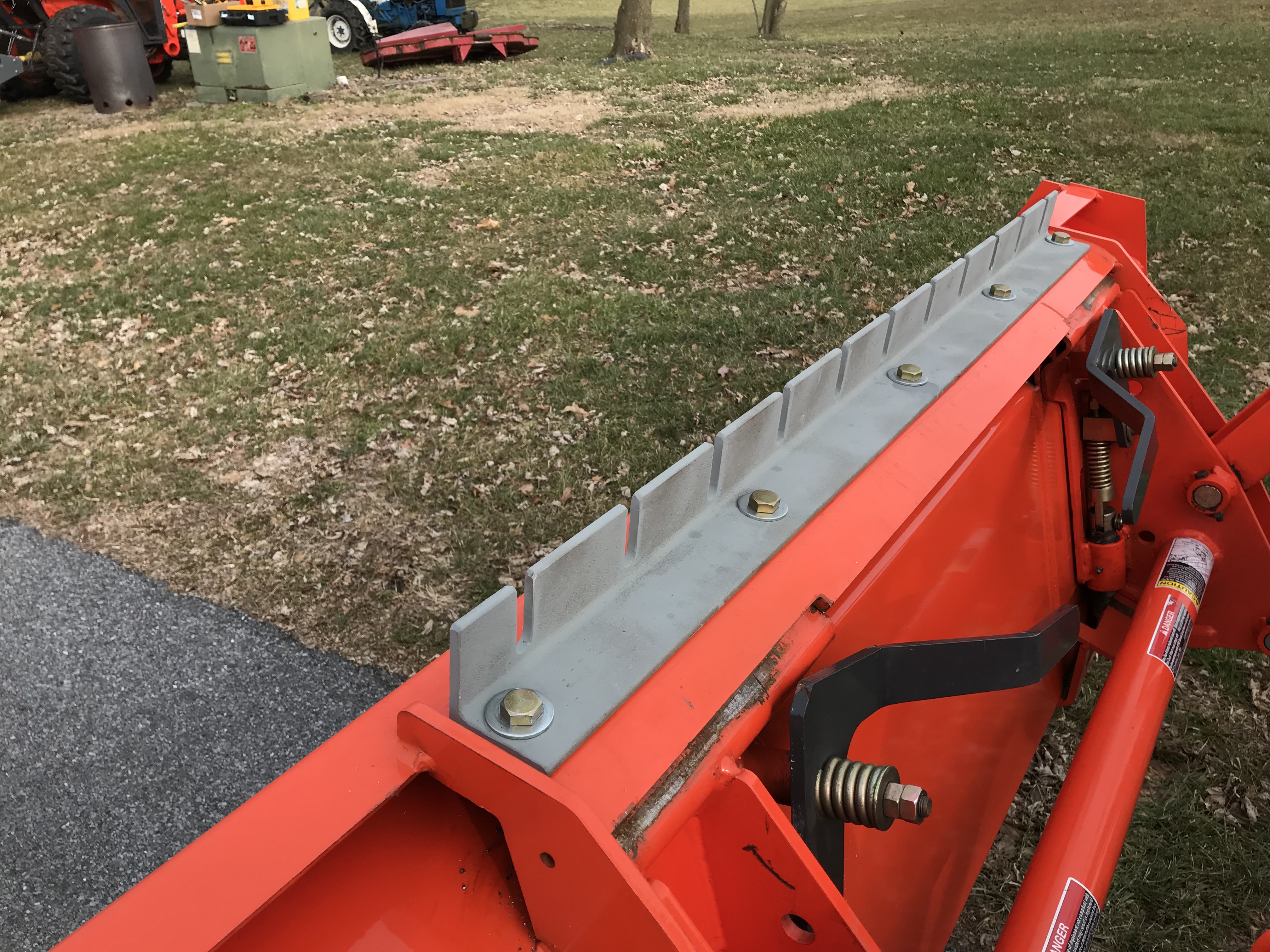

Here are a couple of the most recent ones. These are on the L4240 that Santa brought. The metal they're mounted on had sufficient thickness for me to tap to 1/2-13 instead of using nuts on the bottom side.
