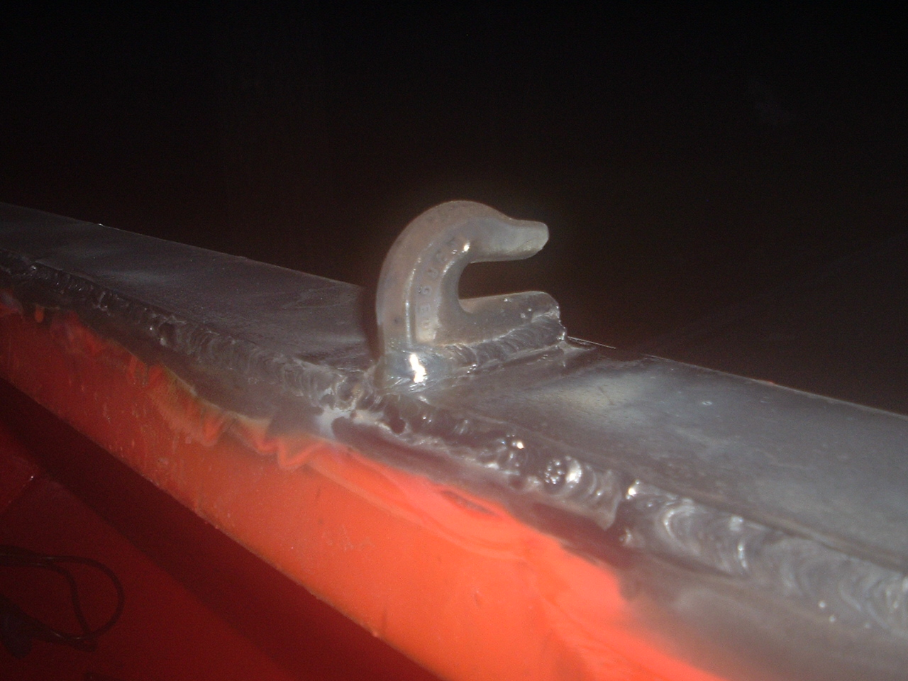

I recommend Ken's Bolt On Hooks, here is my setup.
I like the weld on style myself.
Even if I got bolt ons, I'd weld them as well as bolting. These were what I used... They have a nice bevel along the sides to get a nice thick bead in. I think having the weld fully surrounding the hooks adds a lot of rigidity to the bucket top. I would worry more about knocking/bending them off sideways on something more than bolt ons, but I worry less about loosing the flatness of the top edge of the bucket when pulling or lifting straight (which is how I use them). I wouldn't pull to the side due to the strain on the loader arms, so the sideways strength of bolt ons wasn't that appealing to me. Bolt ons could use the bolts as a lever and bend the front edge of the bucket down if overworking them.
   / Has anyone tried welding chain hooks onto a piranha tooth bar? #15
I like the weld on style myself....
...Even if I got bolt ons, I'd weld them as well as bolting.

I think all the attachment methods are well proven and some suit certain needs better than others. I've seen many bent tops on buckets from all varieties of hooks and hoops and attachment points, some bolted and some welded. My opinion and preference of weld-on versus bolt-on is based solely on the amount of surface area and geometry of the attachment methods. 1/2" bead all the way around makes a lot of rigidity.

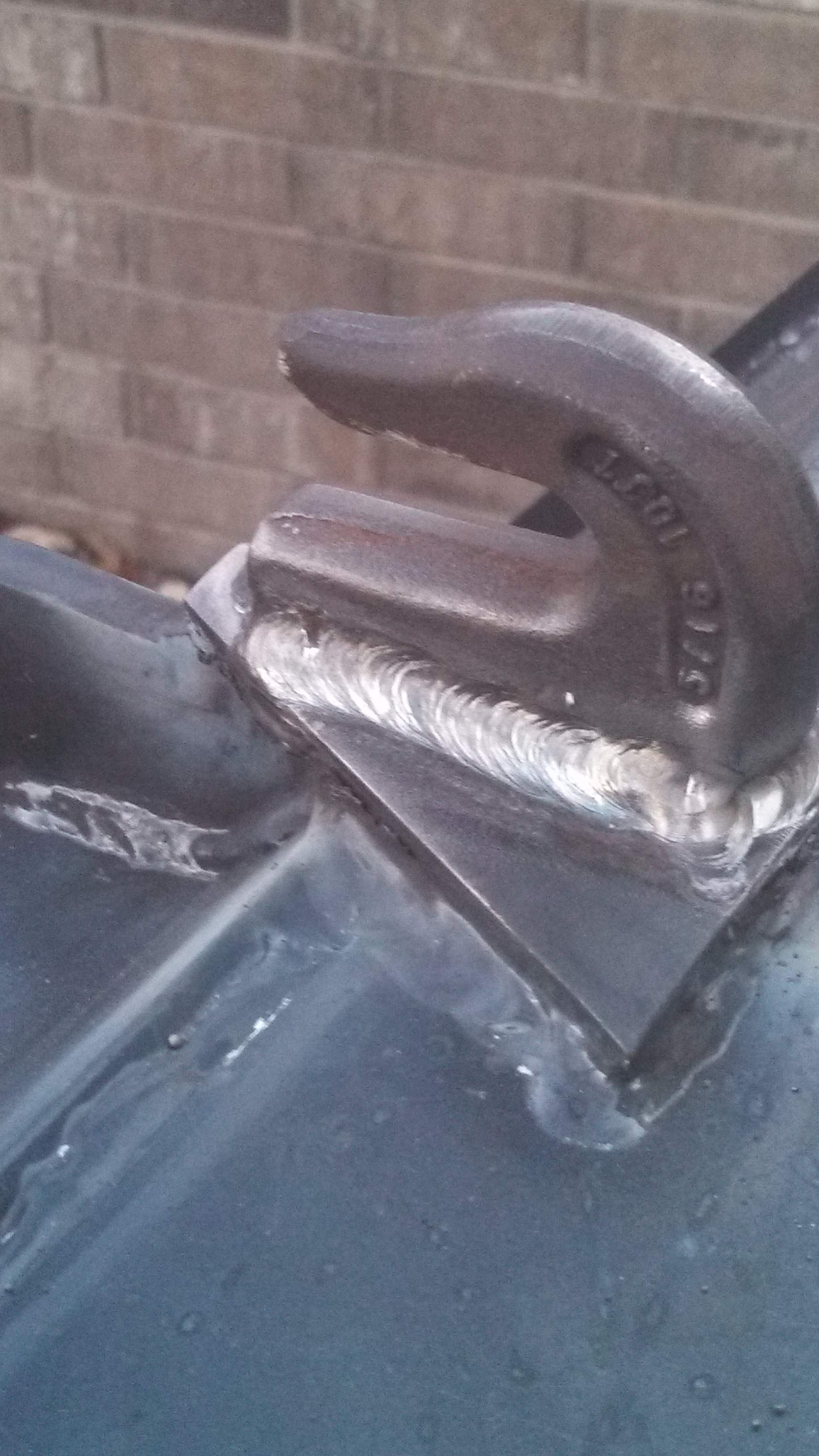

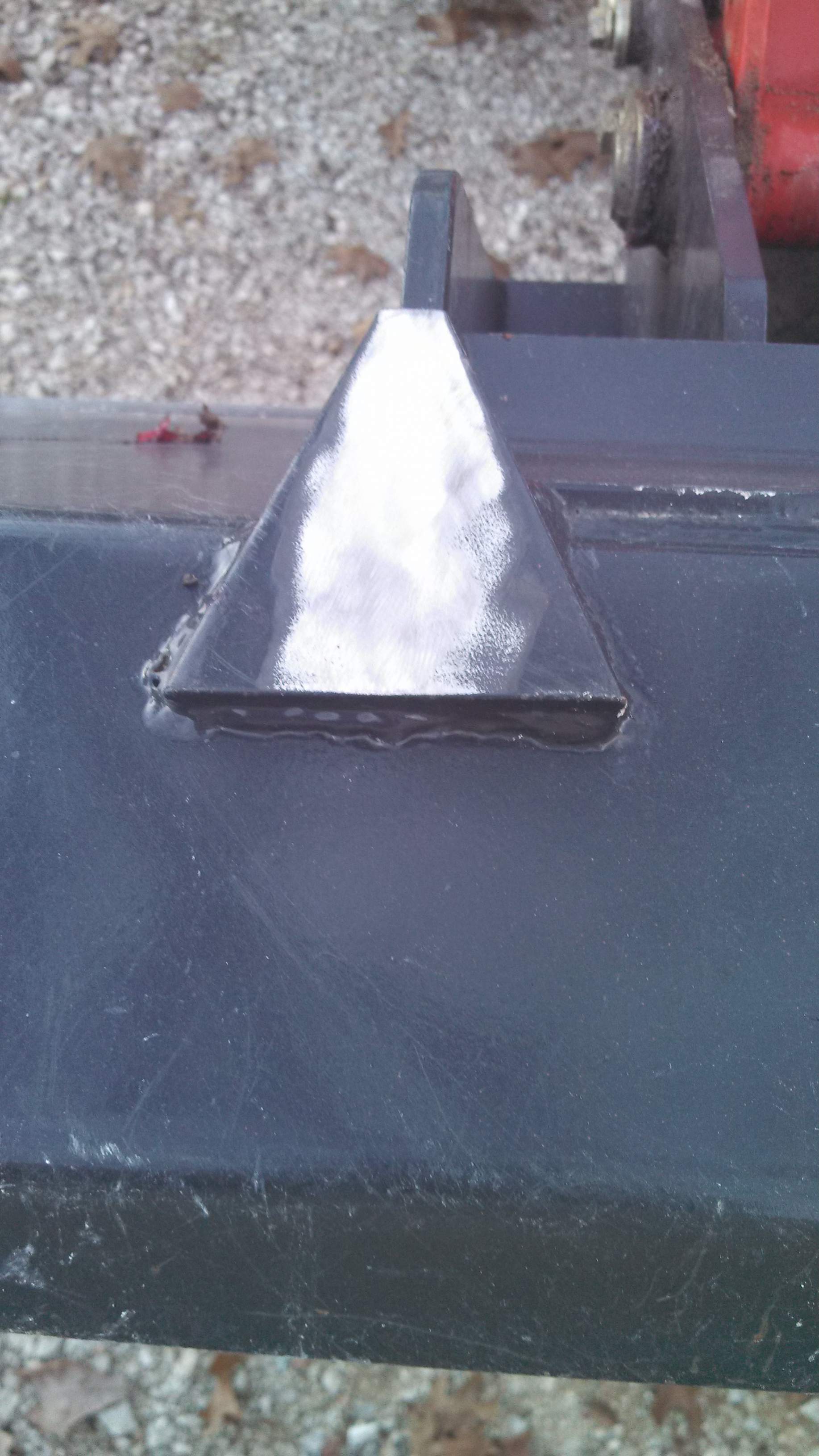

This does not reflect in any way on Kenny's bolt on hooks, as he has hundreds of very satisfied customers, but this is what I did for my Kioti. As you can see it has a pad from the factory on the bucket inline with the cylinders that is made for welding on a hook, so I just welded on a couple.:)IMG_20121117_165303_772.jpgIMG_20121117_162438_547.jpgIMG_20121117_162424_854.jpgAs you can see it did not need any reinforcement

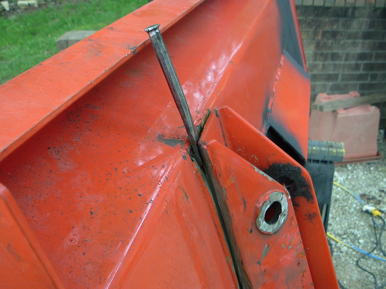

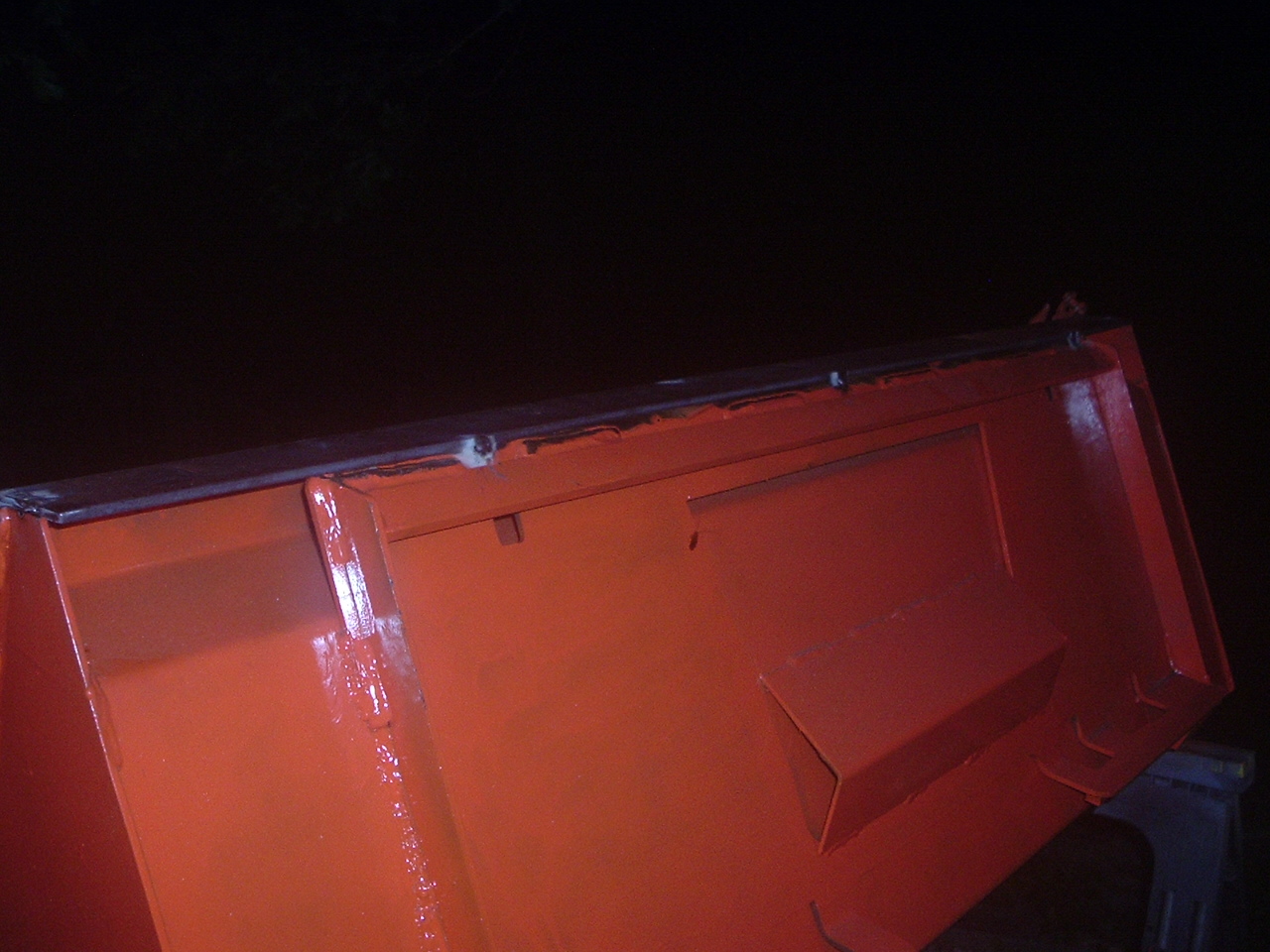

On my old Kubota bucket I converted from pin on to SSQA I welded on a piece of 1/4 inch steel on the top to reinforce it and it also is welded on the the SSQA plate I put on the back of the bucket. This reinforces the top of the thin metal as you can see here in the original photoDSCF0431.JPG
Here you can see the SSQA plate where it joins the top reinforcing barDSCF0456.JPGDSCF0463.JPG
