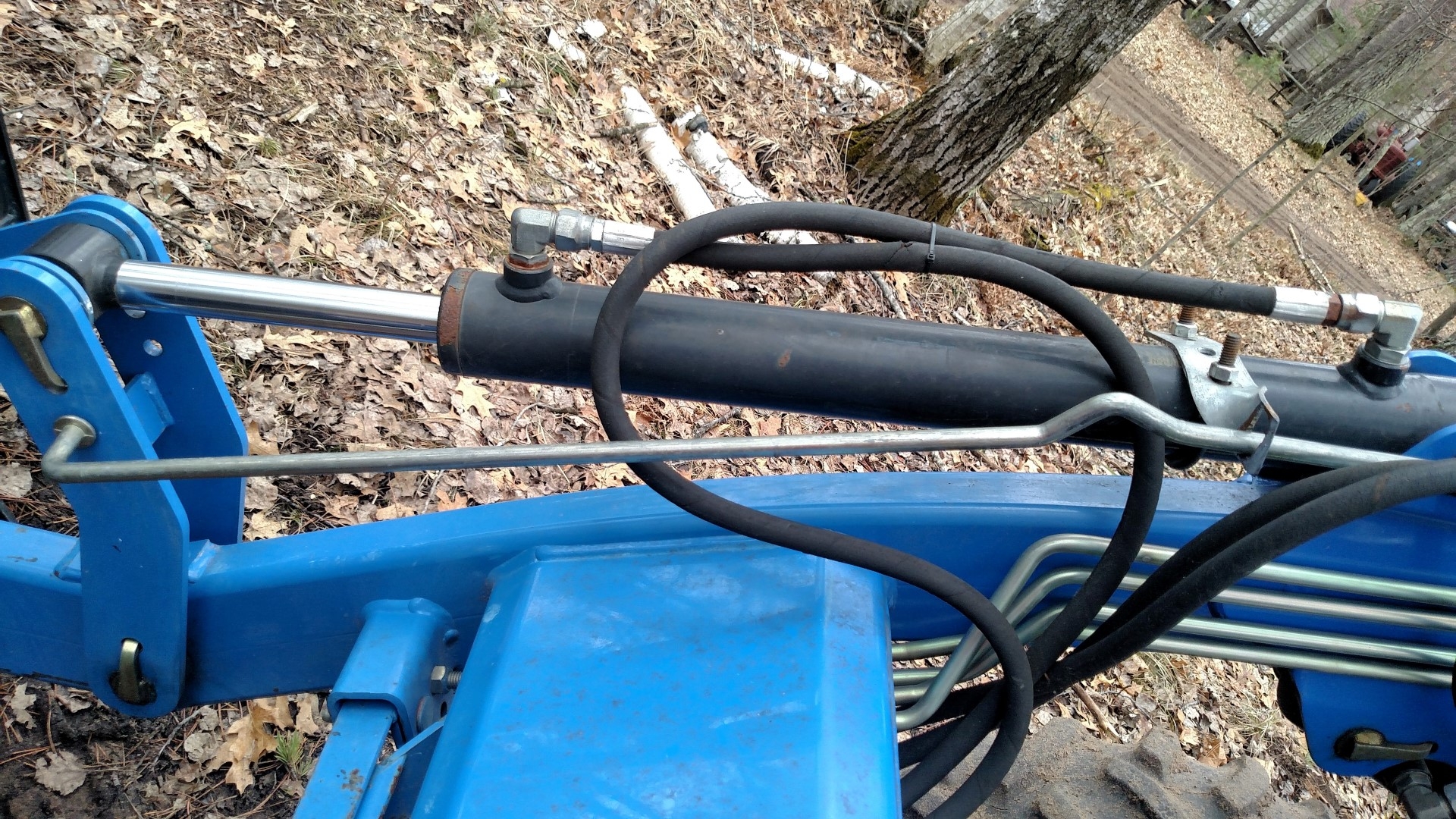

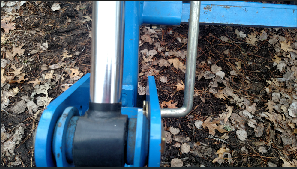

I built one for my BX2230, out of parts and material I had on hand. Works great.

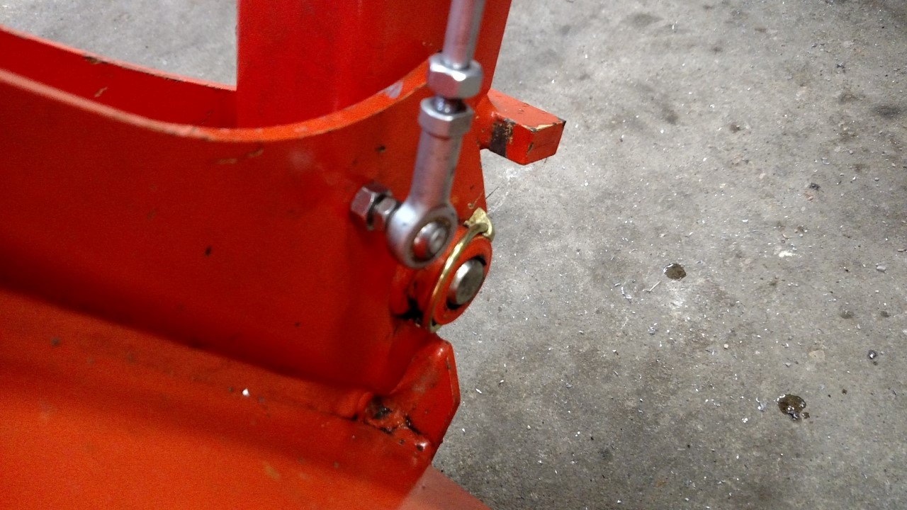

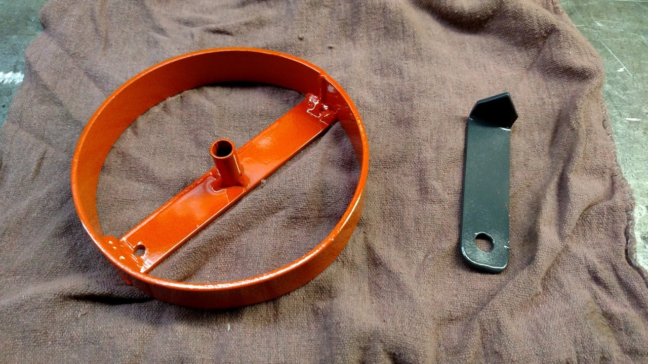

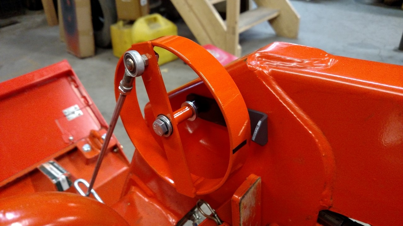

Here are pics of what's on my loader.
   / Has anyone built......... #10

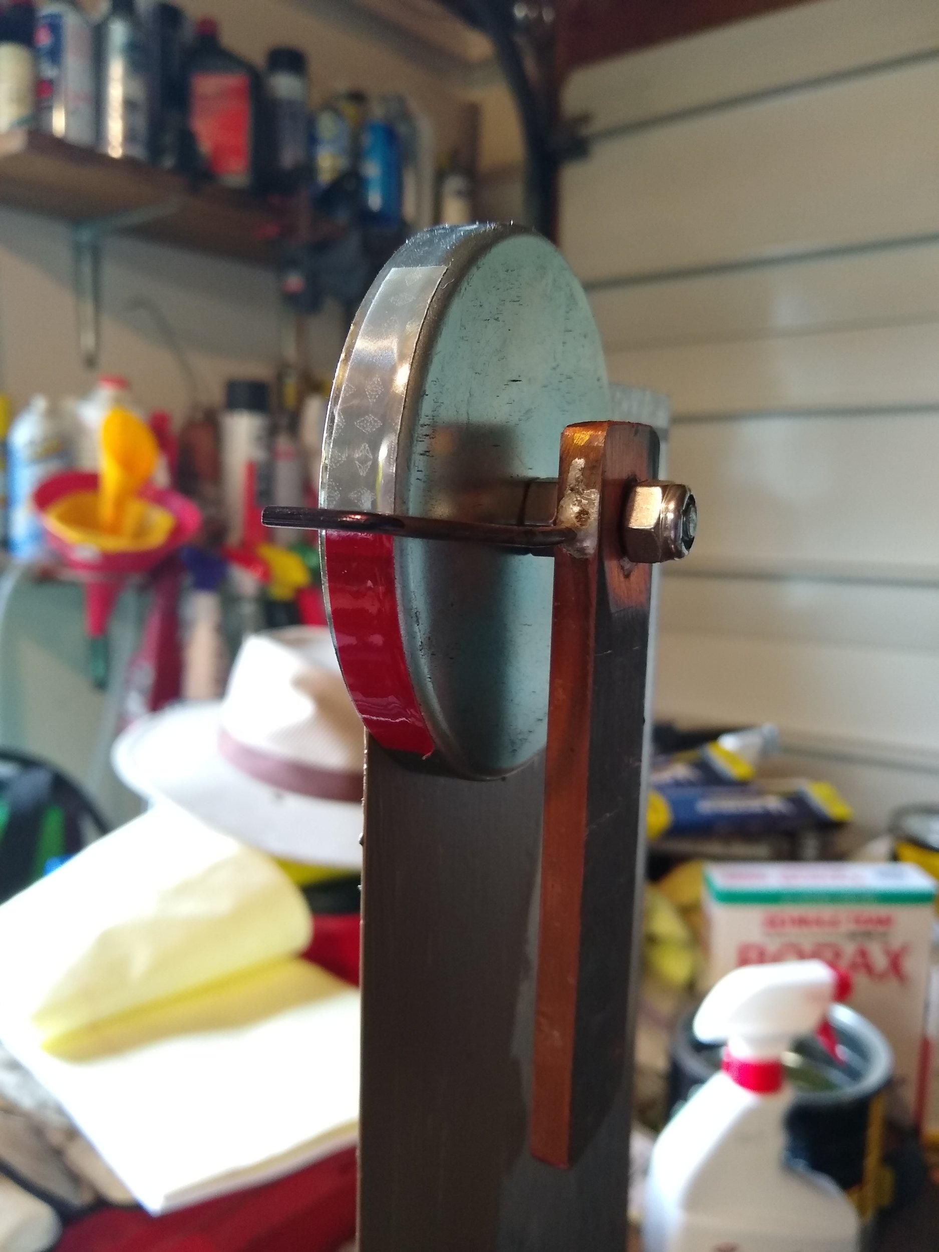

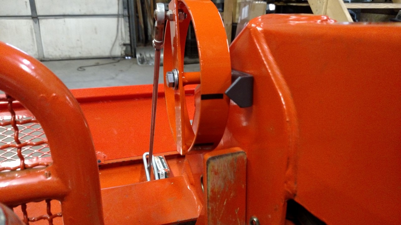

Most BLI's get set to show the bucket position when lowered in the "let's scrape up the manure" position. I made one from some rod and mini Heim joints for the L3200 because it had nothing from the factory. You could come up with some crude system of marking it for other positions and develop a feel for the in-between stuff. The adjustment for level changes with bucket height.
With a little time to think it over it wouldn't be too difficult to make something better than this one that I whipped up a while back for my forks. It's a round magnet with a copper bar and wire that can swing freely. There's a strip of truck tape (aka conspicuity tape) on the edge so it can be calibrated to have the wire between the red and silver when level and stuck on the side of the headache rack frame of the forks. That way it indicates level regardless of the bucket height without getting too technical.
Here's a pic of it stuck on a piece of sheet metal.
