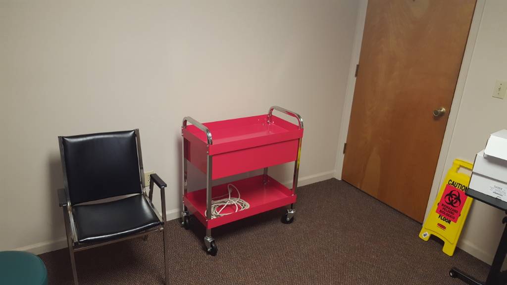

Sitting in docs office to get gout prescription, I see a US General tool cart in the room... View attachment 526857. and yes, it is US General, the draw with name tag is towards wall
I am cool with the HF cart in a medical setting. It is part that 1/3 of hospital deaths are direct/indirect related to medical mistakes that concerns me.
