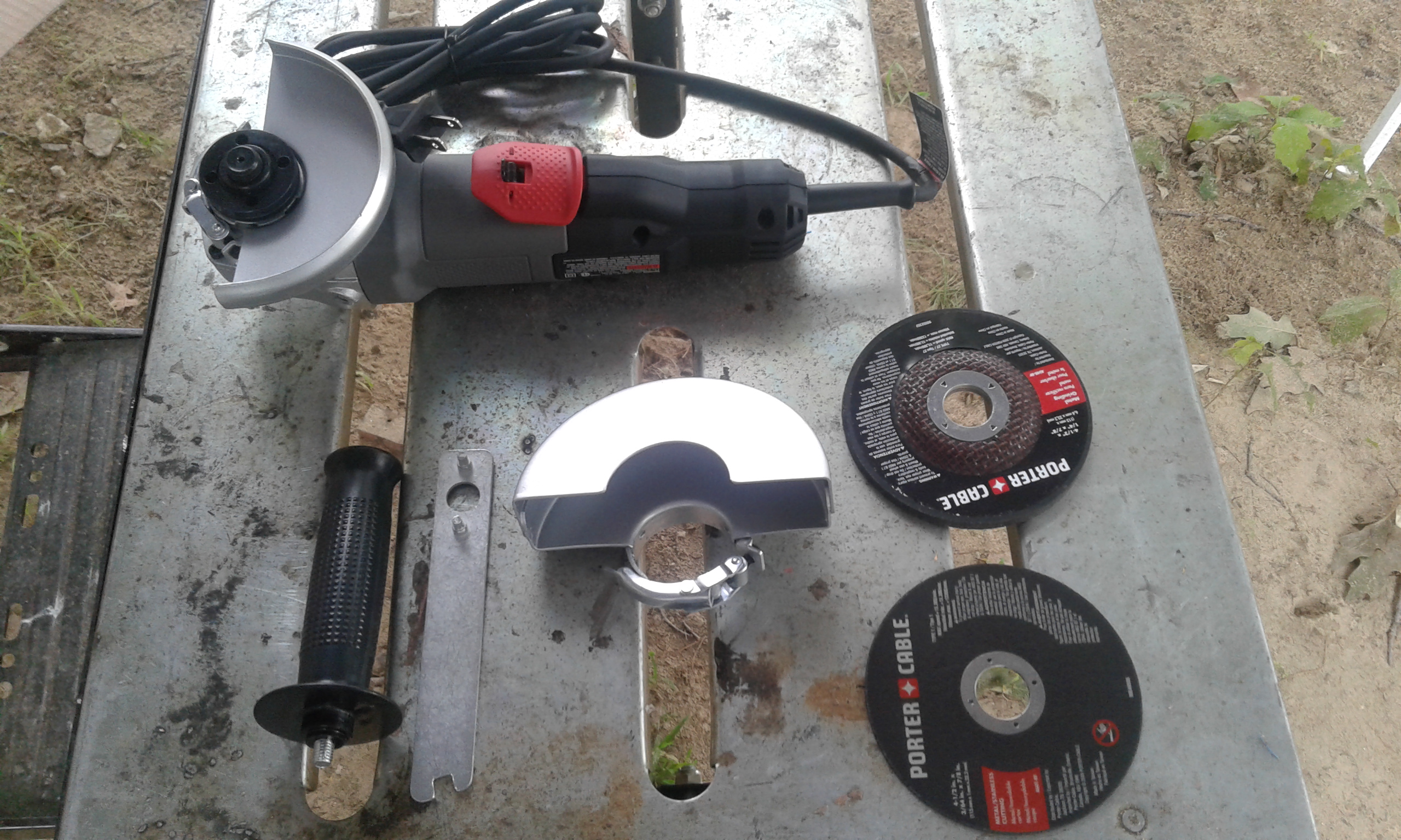

I did buy the Porter Cable angle grinder. It seems to be made quite well. The switch and cord are way better quality that the HF "pro" unit I have. Seeing those already broke on the HF unit hopefully this unit will hold up better. No there is no brake on it. The body is a bit thick but the paddle switch is easy to operate unlike the HF one until the safety bit fell off...lol. I'll give an update after I've used it some.
To keep this post in line with HF, you can see the new tool sitting on my HF welding table. :D

The reviews on that one look excellent, also the specs. I think it's well worth paying $5 more than the not-quite-as-good HF grinder. But I don't see electric brake listed.
I posted a question about that on Amazon, and the uniform answer was: "No, it does not have the braking feature/function".

Ha ha, you can tell eh? I used the grinder for a couple hours today, so far I like it and really like the easily adjustable shield and paddle switch setup. The metal nose gets hot but no real need to have your hands up there. The vent holes also are in a good place as not to blow dirt in your face if you put the unit on the ground. That's one feature my son really likes, the HF unit spews that dirt all over you. One thing to note, the guard has little nubs in it so it only comes off in one position. Again no, there is no braking feature. I haven't seen that on any units near this price range.
