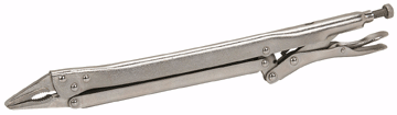

Well the wife and I were in HF this morning and I found this-Harbor Freight Tools - Quality Tools at the Lowest Prices
a 15" locking pliers.
Wife asked what I was going to use it for- I said I had no idea but when the application came up, and I'm sure it will, it will be just the tool for it:D
