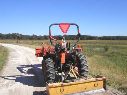

   / Gravel Road Maintenance, Which Implement #6
I grade our three miles of limerock road twice a month with a Bush Hog 84" box blade that weighs about 850 pounds, works excellent! /forums/images/graemlins/wink.gif
Sometimes I use a 72" box blade and it works good too, although it doesn't weigh or hold as much.
