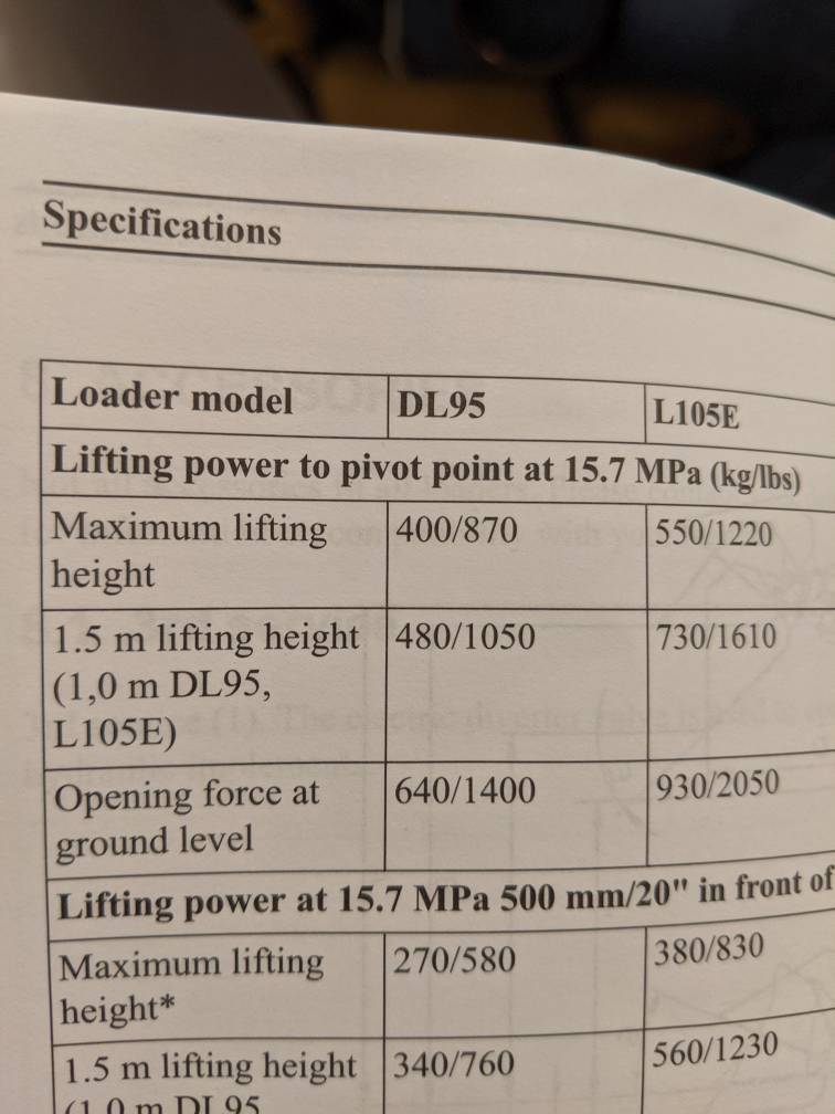

Look at the weight lift charts in your FEL owners manual. The "lift capacity" for an FEL is usually listed for a load 24" forward of the pivot pin and 36" off the ground.
With my grapple - the center of the load is usually 12" to 14" forward of the pivot pin. On extremely heavy loads - I lift just enough so the bottom joints on the FEL don't drag. In other words - ZERO lift height.
This has a VERY SIGNIFICANT bearing on the load I can lift. Of course, as any load is elevated the capacity decreases.

If your tractor has the DL95 loader you won't have enough lift capacity to effectively use a grapple. Even that high dollar EA grapple will only leave you 340 lbs of lift capacity.
/ Grapple!!!! #16
I think your math is off. Lift capacity at pin is 870lbs. SSQA eats 75lbs or so. Grapple is 225lbs. Even with the attachment forward an inch or 2 your still in the neighborhood of 570lbs or full height lifting capacity. IMG_20191019_185530.jpg
/ Grapple!!!! #17
I think your math is off. Lift capacity at pin is 870lbs. SSQA eats 75lbs or so. Grapple is 225lbs. Even with the attachment forward an inch or 2 your still in the neighborhood of 570lbs or full height lifting capacity.View attachment 625330
I was working off the 580 lb capacity 20" forward of the pins.
