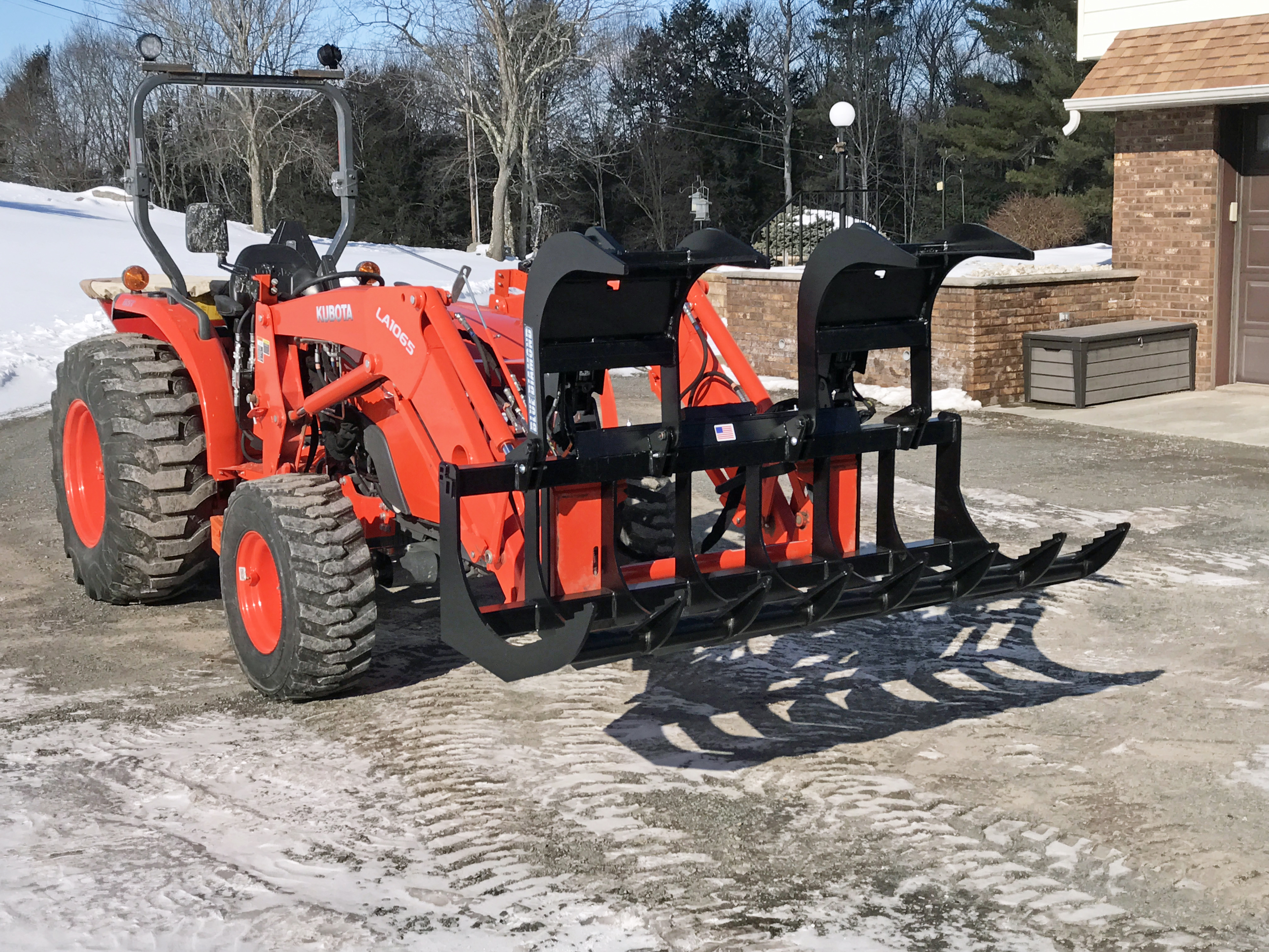

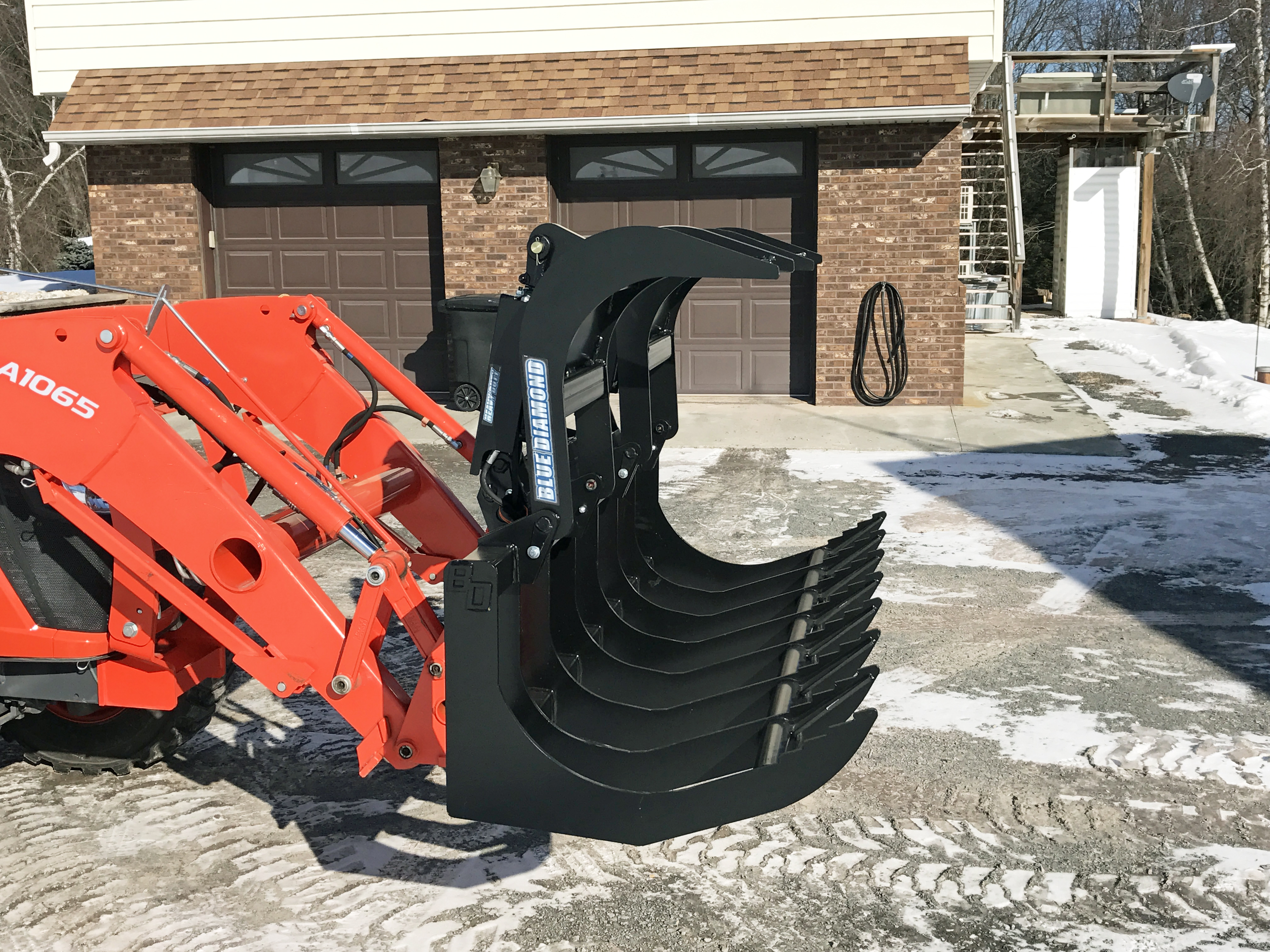

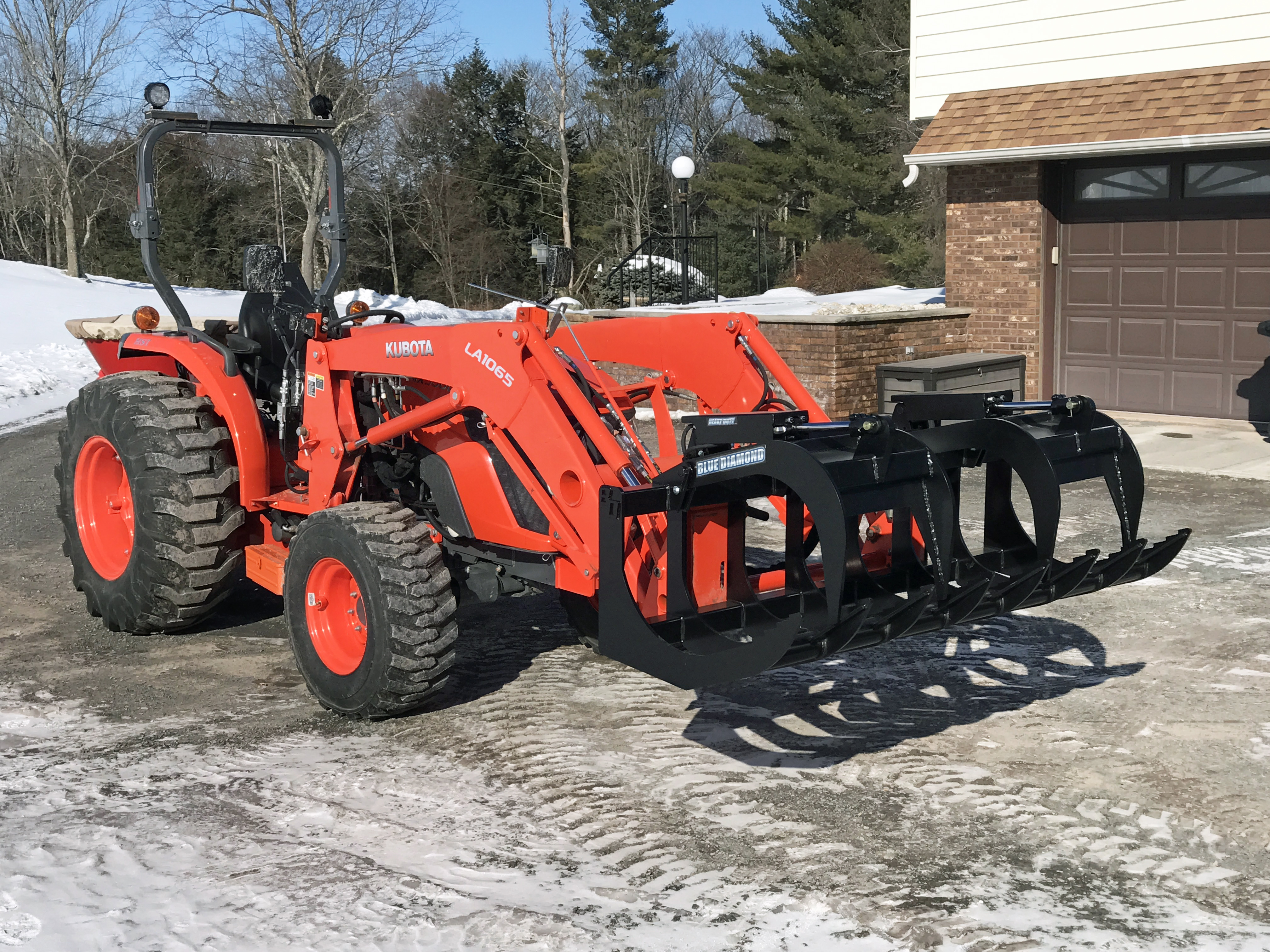

I researched grapples for several months before buying. I wound up with a 72" dual lid Blue Diamond (same width as the bucket) . The dealer had one in stock and gave me a good price. The Blue Diamond had the specs I was looking for and I couldn't find any bad product reviews. Availability turned out to be the deciding factor.

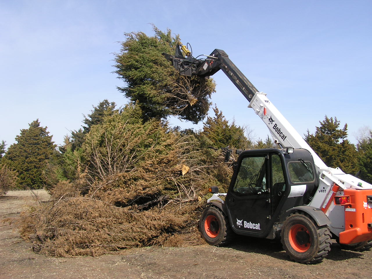

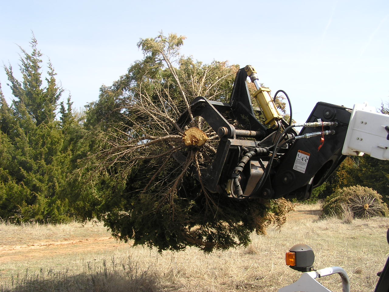

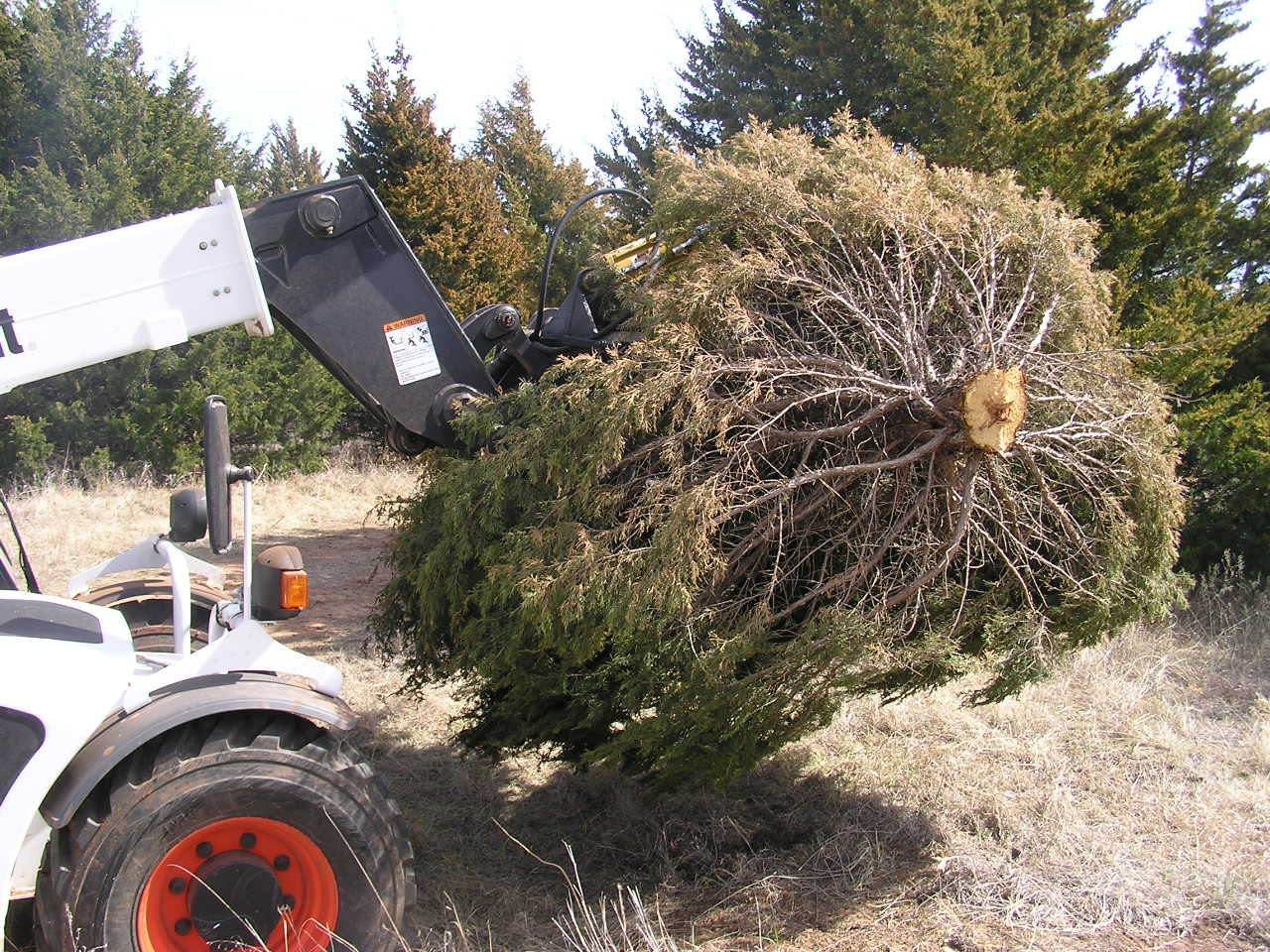

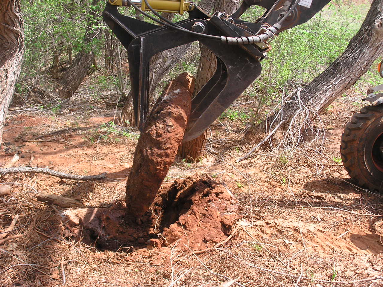

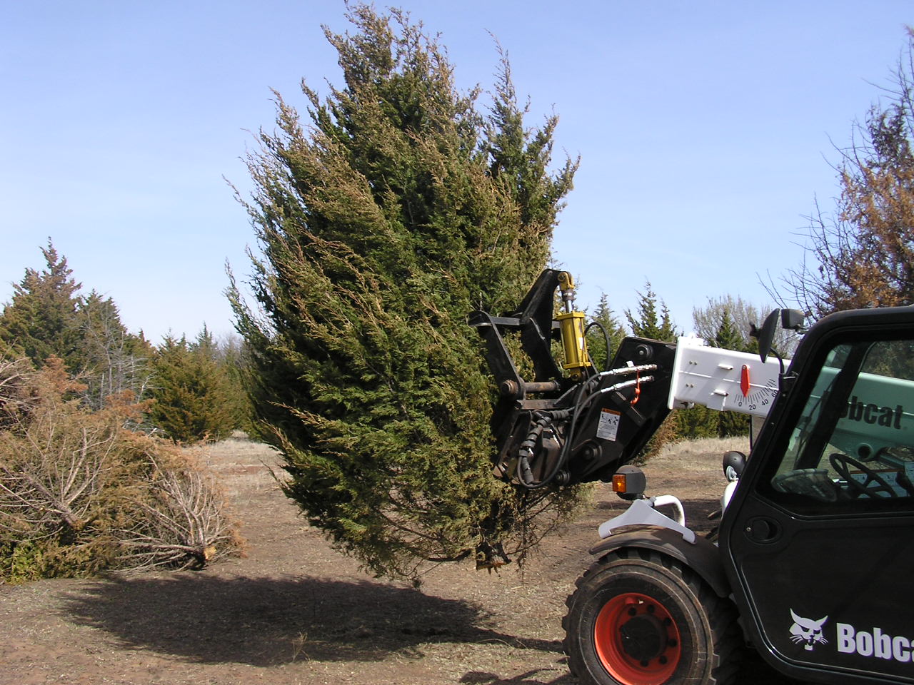

I bought this 44" wide Gorilla Grapple seven years ago to pick up sheared cedar trees, where we used to live. I had been using forks, but you had to get lined up with the side of the tree to get the forks under it. Then about halfway to the burn pile the wind would blow it off and I would have to maneuver to get lined up again to pick it up.

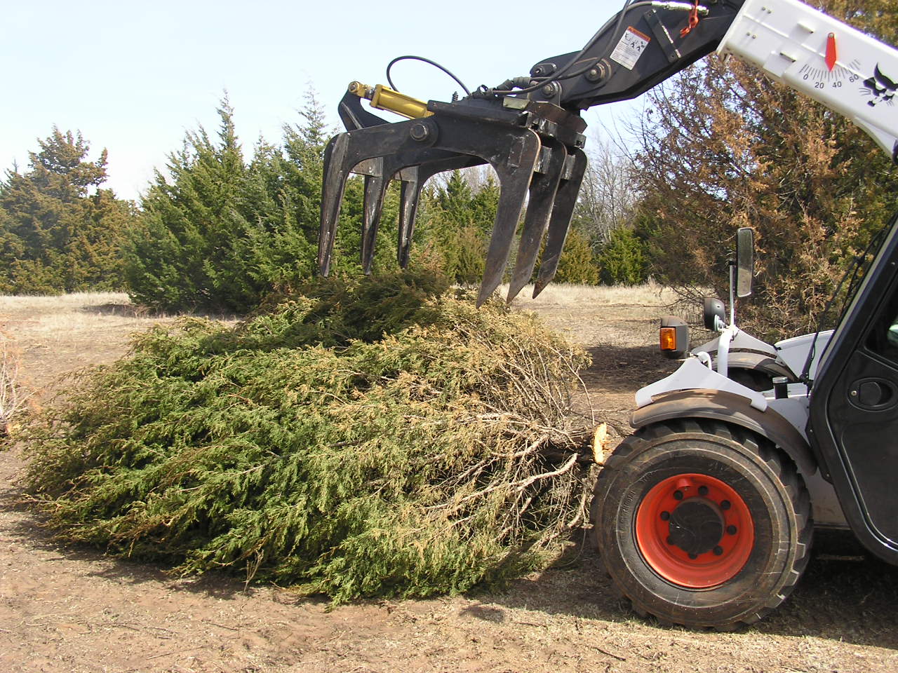

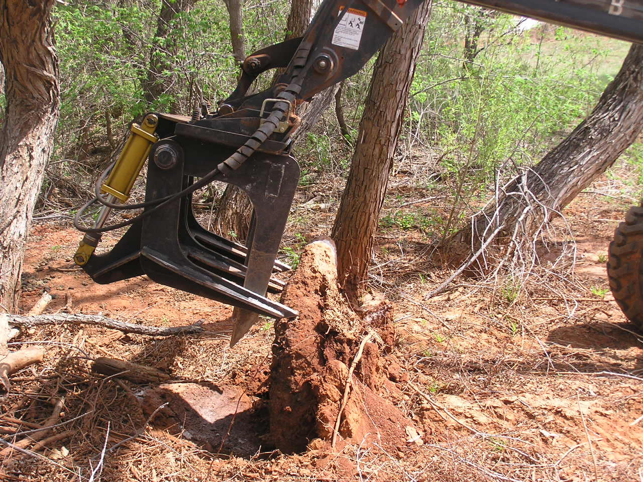

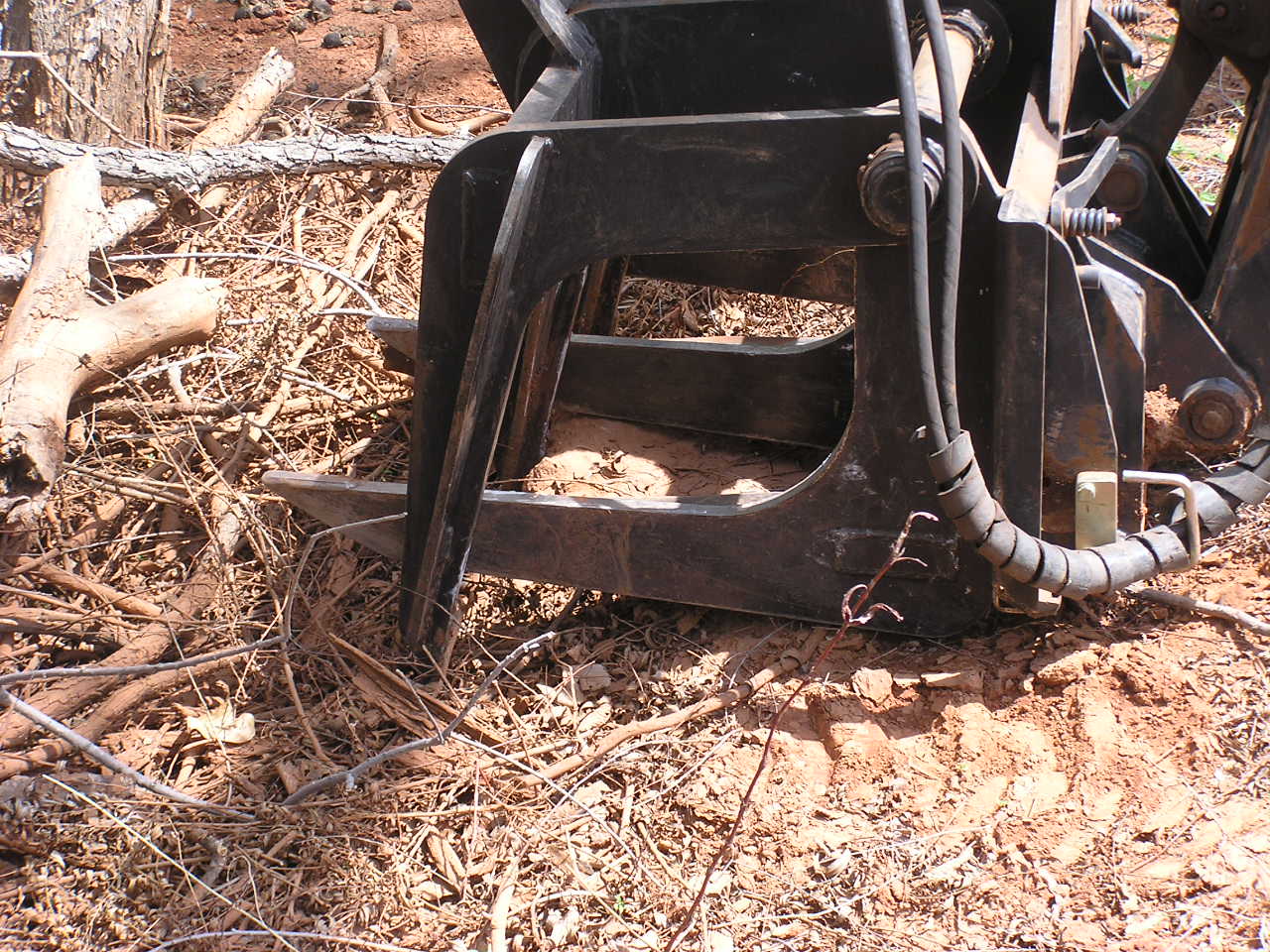

This grapple doesn't have any cross bars, so it will penetrate the tree no matter what angle it is laying:
Also the upper tines bypass the lower tines, making it easy to pick up chunks of concrete:
