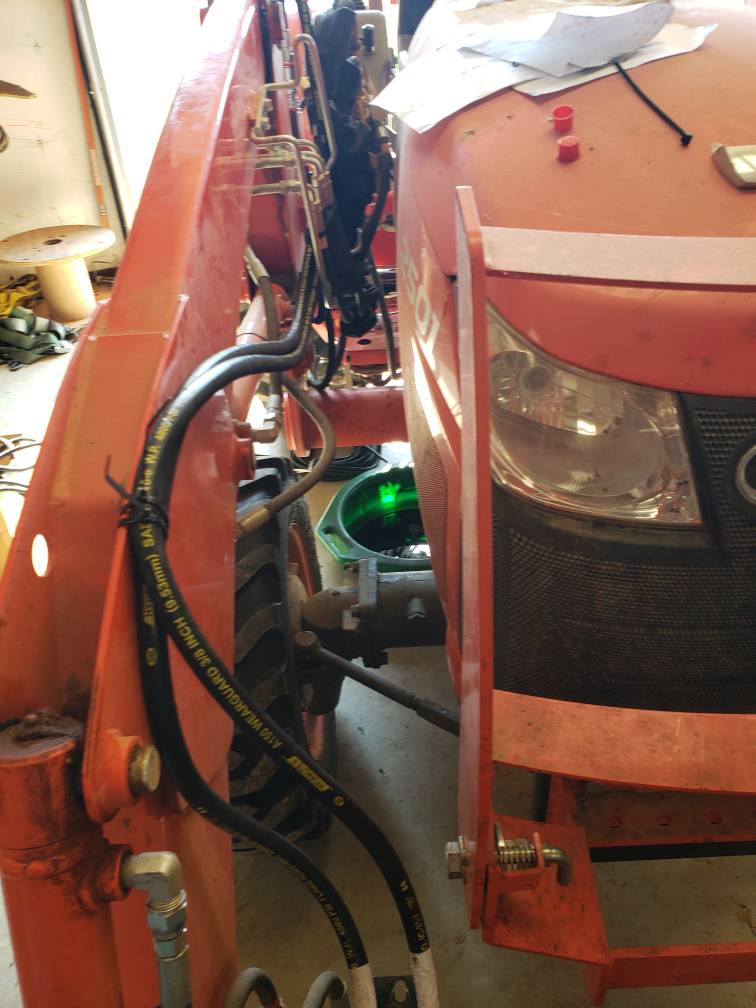

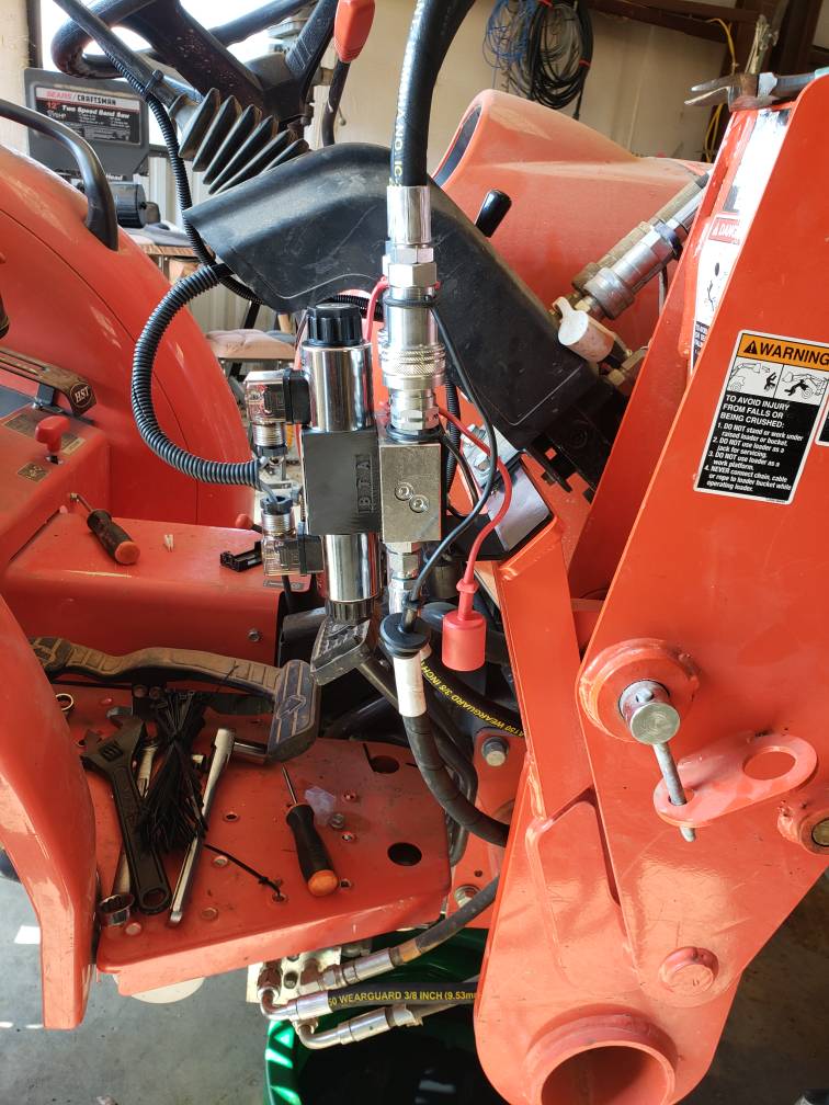

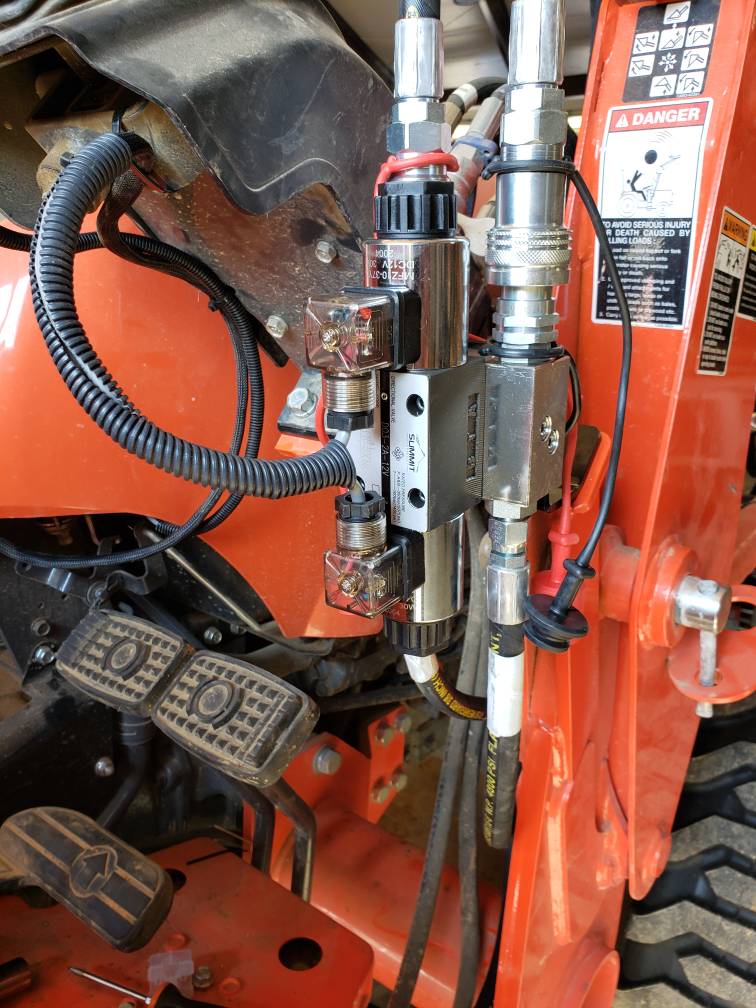

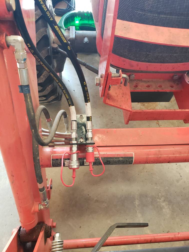

Got the Summit 3rd function installed today. Pretty easy install and looks good. Grapple arrives Thursday 20201020_143118.jpg20201020_143122.jpg20201020_143129.jpg20201020_143138.jpg

Awesome. You're gaining!!!
