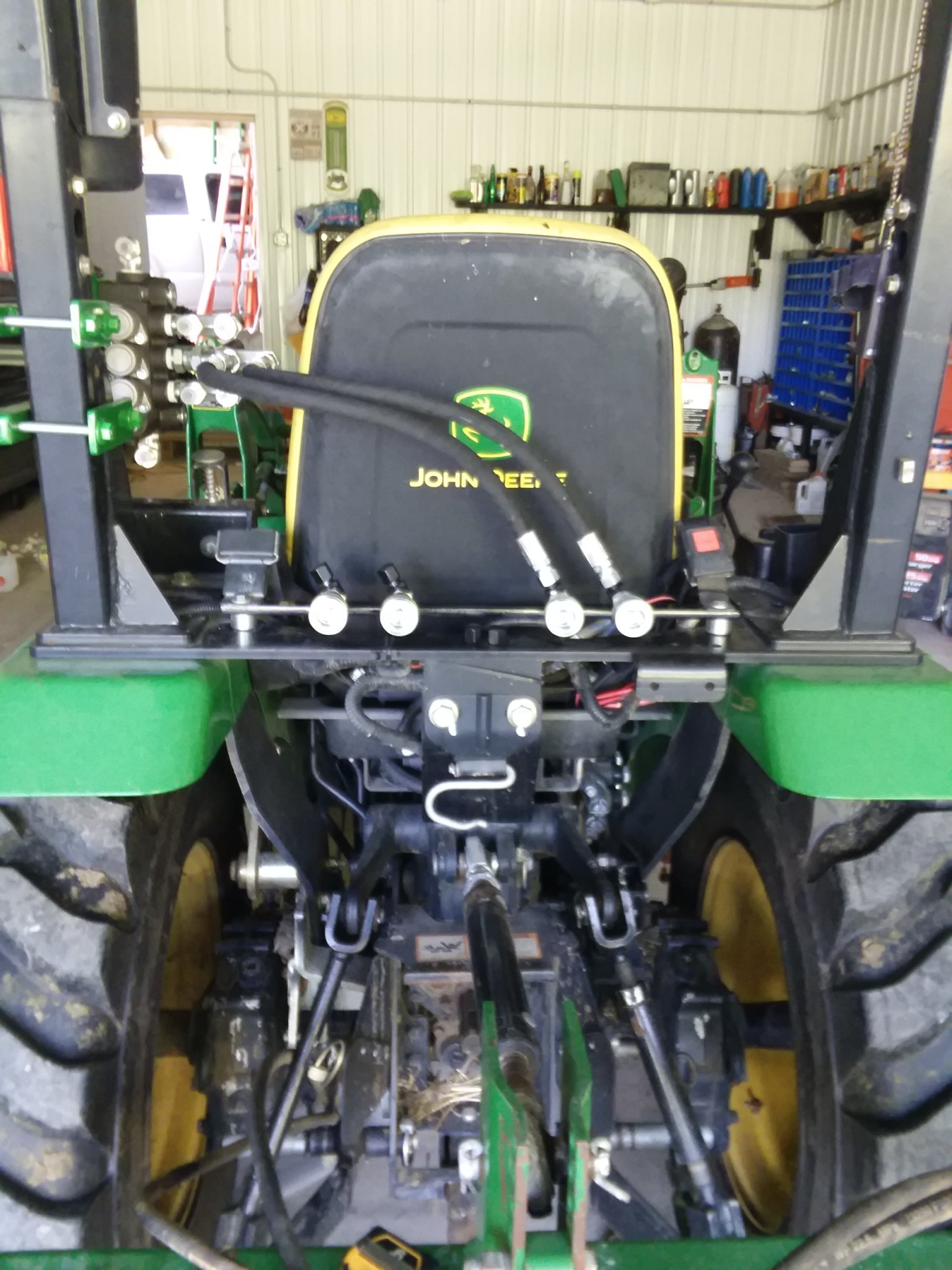

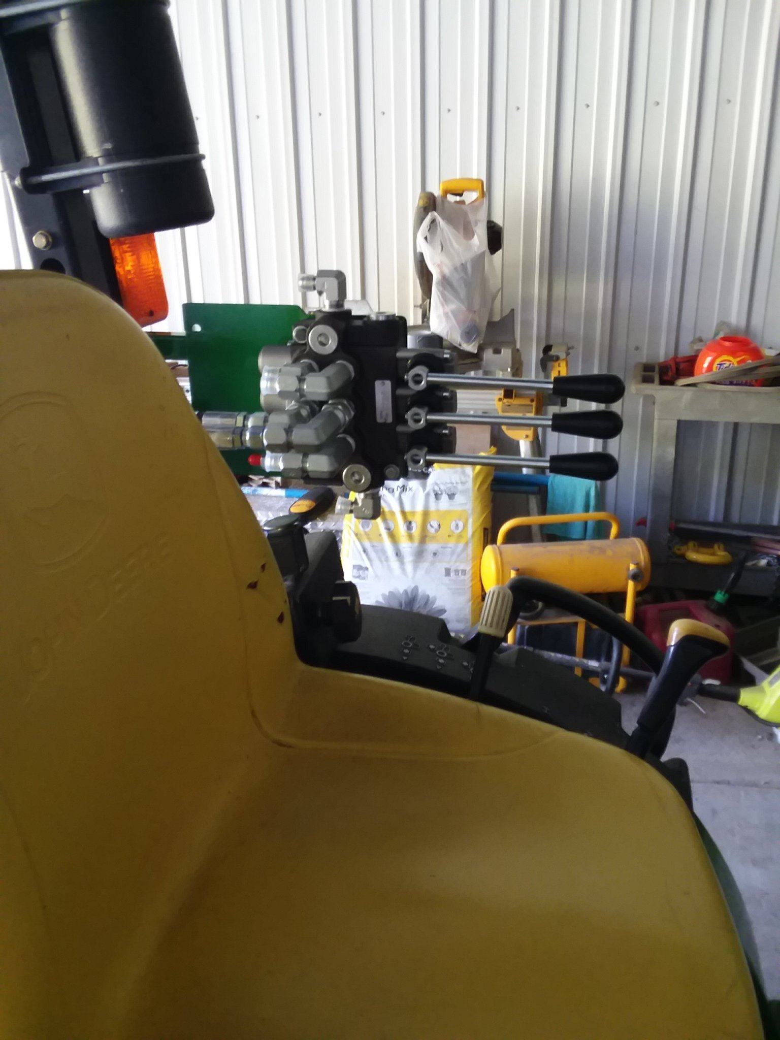

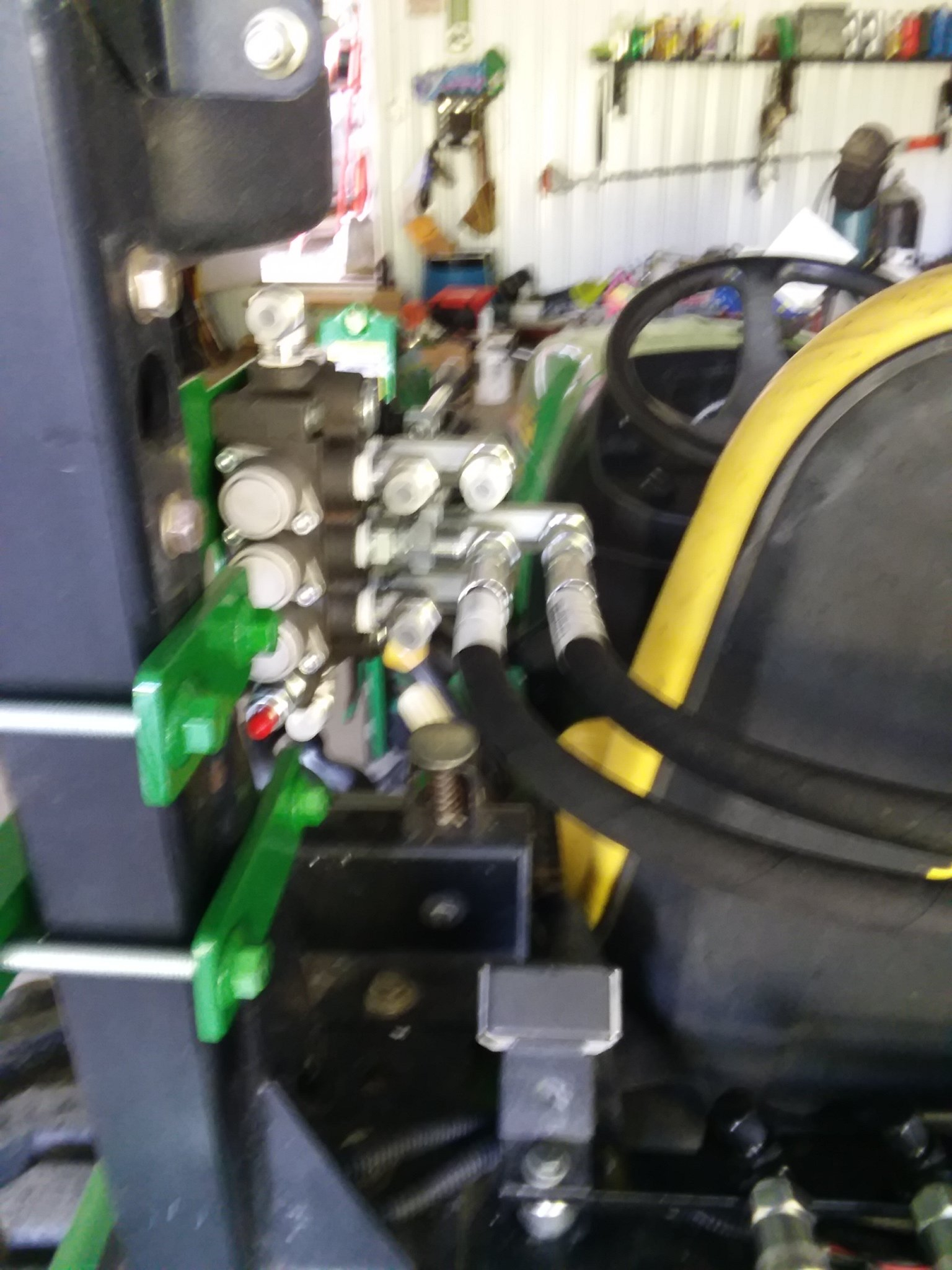

We guys here is an update on the progress.
I've started the plumbing and of course, missing a couple of things. Here are some pictures that I can check out and give me some feedback on. Also, here is a link to some of the information that I've been going by.

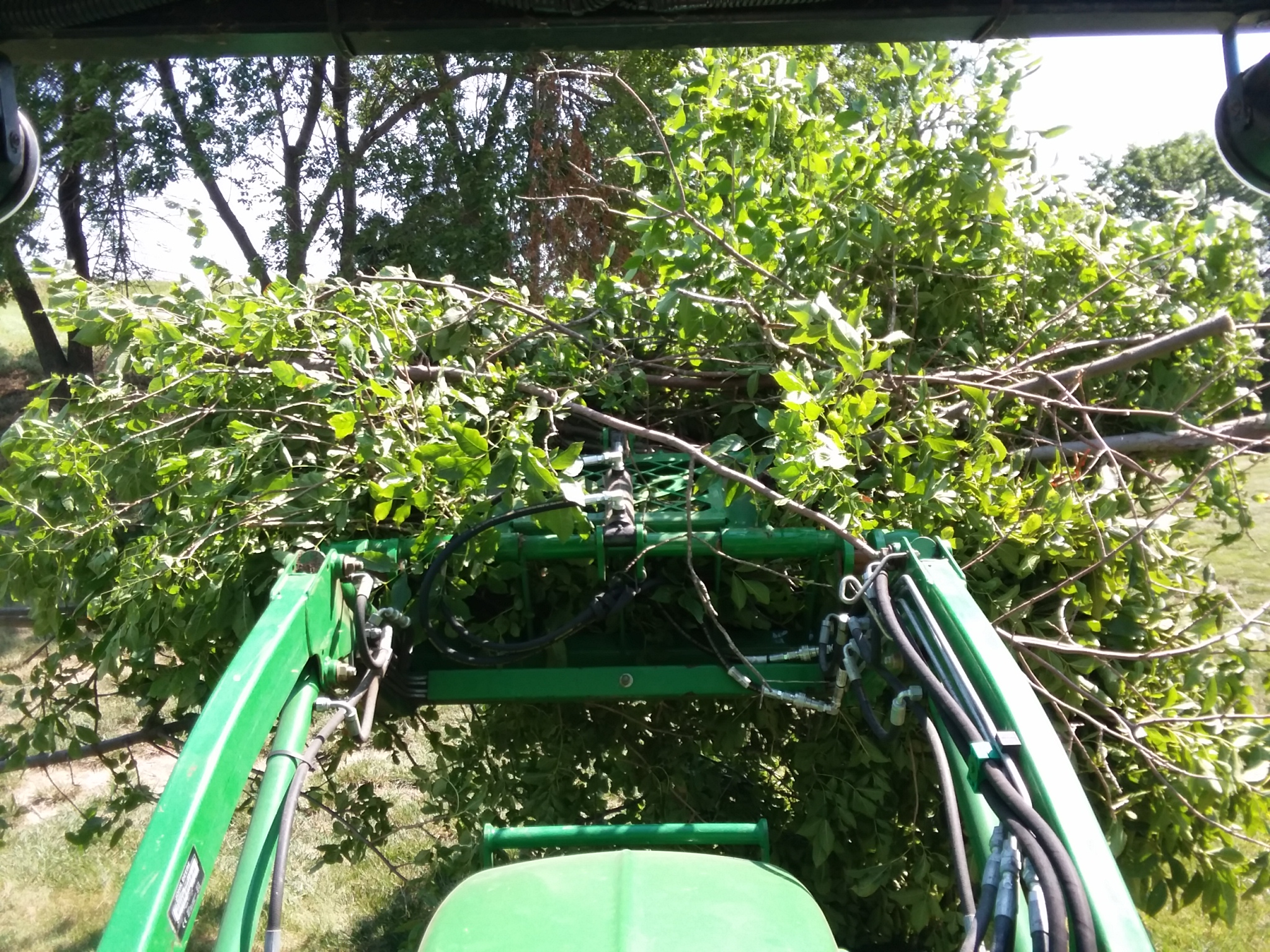

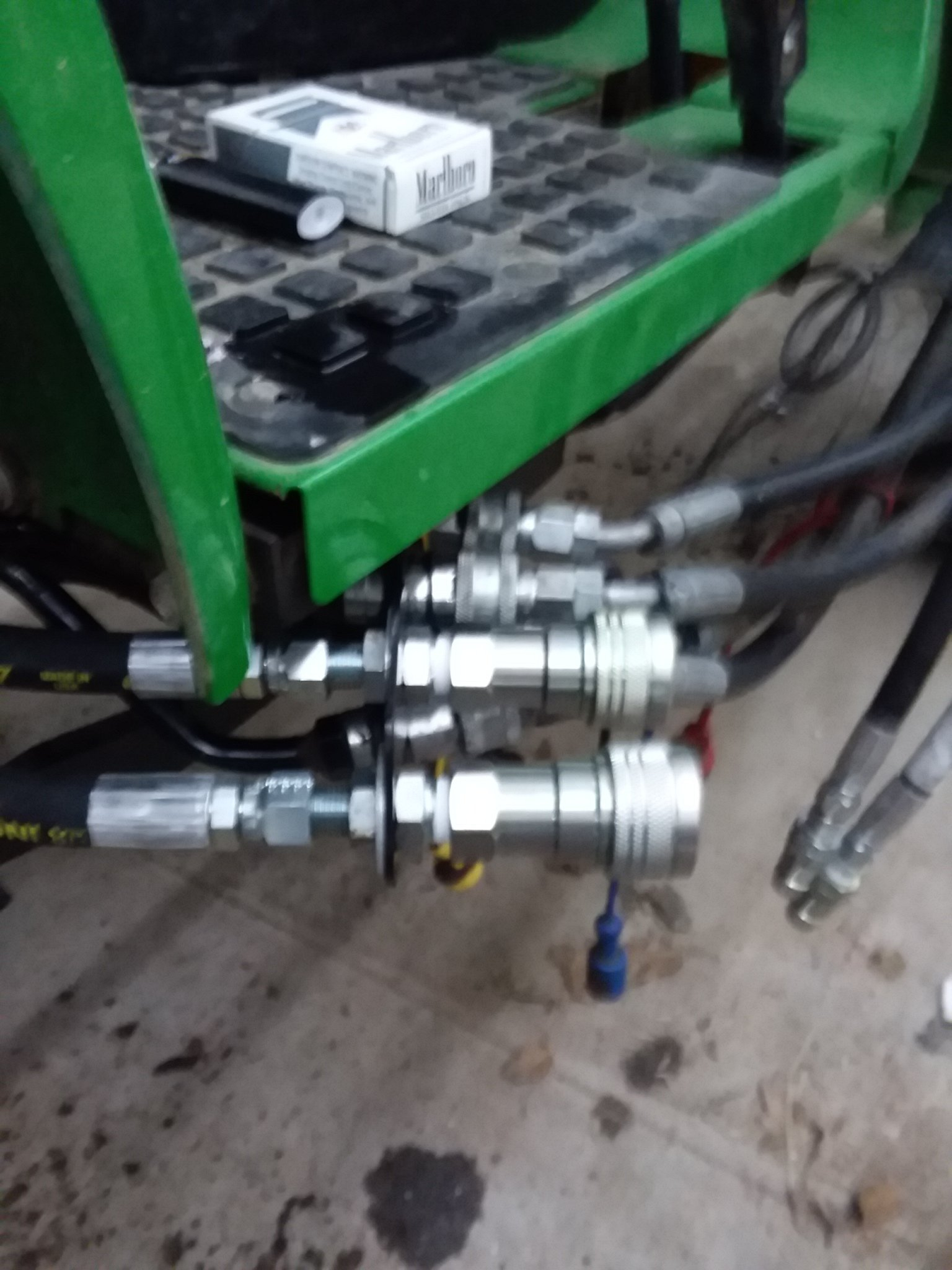

I've got it a plumbed and been using it some.
Going to make a bracket for FEL lines and I did put QD's buy the other ones.
