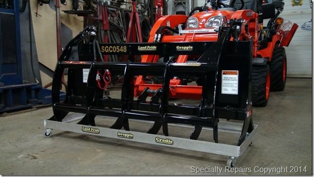

In the market for one of these two machines....it will be one of these two. I would like a grapple on it and really like the looks of the Land Pride SGC05. Moving brush, picking up RR ties will be a big ongoing job for this machine....whatever it ends up being.
In looking over the Land Pride site I come away that this device will only work on the Kubota....is that accurate?
If that is accurate any links or suggestions for the same type of device for a 1025R

The Grapple was made for the Bx line but should do well on the JD also
   / Grapple for BX or JD1025r
So the buckets attach in the same matter? (sorry I freely admit I am a total noob, and if I ask stupid questions) And the controls will all hook up to the JD without having to "rig" something.

Check out Artillian if you decide on JD, they offer the lightest forks made, and are coming out with a grapple this spring, lots of other options as well, he even has a plug-n-play diverter setup to operate the grapple. The Kubota and JD do NOT use the same quick attach setup, it's included as standard equipment on JD, but optional on the Kubota models I think.

Land Prides SGC05 grapple is made exclusively for the Kubota BX25. It will fit the FEL pin layout and Kubota's FEL QC. I did that install last week along with the Land Pride 3rd function valve.
