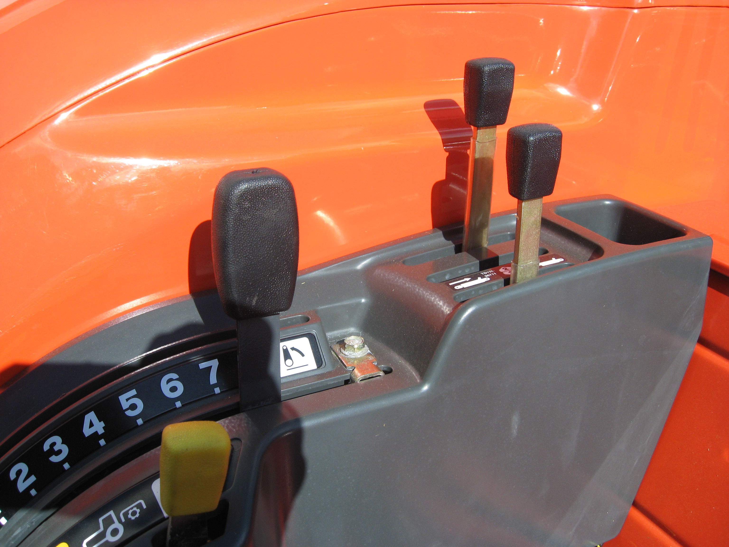

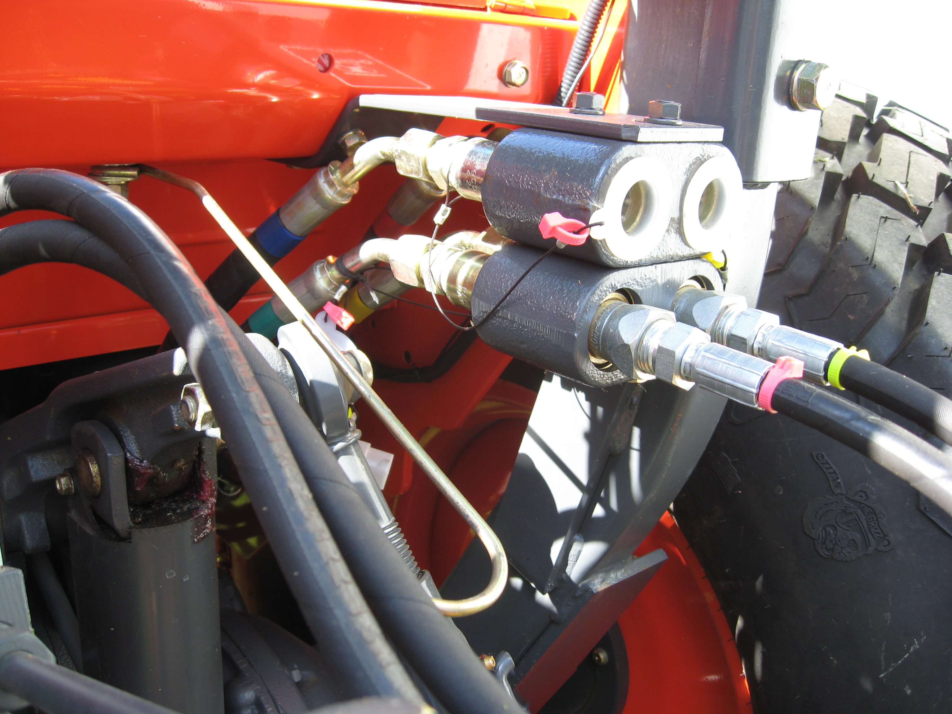

Rear remote L8335-20 / L8309-2, $718. Philip.

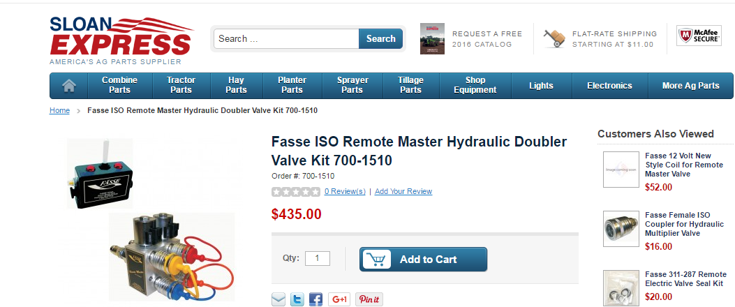

If it was my tractor I either install a Fasse valve or install a generic spool valve with breakaways on the BH connections.

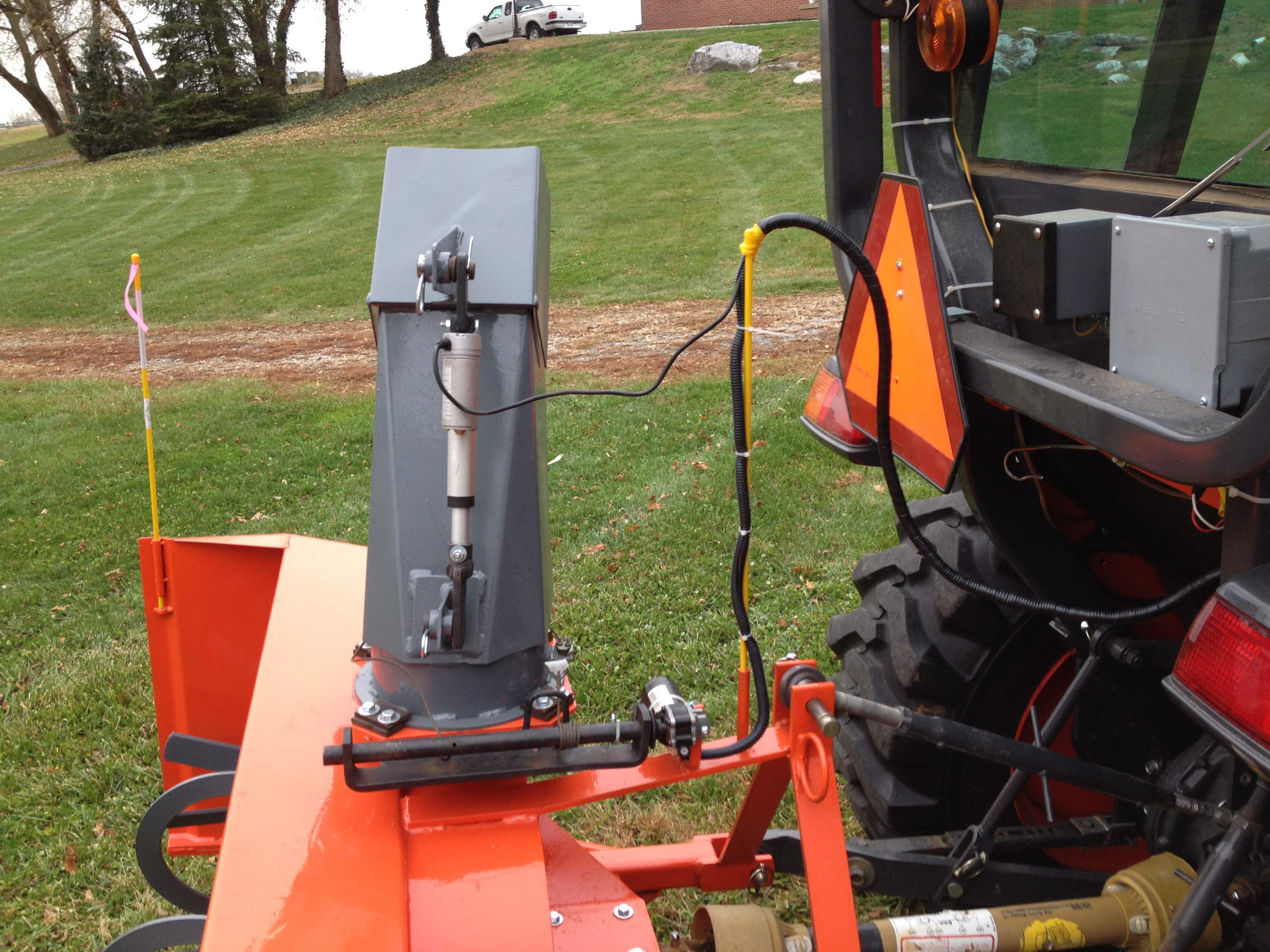

Depending a 12v linear actuator may be cheaper & easier to install. Actuator, wire & a DPDT switch.
   / Grand l3540 Need to control hydraulic chute rotation on rear snowthrower #8
Agree with Leejohn -- I'd think you can just get hoses made up with the right connectors and do as you planned -- run the roll function to move the chute. As Leejohn suggested if you use a small line it will self-restrict the flow some and probably not rotate the chute too fast. One caution is that you might have a detent-type valve control and that would turn on a potentially fast rotation that takes you a second or two to shut off. I detest these detent style controls and much prefer the plain jane control valve that just does what your hand tells it to and nothing else. If you have choices pick a valve without the detent. Then as Fallon says the 12v actuator route might be less trouble (??) I saw a post a couple of weeks ago [you can probably search for it in the forums] where a guy had installed an automotive power seat motor and gear rig to rotate his snowblower chute. Looks pretty simple. I did save the picture which is inserted here.
