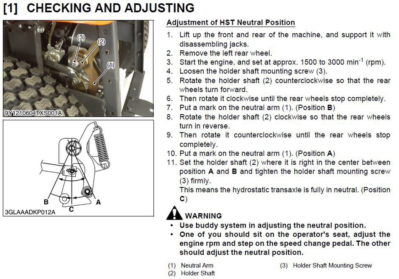

Does anyone have a pic of the the location of this bushing, mine has a slight creep now also.
   / GR2120 creeping #14
Just found the page in the service manual. Should have looked before posting.
Great!. Now if you'd post a picture of the location of this bushing on here, folks without a service manual (me) will be thankful!
   / GR2120 creeping #15
Here you go.
