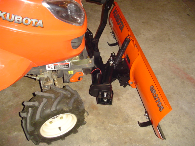

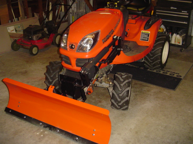

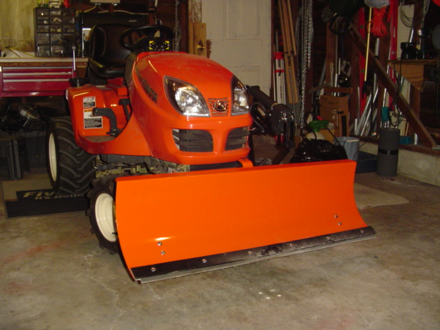

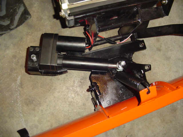

Well,good luck finding anything cheaper.I couldn't,so I bought one from the local Dealer for $500+tax.No special order,just waited till they got one in on their regular shipment.Finished the "MOD" end of the project today.About 40hrs and $400 later,it turned out really well.Learned a lot about fabrication,layout and clearances!
Now I need some snow for the testing phase.

any more info about parts used ect. pics on switches for operation? thanks, looks good.
   / GR2110 plow blade? #4
I took the tractor back up north to do the last mowing/leaves.Probably 2-3wks before I bring it back home-so no additional pics for now.
The switches are DPDT momentary with the builtin crossover,mounted on top,on each side of the tiltmeter(the yellow thingy in front of the steering wheel).Wiring is the easy part.
The angle actuator is a 4-in stroke Bear Linear ball-screw 1200lb/3000lb static load actuator.The lift is an 8-inch Wagner 1000lb.Neither have limiting potentiometers,so I made linkages to work at full travel on both actuators.Both probably overkill,but the only thing I could find on ebay at the time.I also made the lift pivot so it can float down an inch or so,and float up about 3 inches,from level.
If you want in-depth detail on construction,send me a pm for a phone call.
One other thing I did was to put a strip of conveyor belting on the bottom of the blade for a squeegee effect.
