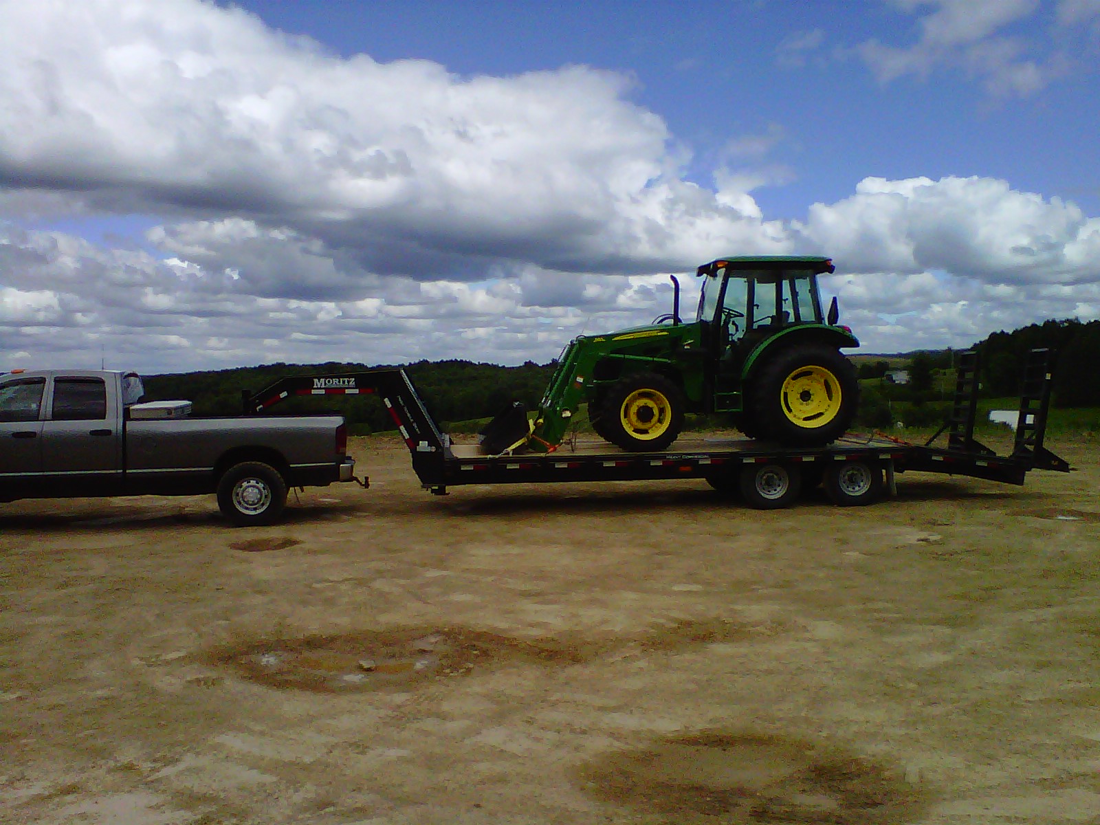

DP, it sounds like you needed an adjustable tail trailer. My moritz trailer has an adjustable tail. It gives you an entirely flat deck just by swinging up the tail and pinning it in place. The trailer comes with ramp bars so that they can be stood up vertically and "WALA" 25' of flat deck. VERY HANDY and one of the main reasons I bought it.

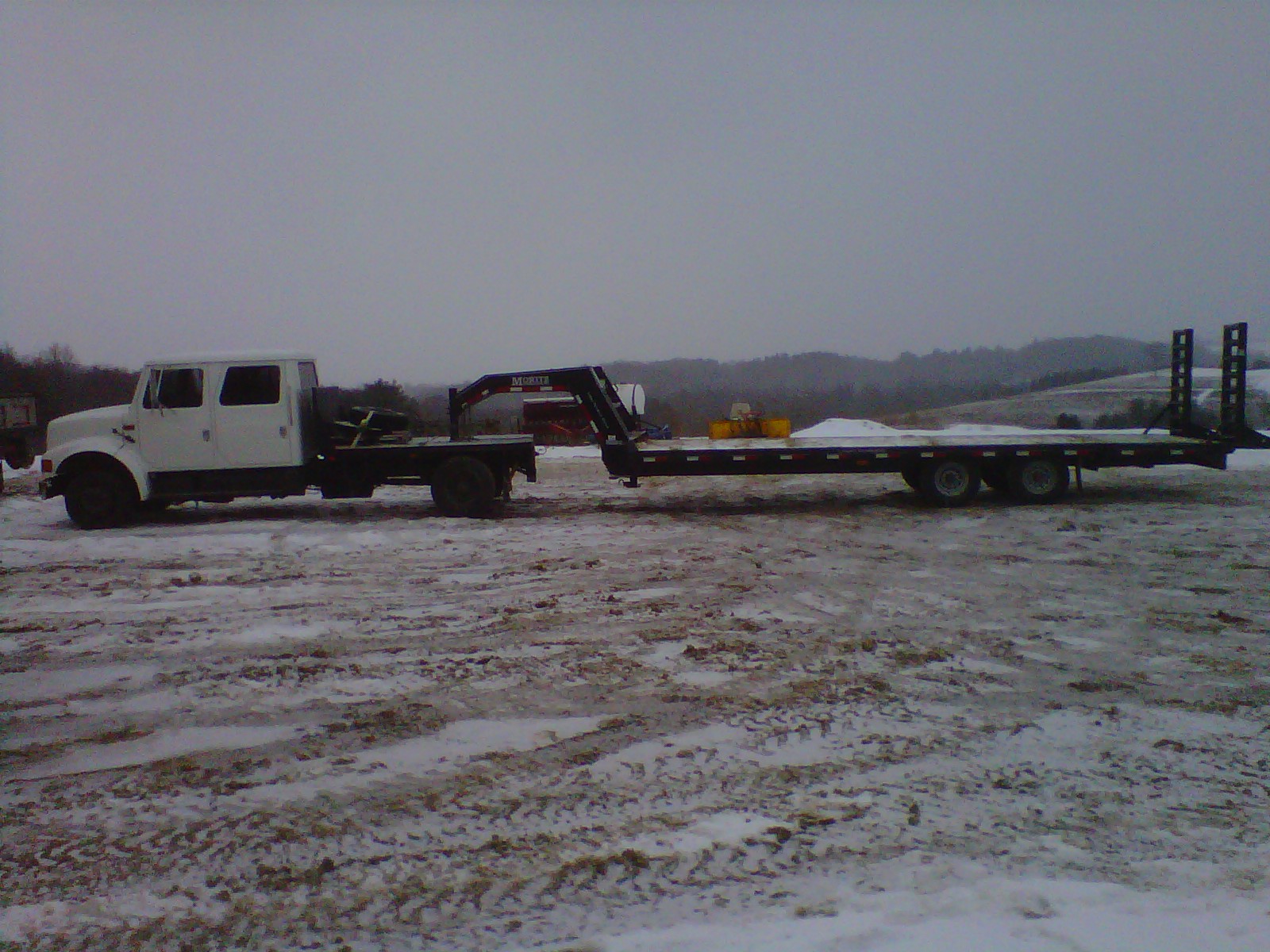

I pulled my 5083E around with a one ton cummins on a GN and it was a lot more weight than I was comfortable with.(Loader, loaded tires and a counterweight) I never broke anything nor did I have any problems with the load. I was always nervous as **** trying to make sure I had enough room to stop and turn. The idiots on the road always kept me on edge. I have since said goodbye to a P/U for my towing needs. The international truck I have now has a 17klb rear axle and air ride. I have to look in the mirrors to remind myself that there is a trailer behind me!! :thumbsup:
To the OP, go get the trailer and try it out. It doesn't sound like it's going to break the bank and if it's not heavy enough or isn't what you thought it would be; sell it. They are a whole different animal pulling and backing around obstacles. They maneuver FAR better than a comparable length BP. I can almost turn around in my own vehicle length with a GN and the international truck. I can go well past 90 degrees between truck and trailer.

RedNeckRacin that Int/gooseneck combo looks like a dang nice rig ! :thumbsup:
Should last you a lifetime !
