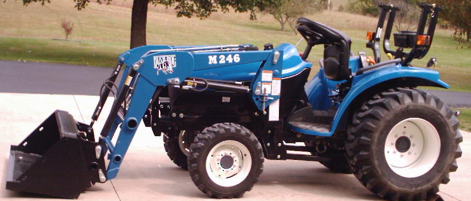

Goodbye M246

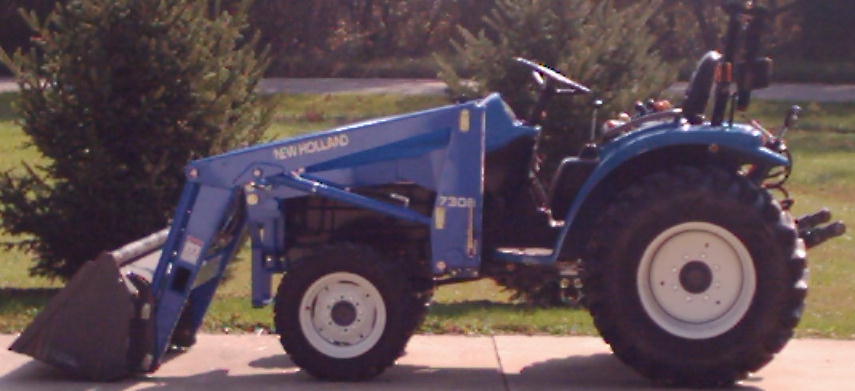

Hello 7308

I finally worked out a deal with the dealer where I bought the M246 and got it swapped for a 7308. (see When is rear ballast needed with a FEL?) It cost me $900. So, in the end, I paid $600 more than I would have if I'd have gotten the 7308 in the first place. I’m not happy with the whole deal, but it could have been worse. At least I got rid of the M246 and now I have a FEL on my tractor that I can use. The difference is amazing. Now, when I drive the tractor with an empty bucket, it doesn't feel like I already have a load in it like it did with the M246. I can carry light loads around with no ballast, just like I thought I should be able to do.

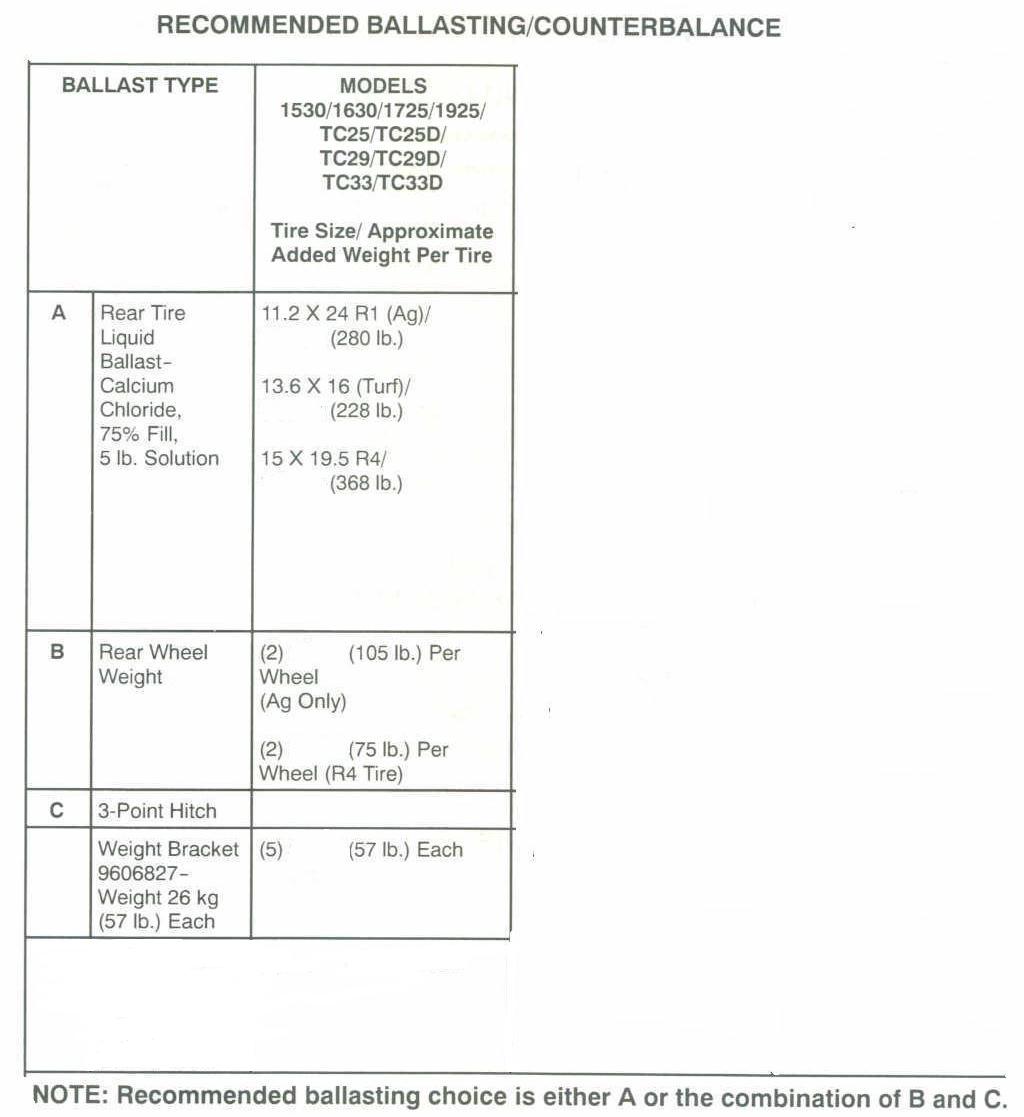

Now, back to my original question about ballast. I'm attaching a scan of part of page 41 in the 7308 manual. I have R4 tires. I think they are saying that if I don't have the tires loaded then I need both the 300lbs of rear wheel weights AND 5 of the 57lbs weights (285lbs) on the 3pt for a total of 585lbs minimum for safe operation of the FEL. Is that right?

I think it's A (368#) OR B (300#) OR C (285#). The 285# on the 3 pt hitch is probably the rough equivalent of the wheel-located weights because it's further back and has more leverage. On the other hand, I'm most comfortable when I have the box blade on the 3 pt. hitch, and I have loaded tires. You can't have too much ballast, in my opinion.

Now to the ballast question. <font color="blue"> I need both the 300lbs of rear wheel weights AND 5 of the 57lbs weights </font>
It does appear that thats what their saying. If you look at the note at the bottom of the page it says <font color="red">"Recommended ballasting choice is either A or a combination of B and C.</font>
With loaded tires you would add a total of 736 lbs. To equal that you would need both the Wheel Weights (300 lbs) and Hitch Weights (285 lbs) at 585 lbs. That equates to the combination being about 80% as heavy as the loaded tires and with the extended leverage of the 3ph I would say that it sounds about right.
I personally don't use the wheel weights. In the few instances where I need ballast I will either pick up the mower (700 lbs) or the Disc (600 lbs) and have thus far never had a problem.
