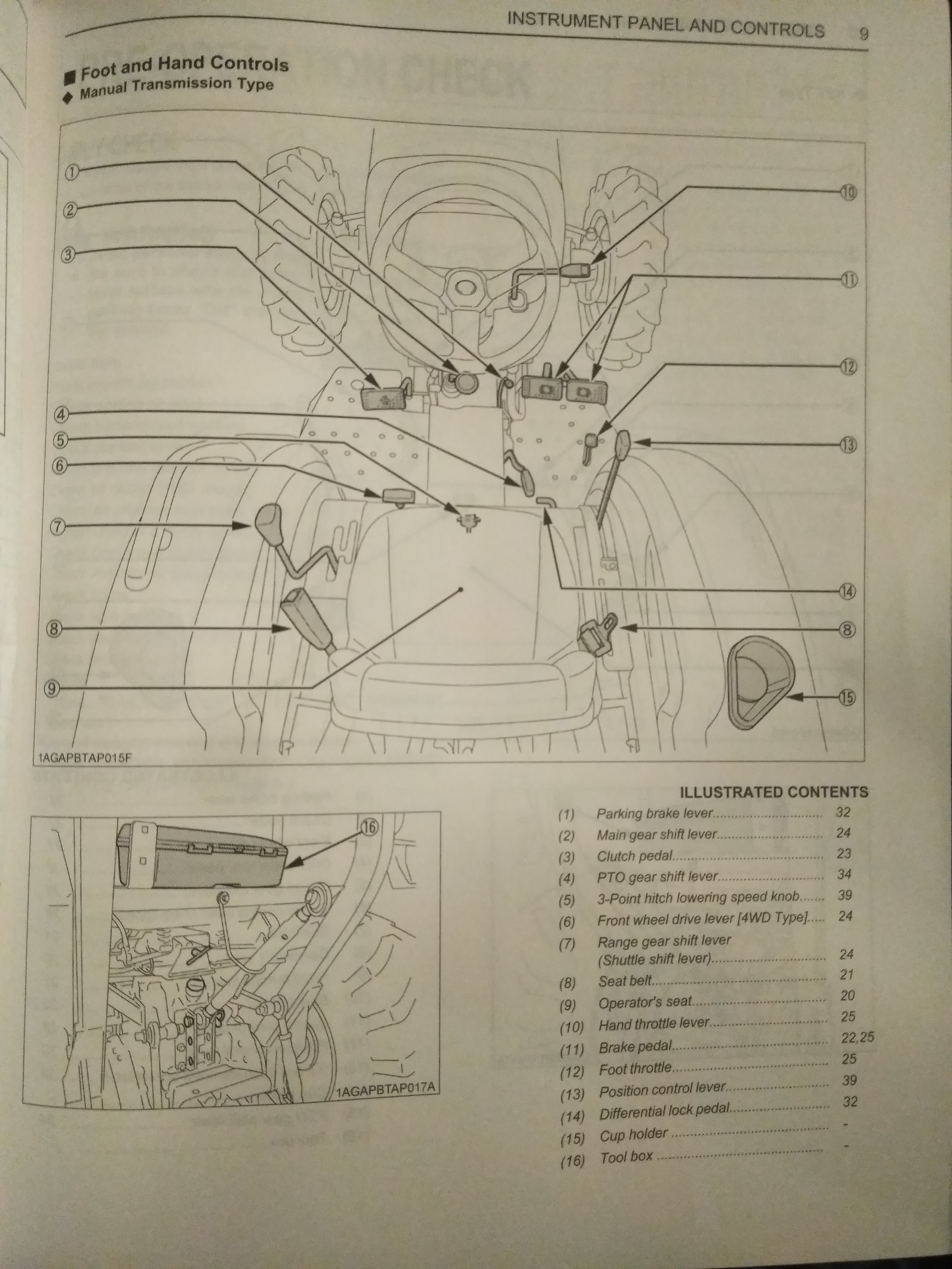

You can see #7 is my shuttle shift lever. No clutch is needed
   / Good write up on Kubota transmission offerings #7
Shuttle shift needs clutch. Hydraulic shuttle shift, often found in tractors over 60/70 HP, doesn't need clutch to change directions, only to change gears.
If you try to do it without clutch on your tractor, you won't like the sound of it. Don't try it by the way.
   / Good write up on Kubota transmission offerings #8
If you shift that range selector without the clutch it will be interesting to see if Kubota warranties the damage. Normally it'd be operator error but you might have an argument because it was mis-labeled on the diagram.
   / Good write up on Kubota transmission offerings #9
Your tractor is a DT. You should be using the clutch for any and all speed or direction change.
On hydraulic shuttle models, the shuttle lever is on the steering column where your throttle lever is.
