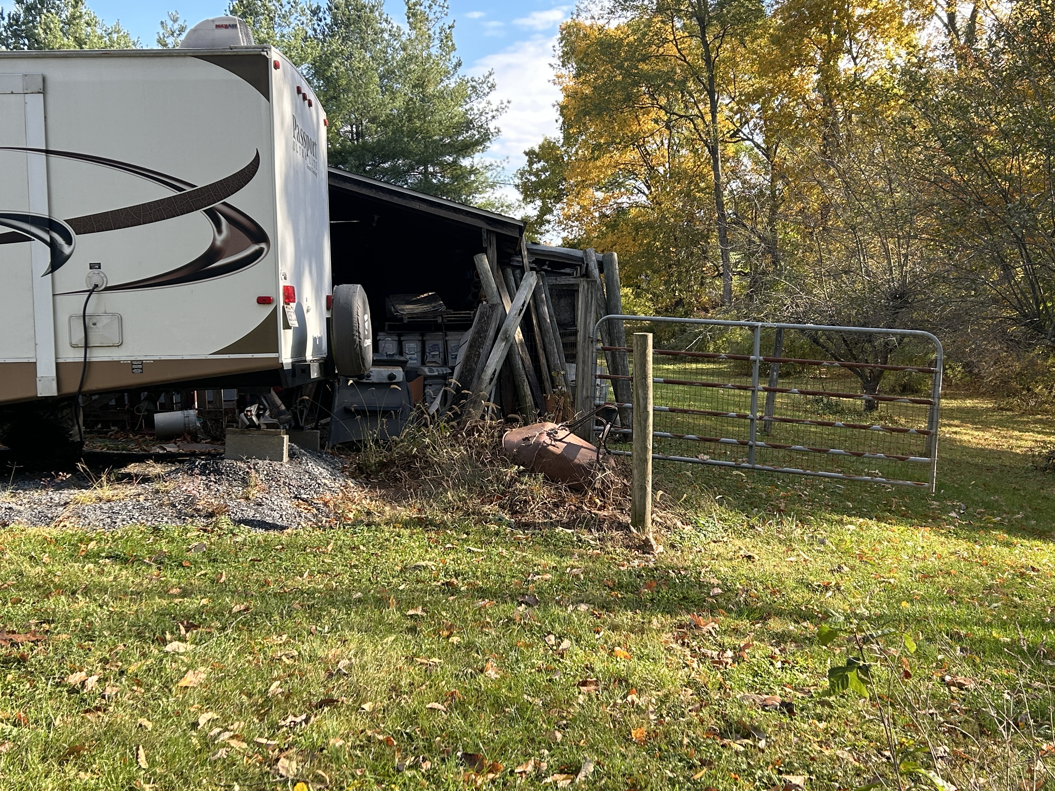

Camper about 13 ft in front of shed, then need a couple feet in front.., so back needs to go about to where the end of the open gate is (the gate without a fence) to make the front flush.
That is the shed I just resided, and it still has some junk in it, mostly old lumber, the old husqvarna lawn tractor, buckets of sand, air compressor, more junk... I cleaned a lot of it out when I resided the shed. This is also the shed I was going to move a few years ago (I have a thread about it) but never did, because of the lean to attached to the back with more junk under it, like old double hung windows I was going to use in a barn (but didn't), parts to a 24 ft above ground pool, 2 old bikes, more buckets of sand, few old rotors, snakes and bee nests, and ground hog holes under everything... Originally I parked the L3130 under it years ago, and used to keep the massey in the shed. Last night I lay in bed thinking again about moving the shed.....
so I estimated about a 3-4 foot fill required to bring the far back side up to grade. Could get the laser out and check it.
course I would also want to extend a septic line from the back of the house, bring a water line out, and it just keeps getting more and more expensive.....
saw several sprouting acorns laying under the oak, so threw a couple sprouting ones in a hole. That oak tree was grown from a sprouting acorn I put in some mulch, unfortunately should go if i put another barn where camper is...

If you put fill out to where the opening end of the gate is in the picture, that would take probably 6 18 ton loads of pitrun/bank run gravel, plus your retaining wall. Then add the 3/4" clear stone on top AFTER you pack the pitrun. That looks like 3/4 clear you are parked on now. Clear stone is washed stone, same thing.
Do you have a concrete company near you? If yes then talk to them about retaining wall blocks.
Here is a link to the concrete supplier I use in Ontario, Canada. I'm sure you can find one down there.
https://www.brooklin.com/wp-content/uploads/2025/06/Landmark-Product-Guide.pdf

If i fill, I would just make a bank off the back side, no wall. If I go with wall, then I'd build as a garage, with footer, poured wall, etc.. but that is too much money to put into it. Just a wild dream at this point.
