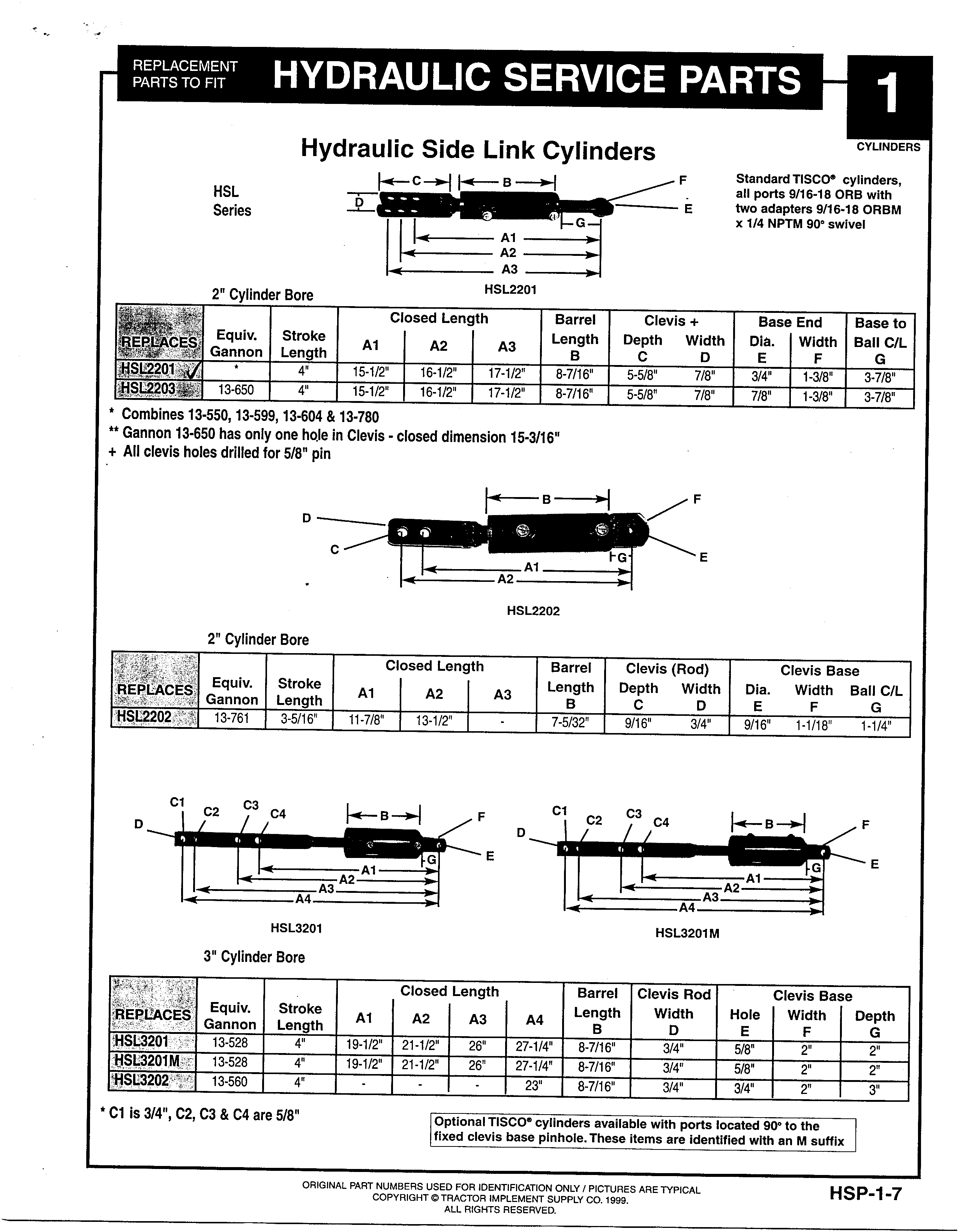

For background, I'm inflicting this project on a B2910. The objective is to get a hydraulic top link and one side link. First thing I did was measure out the length of my manual links in both their open and closed positions. All measurements are pin center to pin center.
Top link: Closed - 17"; open - 27"; Cat 1 swivel balls on both ends. To make an exact replica I would need something with Cat 1 balls on both ends that is 17" closed with a 10" stroke.
Side link: Closed - 14 1/2", open - 18 1/2", 16 1/2" matches fixed link length, clevis on both ends. Both clevis ends are at angles to the rod, so angles would have to be replicated. This one would ideally be 14 1/2" closed with a 4" stroke.
Armed with this I started shopping. First thing I did was look into ready-made kits and parts and abandoned both because the parts were not really the right size or they were way over priced. Details are....

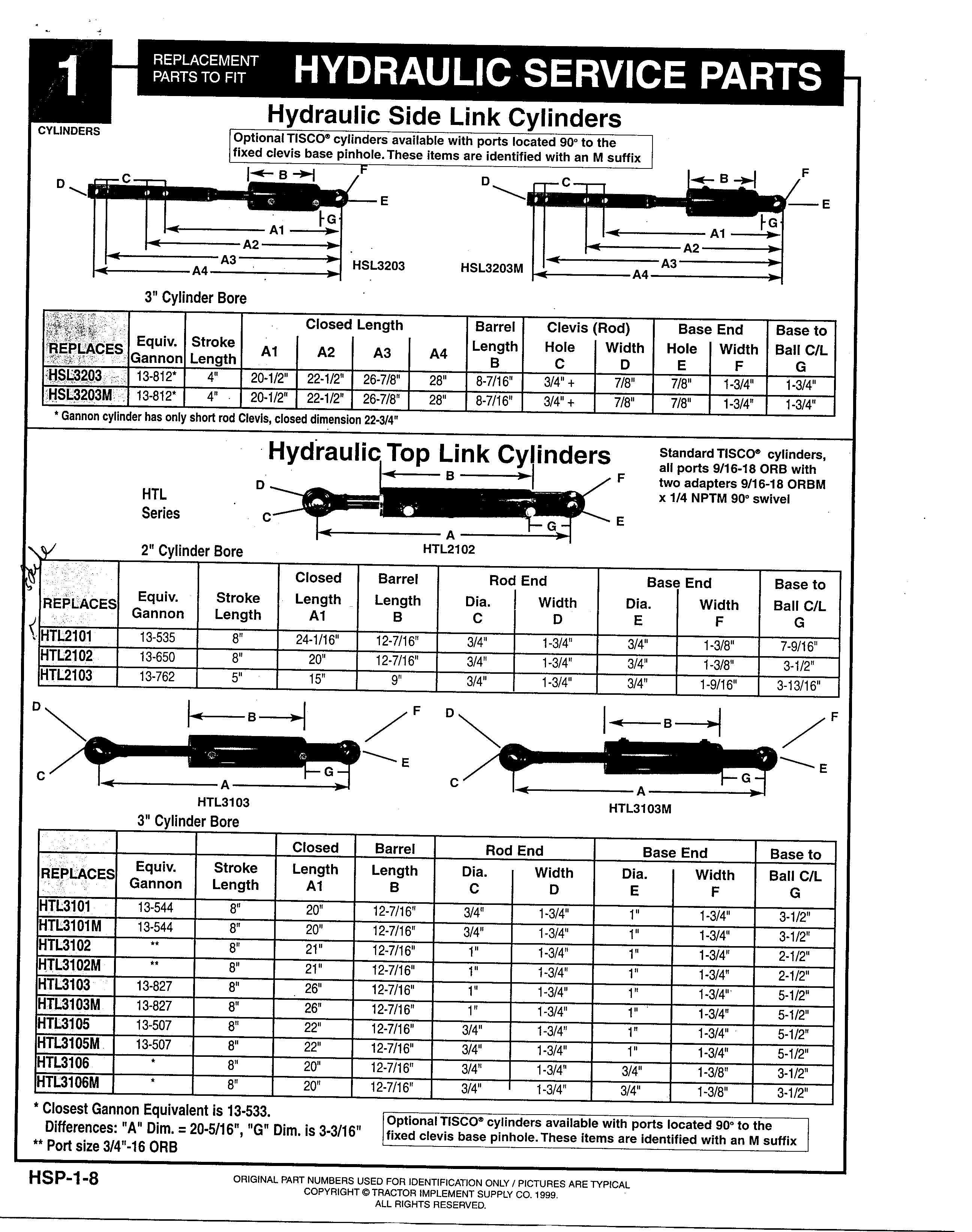

My local dealer carries Tisco parts, and they make a line of top and side links with a variety of sizes and end configuations. I got copies of the catalog pages and browsed through and found nothing that would really work. They were either too long or too short for the top link, and the side links were either the wrong length, had the wrong type of ends, or were straight not angled ends. I'll post scans of the pages for reference. It looked like they had stuff that would work on the L series.

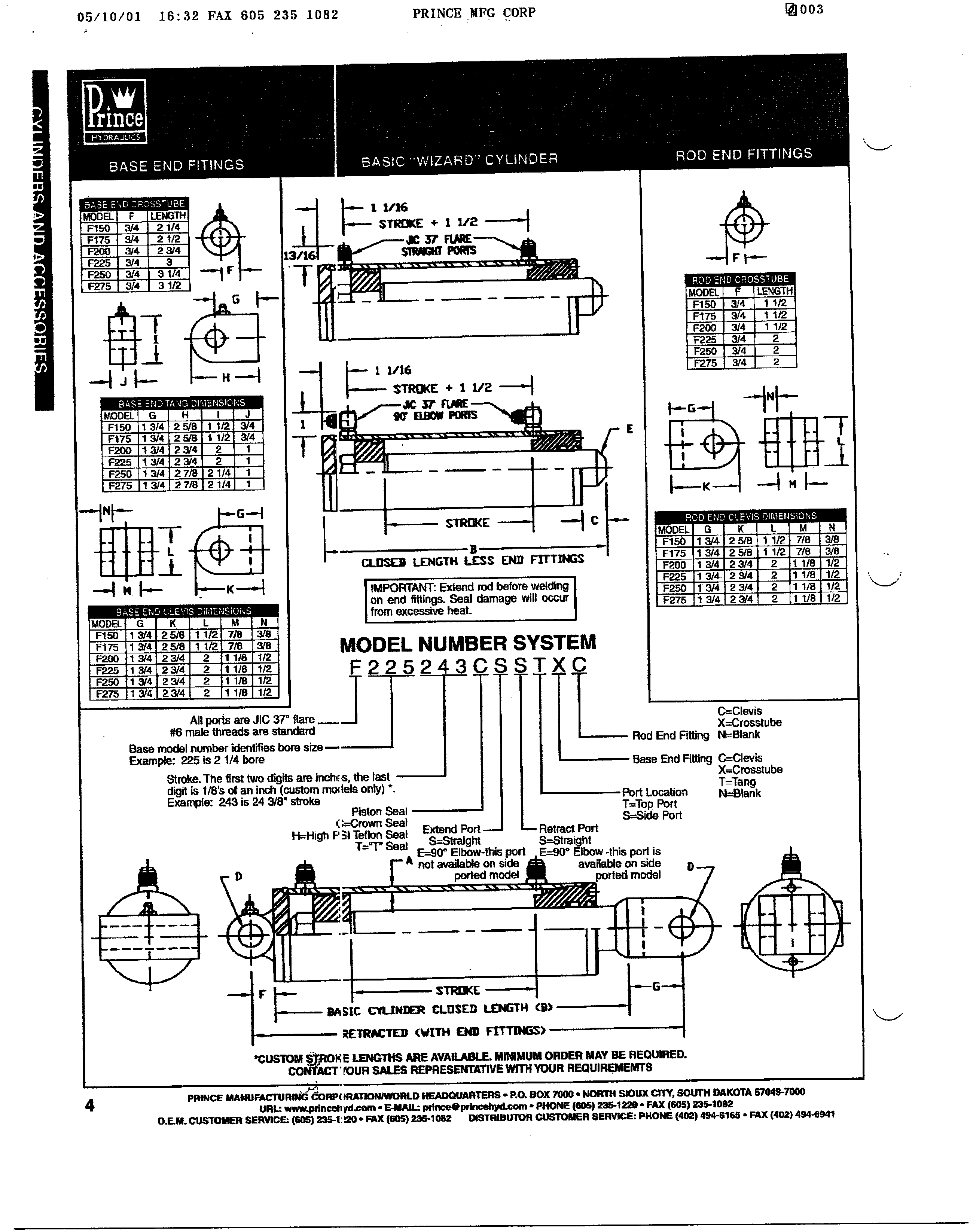

On the cylinders, I called a local hydraulic sales/repair shop and found a very helpful fellow who pointed me at Prince's "Wizard" line of cylinders since it's available with blank ends so you can weld on whatever you want. I then called Prince and they were extreemly helpful. The guy faxed me spec sheets, dimensions, etc on the wizard line and concurred it was the line to use. I'll post these as well.
Plowing through yielded two cylinders, one 2x4, and one 2x8 that would serve as the base cylinders. Ideally the top link would have been a 2x10 to get the full desired stroke, but the length of that cyl closed was too long to meet the 17" closed length of the overall top link. I ordered them yesterday. Total cost about $250 delivered for both.

Tisco Page 1
Tisco Page 1 of 2

   / Going down the Top N Tilt path
Tisco Page 2
Tisco Page 2 of 2

Peter, sounds to me like you're going at it the right way. I think that'll be better than the Tisco cylinders I got (I just have 3.5" stroke on the side link cylinder and I had to shorten both ends of the top cylinder and add a bracket to the side link cylinder - it was angled on the bottom end but straight on the top end). I think you've got a good handle on what you're doing. Good luck with it, and I know you'll like it.

Prince page 1 of 3
Prince page 2 of 3
