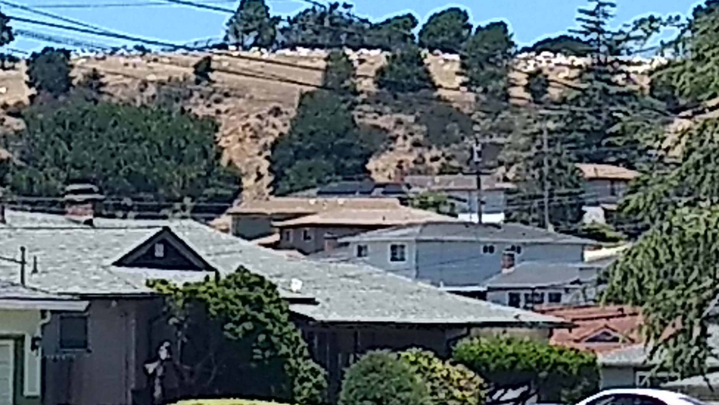

Several hundred grazing right now doing fire suppression as I look out the window.
Professional contract for many years.
Single strand hot wire on rebar posts moved every other day or so.
The secret is two herding dogs... Dogs don't miss a thing and goats 100% compliant.
It's amazing two dogs can control several hundred goats with a single hot wire on a solar battery back up charger.
One caution is several brush fires started in high danger area from arcing sparks.
