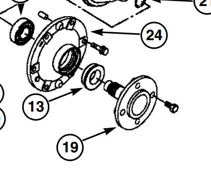

Hello, I am looking for the torque specs for the front wheel hubs. I will be replacing the oil seal and would like to do this properly. Any information would help. Thank you.

you talking about seal #13 here?

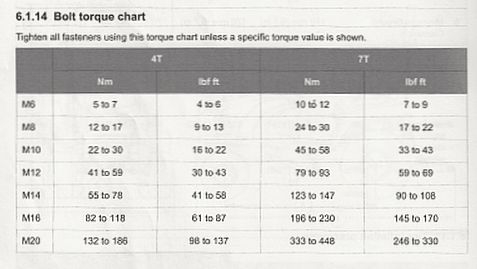

so far have not found tq spec in GC2400 service manual.
however manual gives tq specs per bolt size
  • tq_charts.pdf

   / GC2600 Torque Specs #5
Use chart in user manual and find bolt size and set torque wrench appropriately.... From GC17XX user manual.... Probably identical chart in GC2600 user manual...
