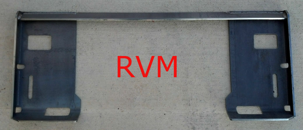

ssqa adaptor.jpgI have a pin on bucket now, and I am thing of buying the ssqa for the loader and converting the bucket I found the pictured bracket but not a 100% sure it will work does anyone have any insight into this. they say it is 45" wide by 18 tall.

View attachment 625102I have a pin on bucket now, and I am thing of buying the ssqa for the loader and converting the bucket I found the pictured bracket but not a 100% sure it will work does anyone have any insight into this. they say it is 45" wide by 18 tall.

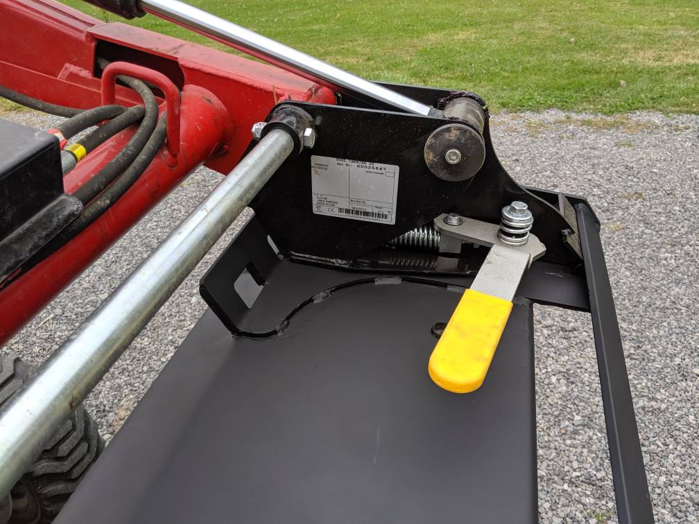

Universal quick attack/skid steer quick attack is a universal standard to you're fine there. If that's only 45" wide you'll be fine as it'll fit inside the outer edges of your factory pin on bucket. Just cut off the factory ears flush with the bucket so you get a nice flat surface to weld to. I can provide pictures with measurements if you need to know how high to mount the plate. It will stick up over the bucket back.IMG_20190901_145726.jpg

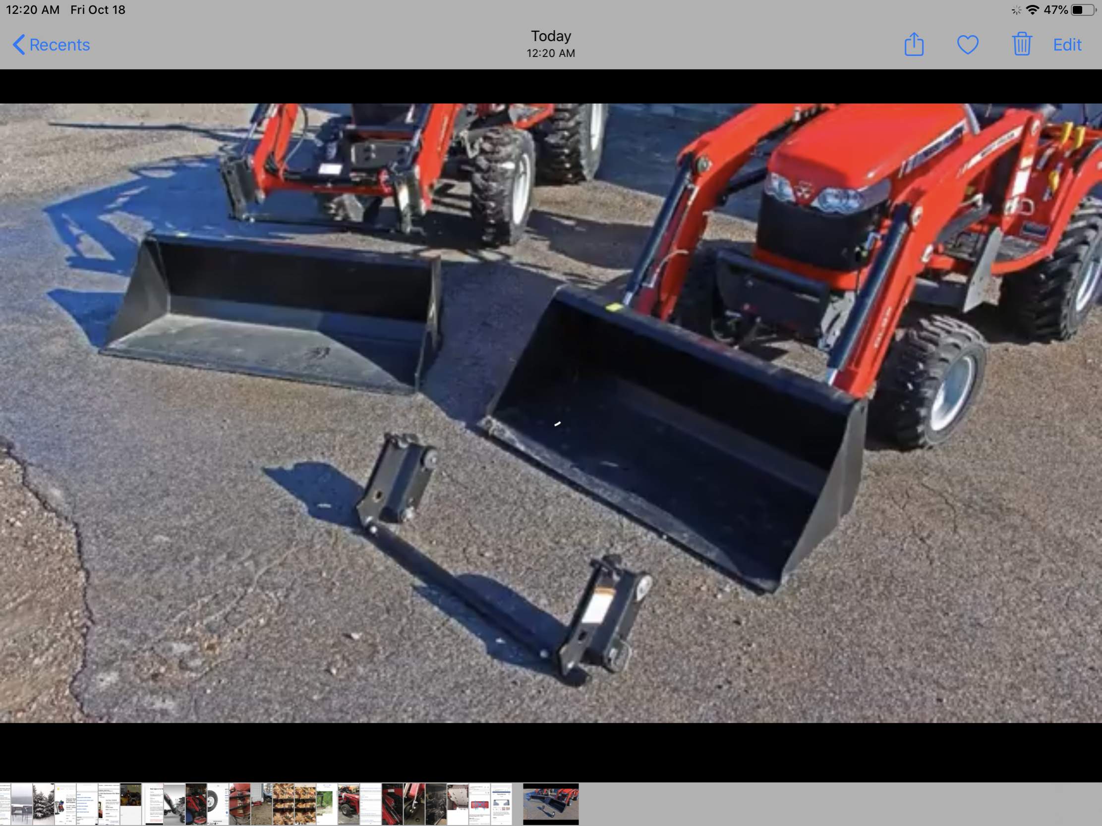

First I need to get the right ssqa for the GC FEL, the one from MF I found uses the pins to attach and I would rather have the lever on each side like you have on your DL95 it would give more attachment options then the one from Massey/AGCO or at least the one I seen.
I am going to the dealer tomorrow where I bought my 1705 and I will find out what he can do for a price, he has tried to get ahold of me a few times to see how I like my scut but I would rather talk right to him plus I want to see about a valve for the front end for a grapple set up and see what he has on his lot heeheehee.
I just found the ssqa setup, man I must of been sleeping the 1st time so ya I am good.
