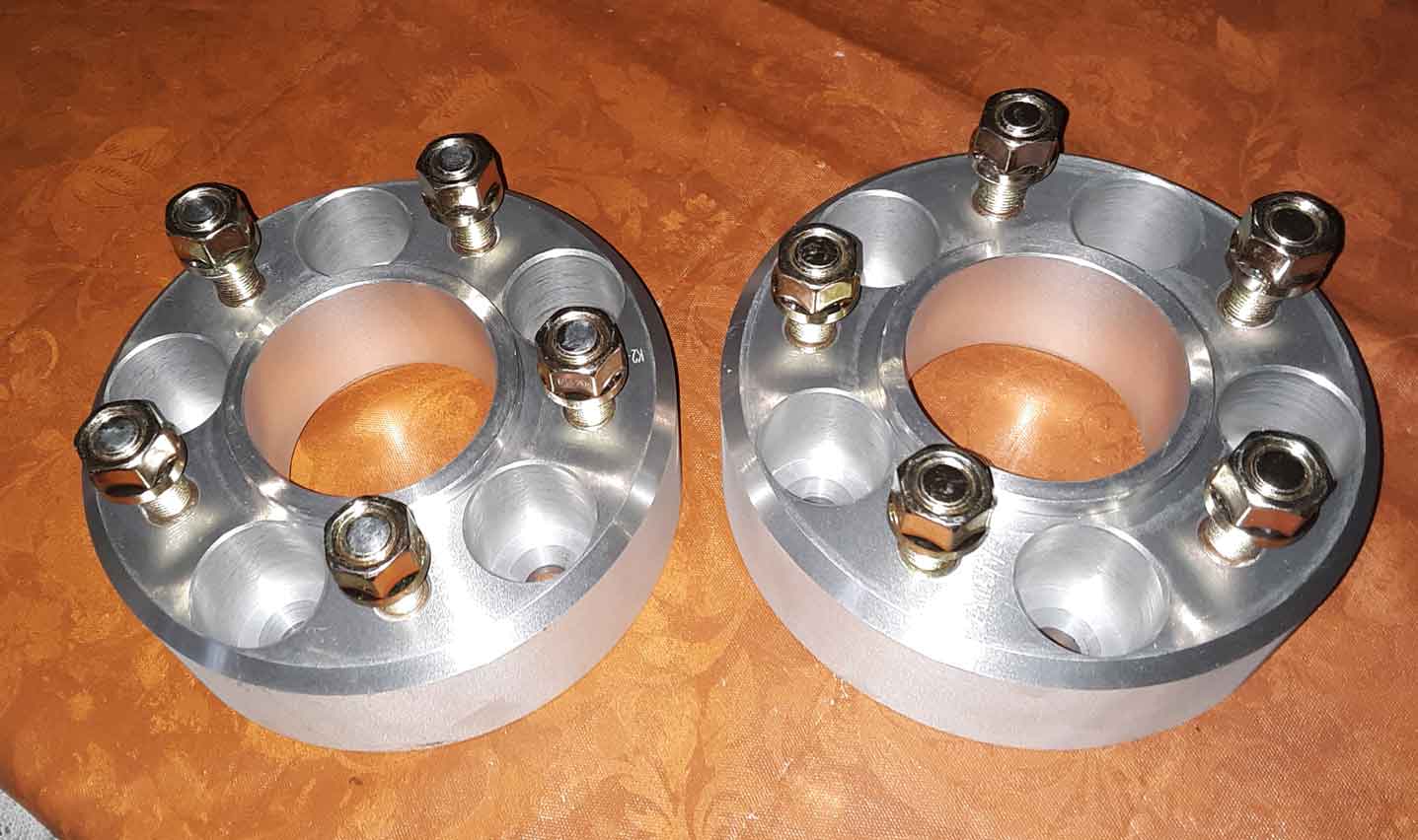

About the spacers.... Stuff a bit of hose or what ever in socket so bolts can not bottom out in socket, you want about 1/32 to 1/16 or so of head (hex portion) showing below socket.... The reason is IF you let bolts bottom out in socket it lets socket go to deep into hole and it will bind as you bring bolts up to to torque.... Been there, done that, no "T" shirt....

Thanks, I will keep that in mind. I did contact Richard at Bro-Teck about the need for a thin walled socket because I read many threads here about these spacers before I made my purchase and there was mention of needing a thin walled socket. He told me that there have been some recent design changes that removed this need.
   / GC1700 Rear Jack Stand Placement #14
I did not need a thin wall socket, but discovered the depth of bolt head in socket to be critical... Maybe with newer design my solution does not apply.... Torqueing first bolt will tell....

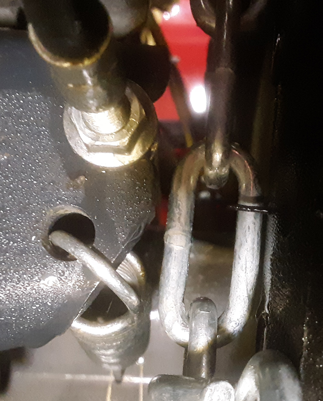

While stability will be improved and it is a plus because I live on the side of a hill the main reason I want the spacers right now is this chain-clearance.jpg Only having 1/8th of an inch clearance is not something I feel comfortable with.
If I knew that swapping the tires would not be effective on this tractor I would have ordered the spacers a week before I did.
I am still unhappy that the dealer/shop even recommended it because they should be well aware of the fact the flipping the wheels on a GC17XX would not help.

I did not think to measure the rims at the time. Partly my own fault. When I saw I only had 1/8th inch clearance with the chains on I called the dealer. I asked about wheel spacers because I'd read a couple of comments about them, but they said these were not available for this tractor and that they suggested I swap the wheels. I assumed that they knew what they were talking about. When they brought it back it was raining so I did not check it at the time. It was the next day that I measured and saw that it gained me less than 1/4 inch of additional clearance. That's when I started seriously looking into the spacers and ordered a pair from Bro-Tek. They are sitting on my kitchen table now waiting for tomorrow's adventure.
