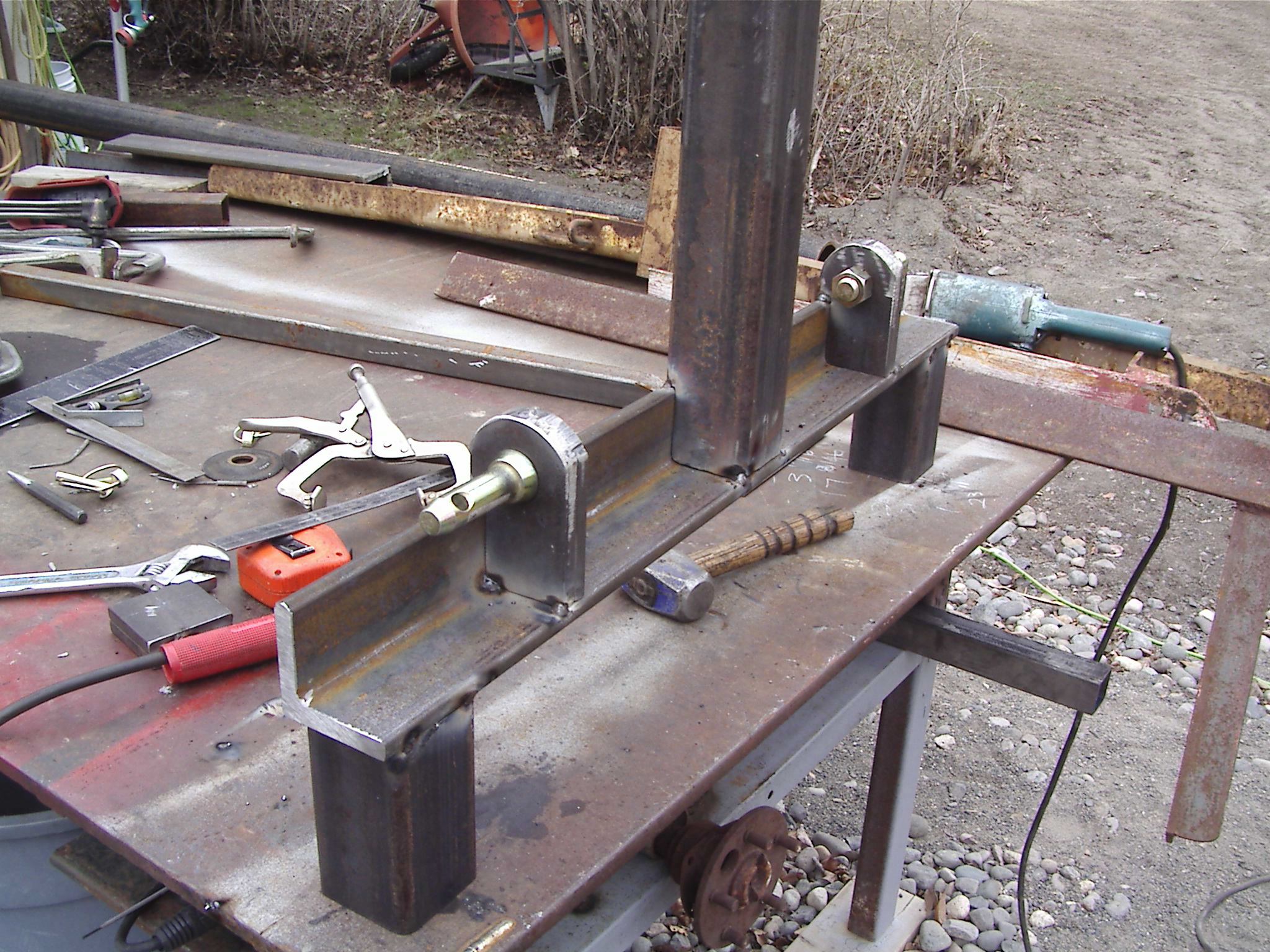

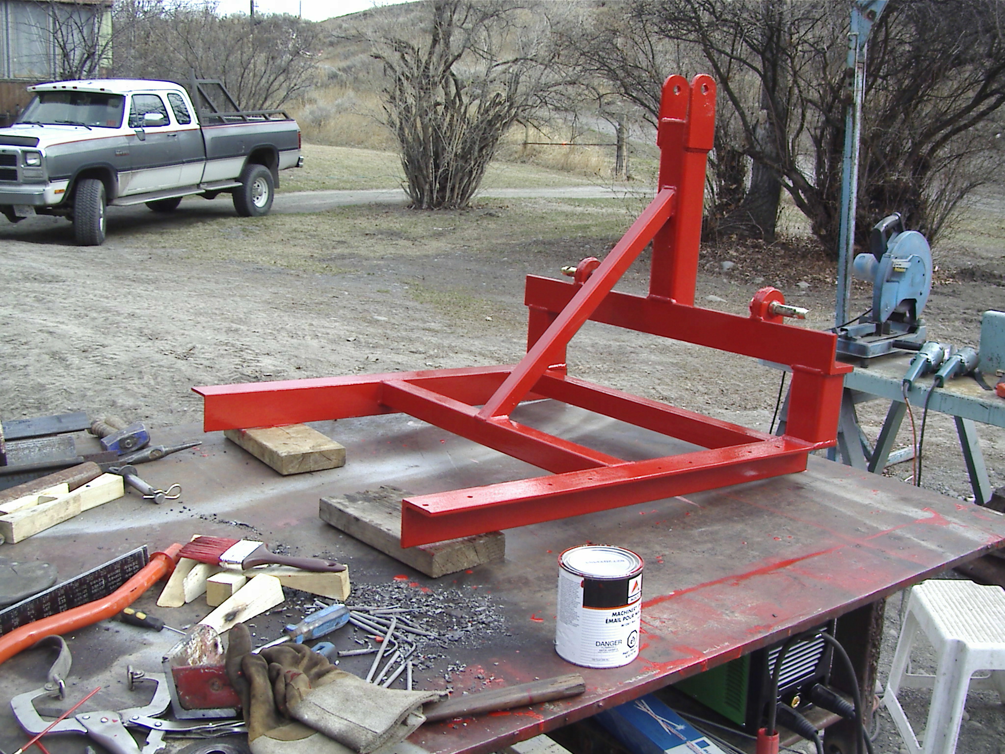

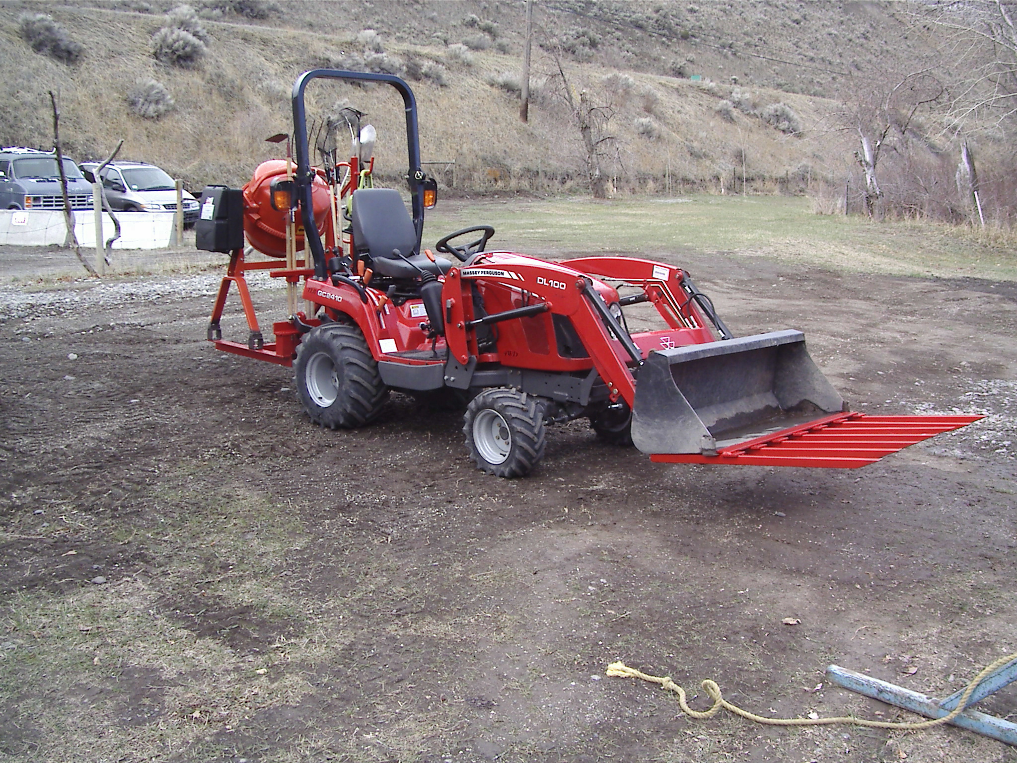

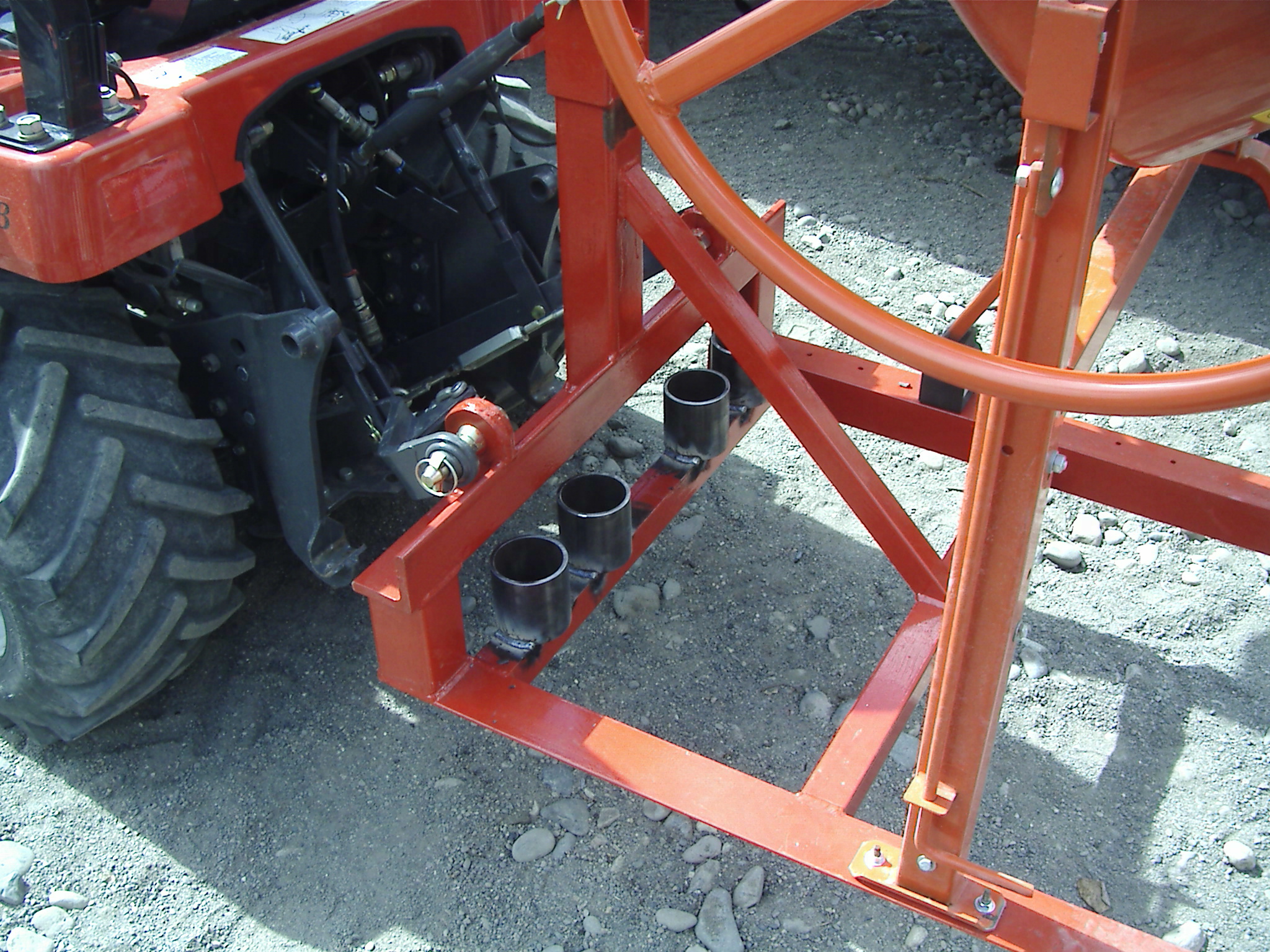

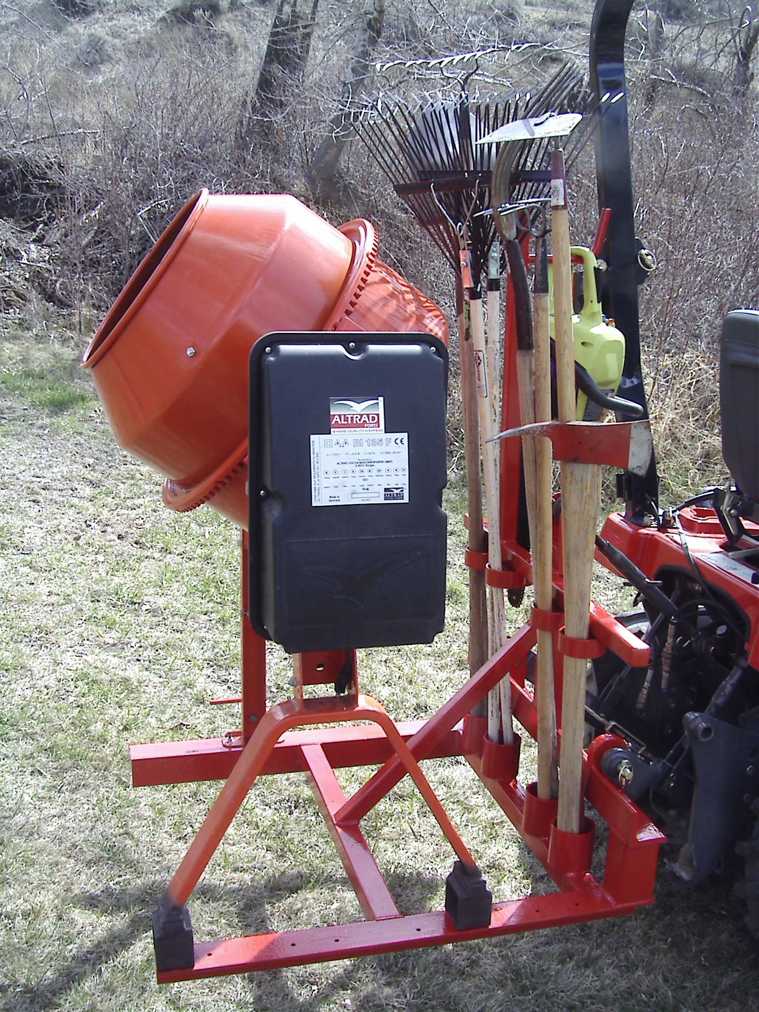

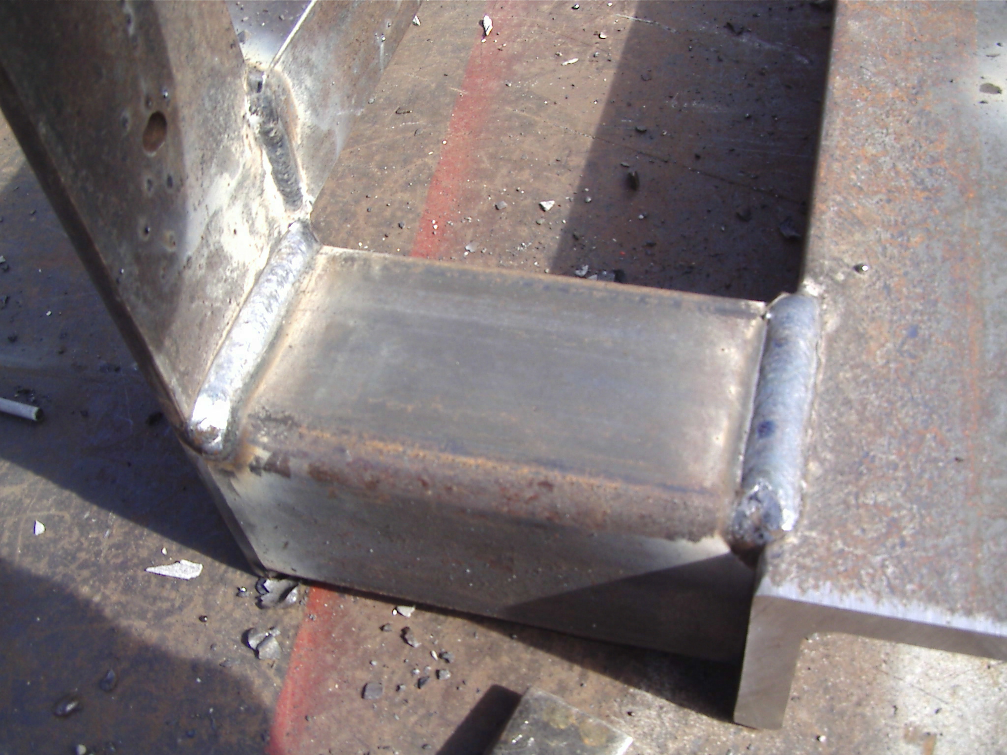

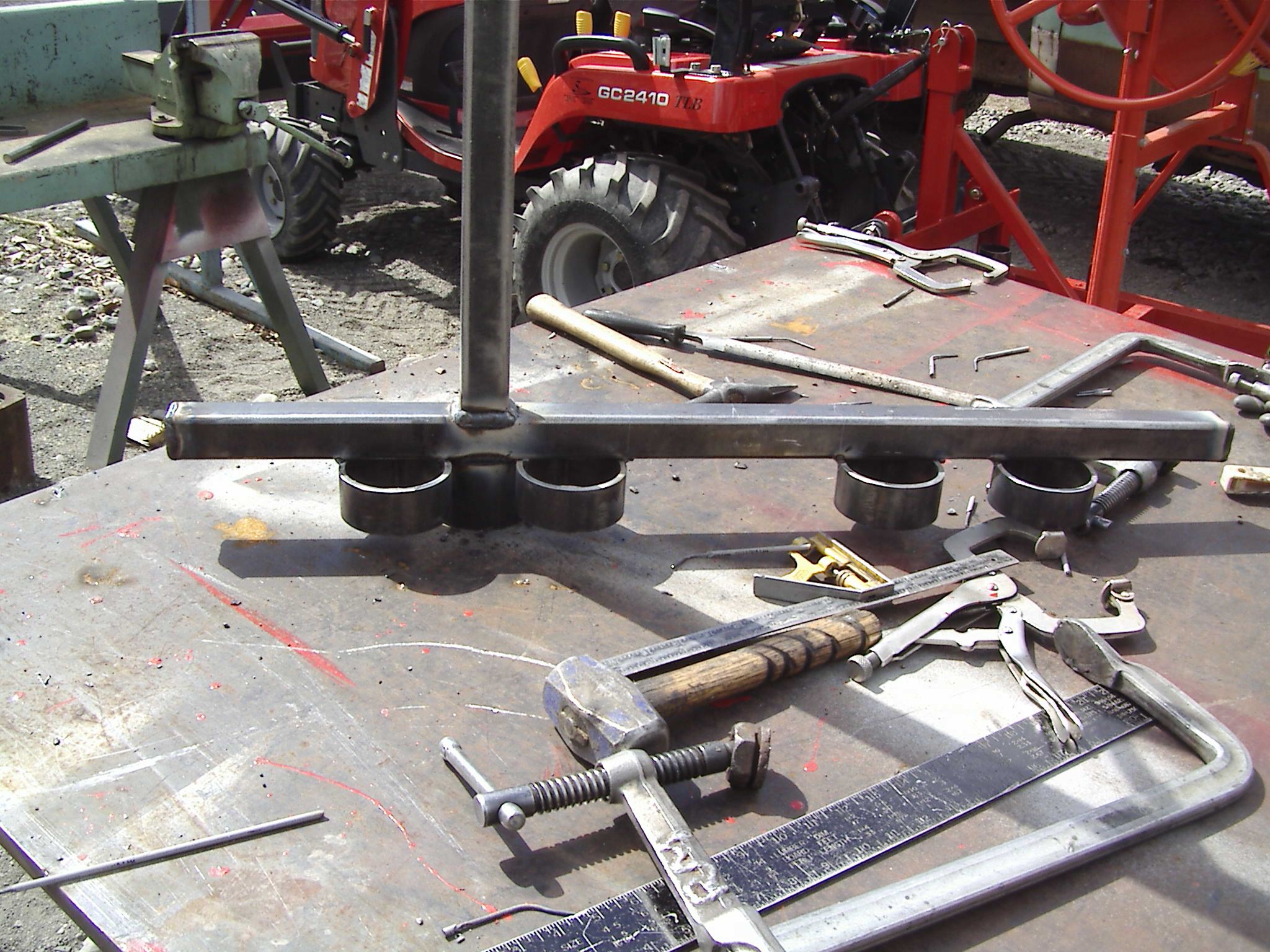

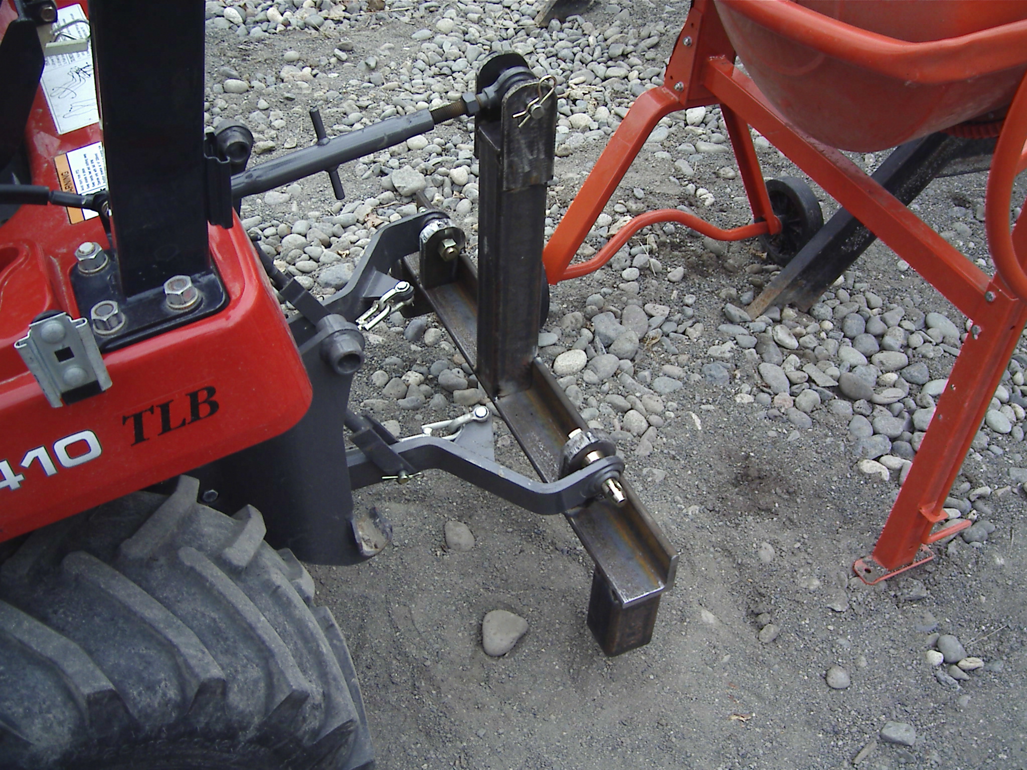

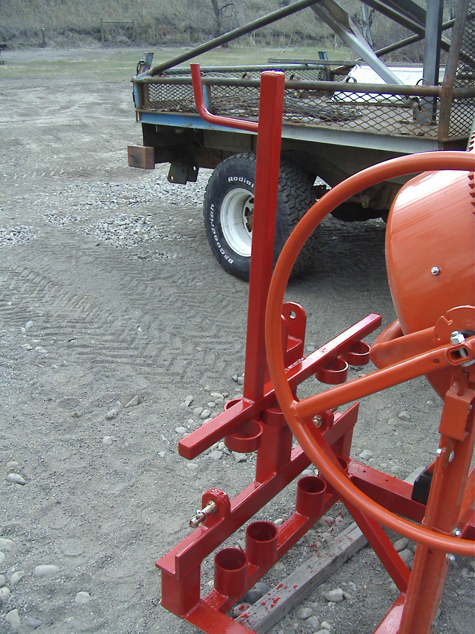

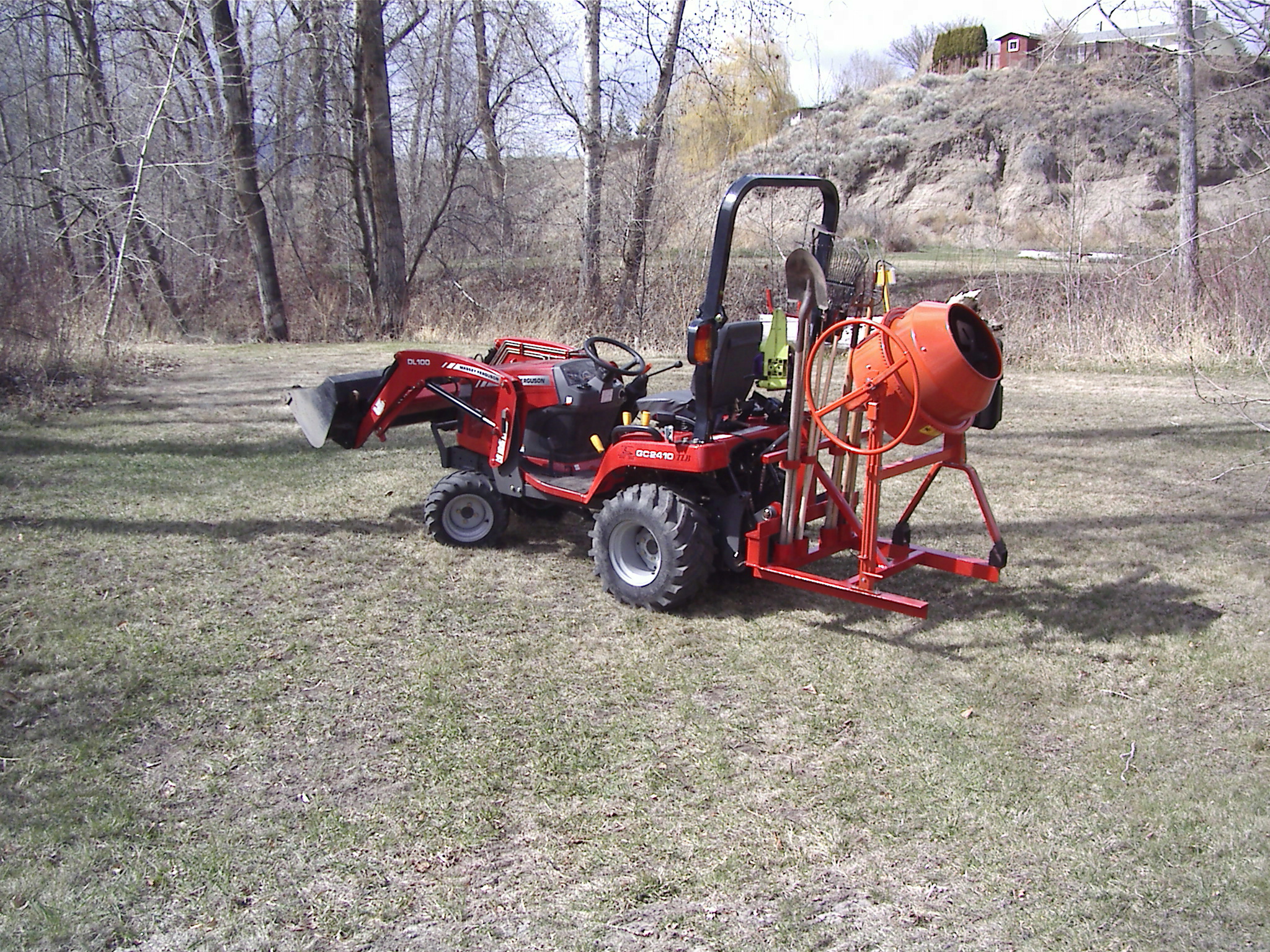

I posted a picture of this about 5 years ago and noticed it had over a thousand views but no comments. I called it a tool tote but things have worked out differently.
I really only use it for mixing cement, but it has proven very handy for that. I can have a dump truck deliver the navijack at an easy to get at location, use that for my mixing area, and then deliver concrete to anywhere on my property.
there are 3 point mixers that run on pto power, but far as I know they quit turning when you go to dump them. probably something to do with u joint binding. anyways, with this setup the mixer keeps turning while you are dumping the concrete, a definite plus.
power comes from a small generator that has 2x2 hss welded in 4 spots on the frame such that it slides onto the forks and stays put.
video of it working here. carport slab - YouTube
