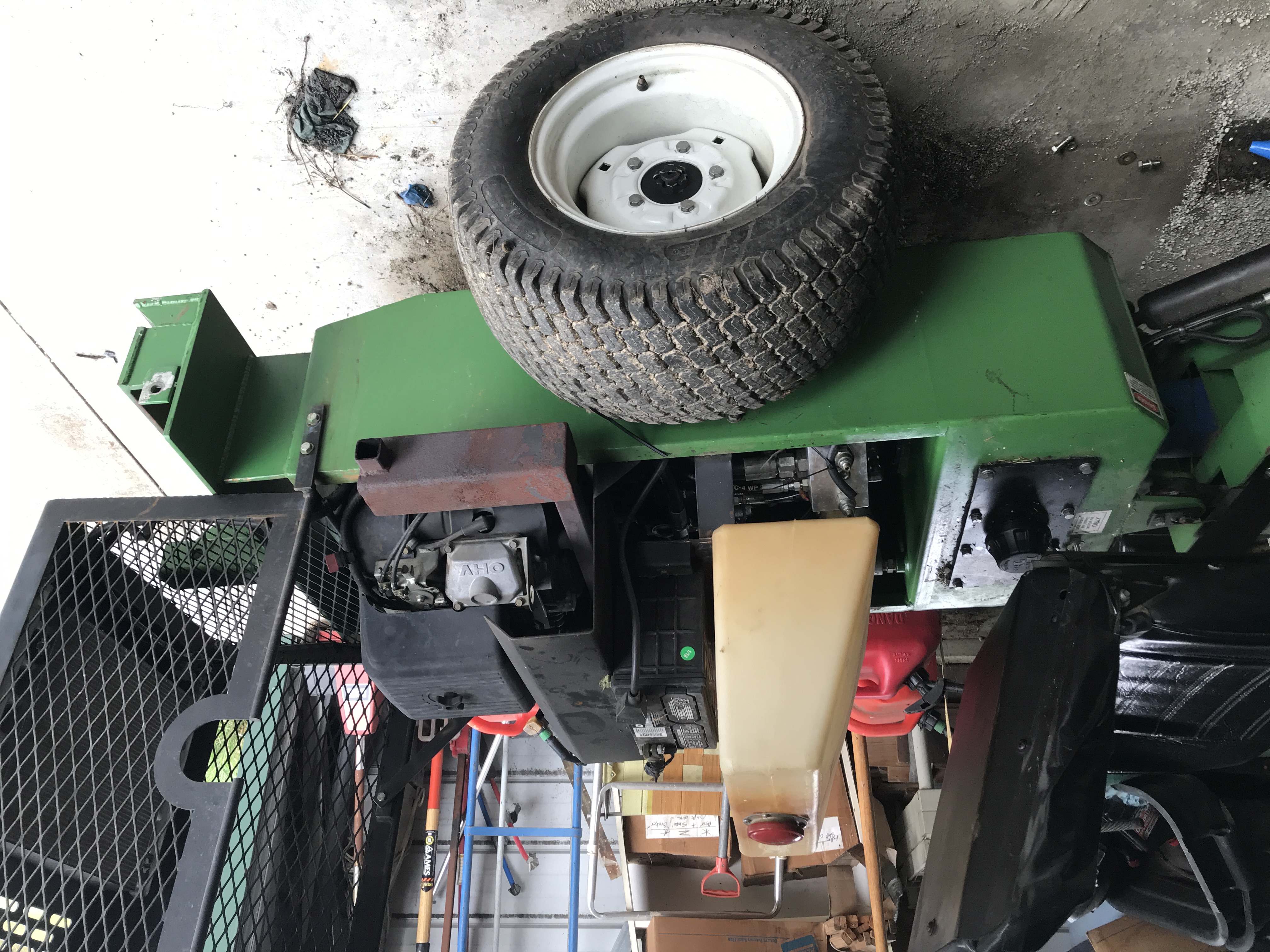

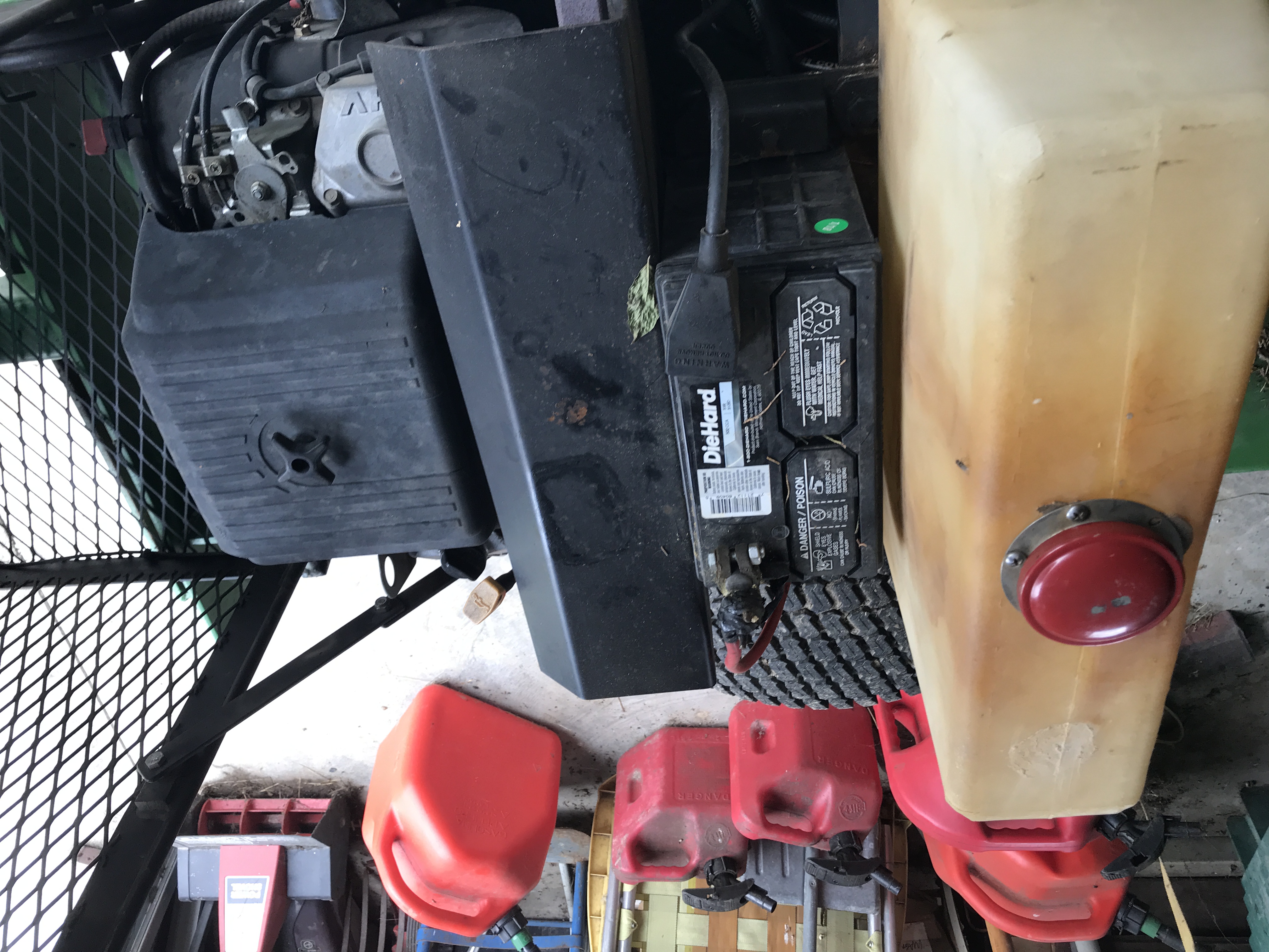

Here is that 4 gallon tank on my PT422 (yes, past due for a bath).
The problem is that the aft end of the tank is too close to the exhaust manifold. I had to scrap PT's heat shield (and the stock gas tank mounts) and make my own, and still would like it to be at least 1/2" further away. Also the valve cap is non-venting, so the tank required another vent.
In retrospect, I should have paid them to build me a tank shaped closer to PT's tank, but this one really seemed like it would fit better than it does. Been using it for at least two years now.

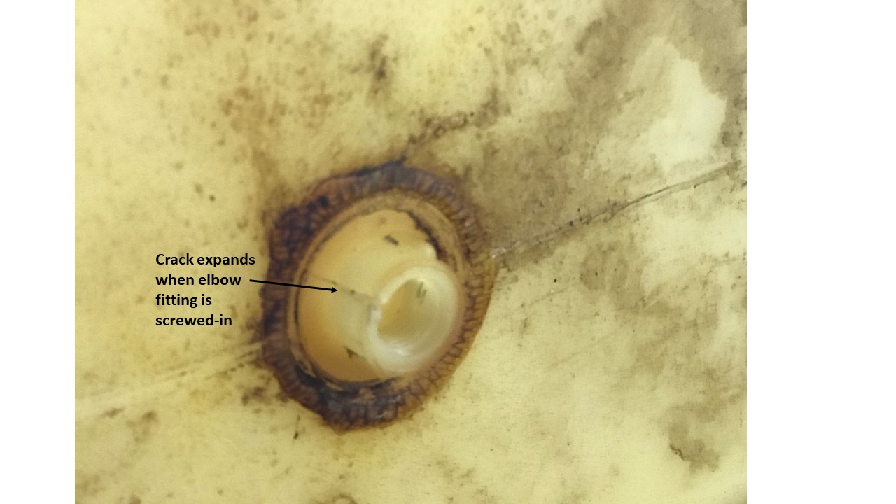

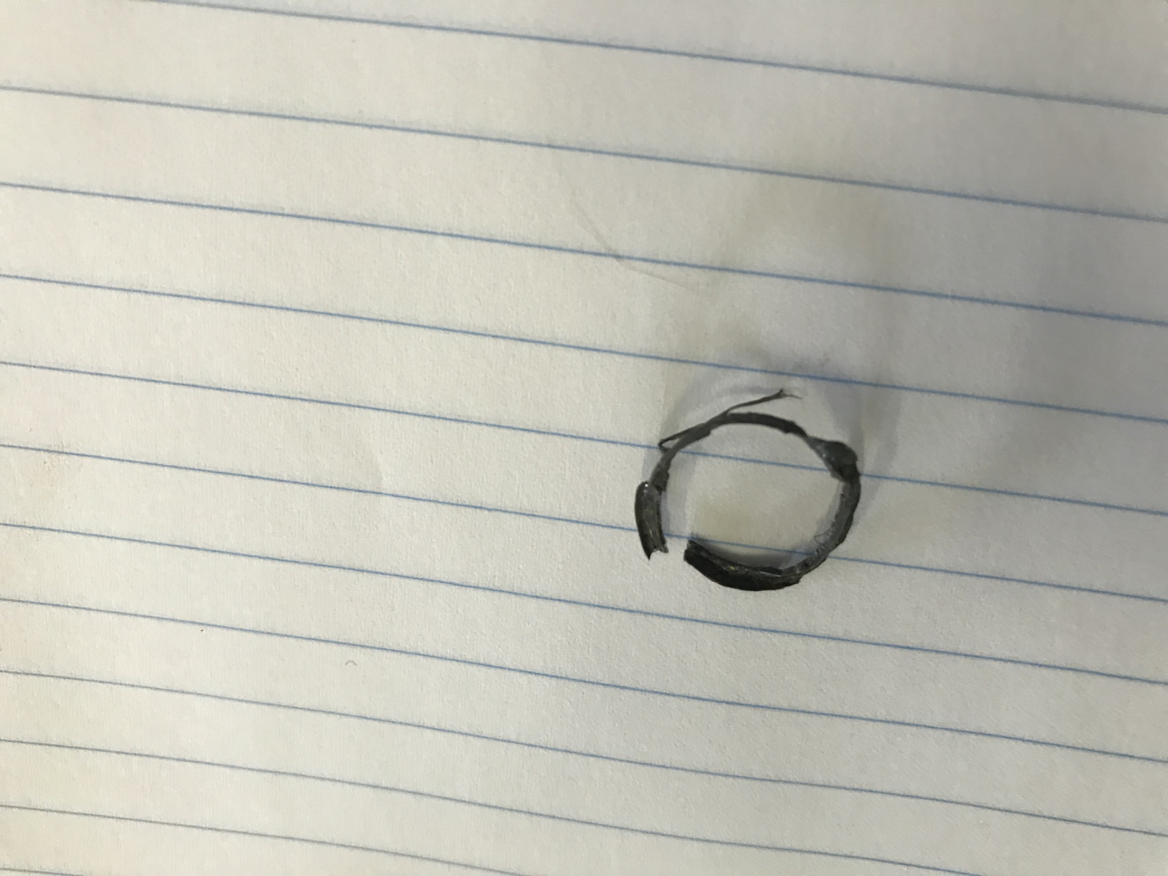

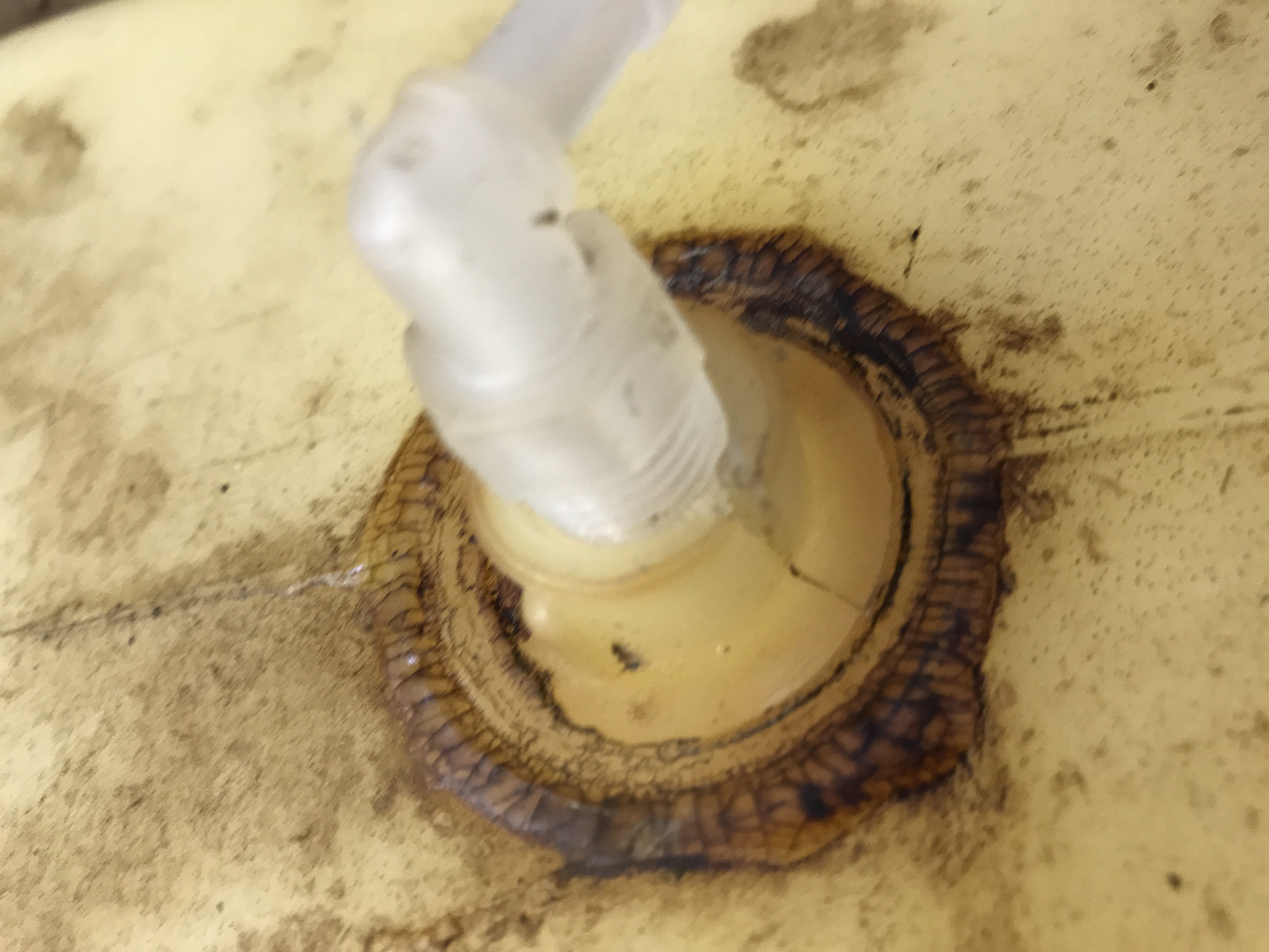

The crack in in the bottom nipple that holds the elbow fitting. The crack gets bigger as the fitting is screwed-in. Note the remnants of an o-ring.

Great photos, given the many small cracks in the plastic welds in the tank, I would be thinking about a new one, rather than trying to repair this one.
Just my $.02.
All the best,
Peter
   / Fuel Leak after Factory Repair #38
Well that plastic crack does not look like it is part of the tank but rather just a plastic plug reducer. Mine started to crack long ago so I put a screw type clamp on it to keep it from getting bigger. It has been on there for at least 5 years. Works great and no leaks but it does look a littler different than yours. I even have a brass fitting on mine from the factory. If you were going to replace the tank anyway what do you have to lose but just drill it out and go get some plastic or brass pipe fittings to put back in it and see what happens. It might be glued in but glue doesn't last forever. I would do that first before I did anything. You got a hometown hardware store? If you're not to familiar with fittings those guys would fix you up. If replacing with plastic make sure it is for a petrolium product or it will just melt through. That fitting looks in line with the gas cap so with some long sockets you might be able to get some type of compressing fitting on it and tighten it up. Just my 2 cents.
   / Fuel Leak after Factory Repair #39
I might be wrong but I am not sure that is the right elbow for that coupling. It almost looks like it is supposed to just tighten enough for the o-ring to do the sealing, if that is where that o-ring came from... It looks like a pipe thread elbow and a coupler that seals with an o-ring. The tapered pipe fitting stressed the straight thread coupling. Therefore it shouldn't need any sealant, but a little sealant seldom hurts anything.
