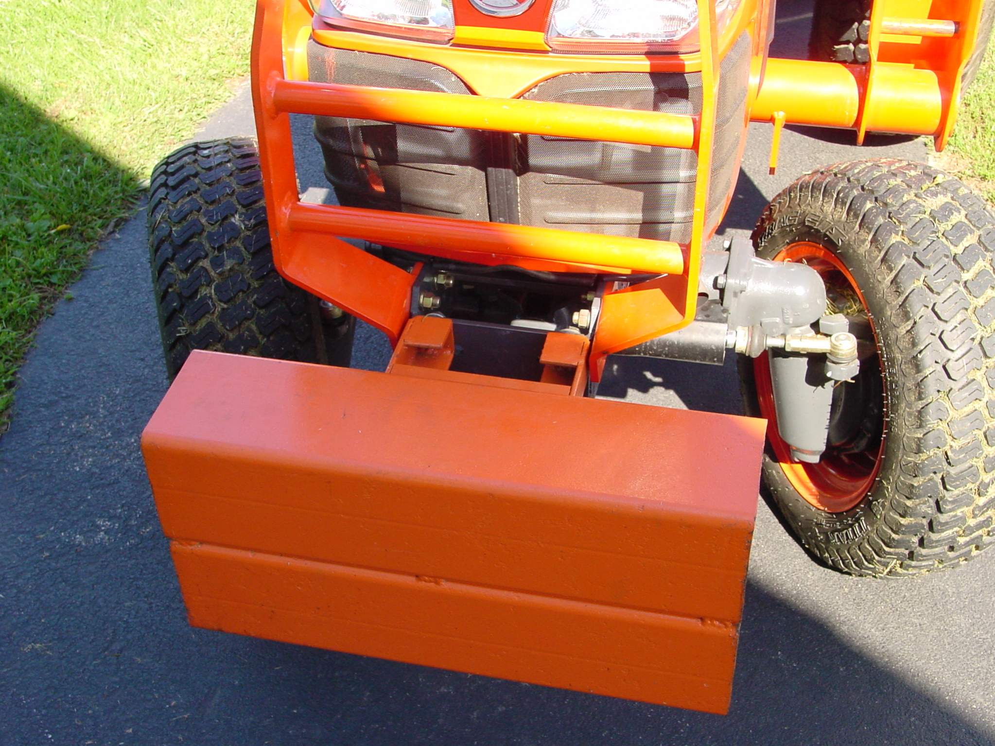

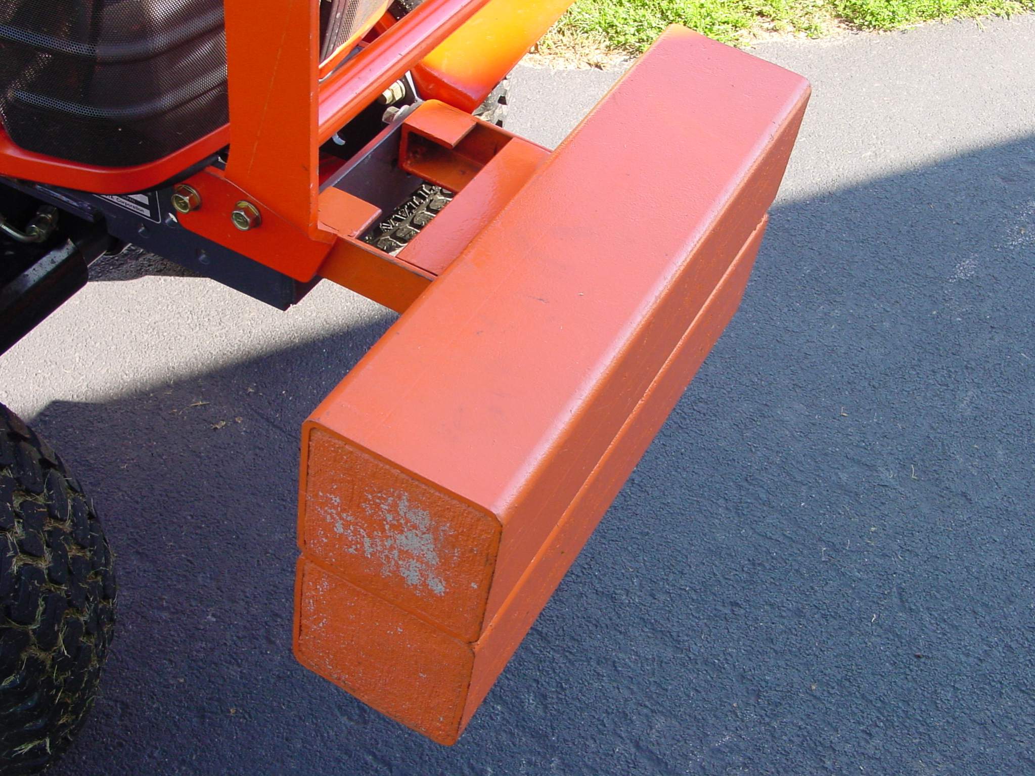

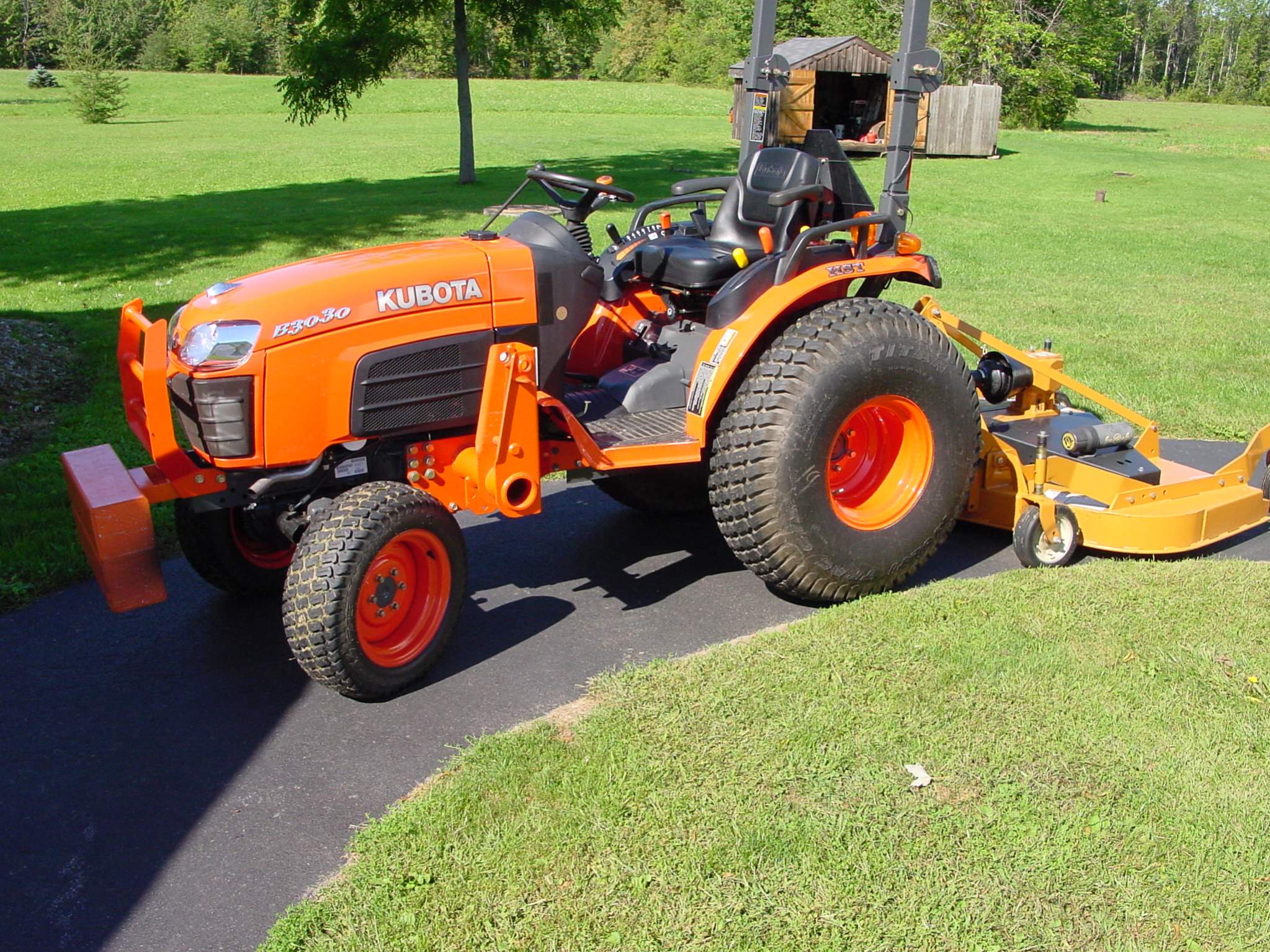

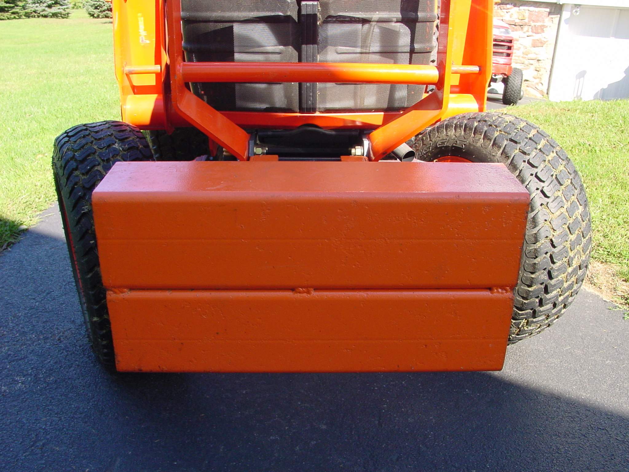

I made my own counterweights from some 6" tube steel and some 2" angle iron I had. Filled the tube steel with concrete mix and it weights in at 170 lbs. More than enough for my brush hog and finish mower. I can put it on and take it off in ten minutes. It just bolts to the front of the tractor frame using the holes that are in the frame. I have no more than $25.00 in the whole thing. All you need is a welder, band saw, and some talent.
