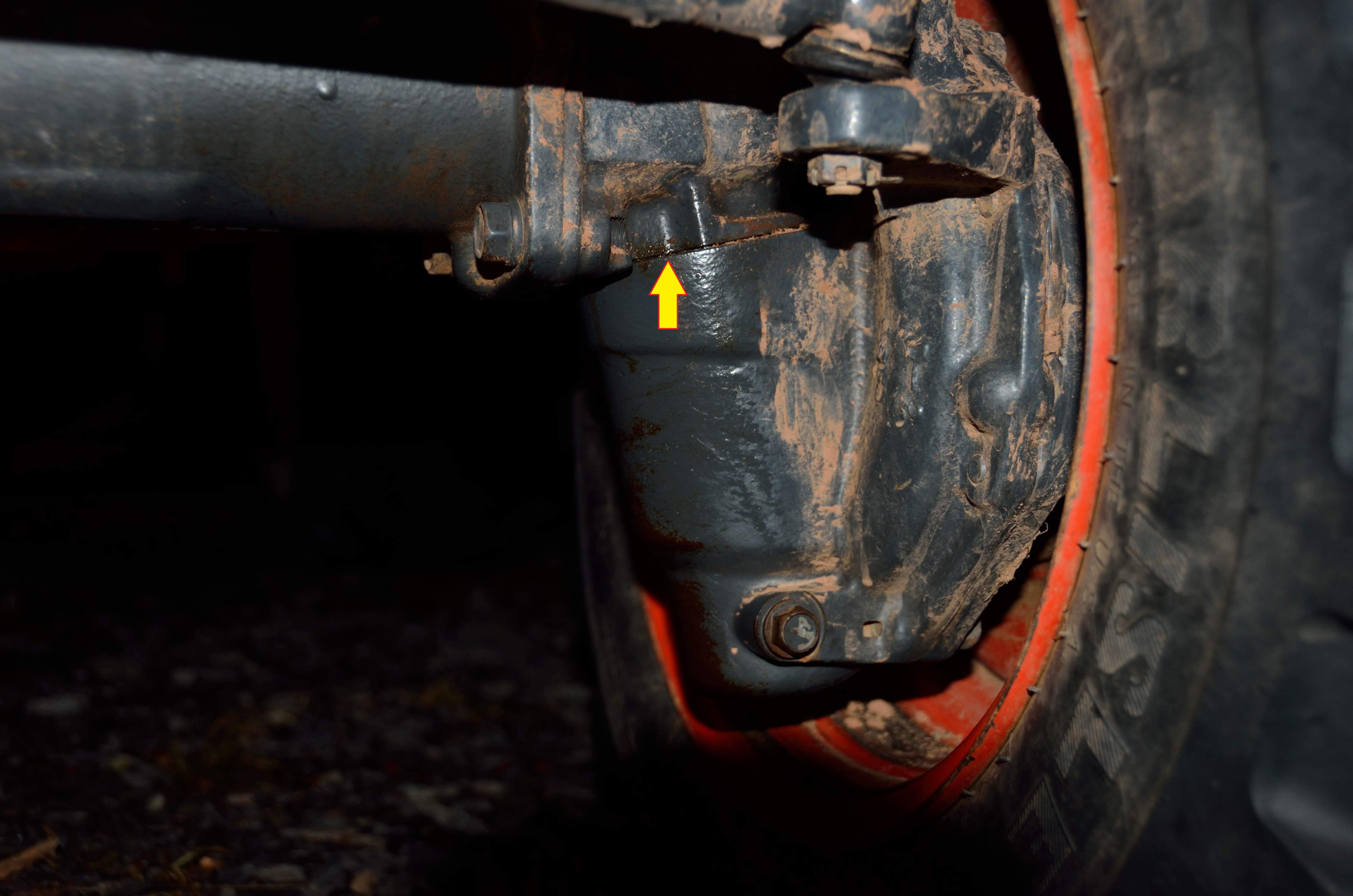

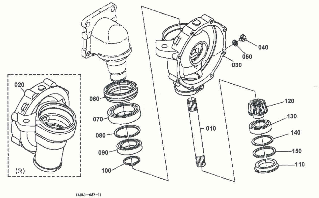

I've noticed a few older posts on L series Kubotas with front axle leaks but nothing on a B7510. I'm looking for advice on changing the seals. The front axle seems to be leaking from the top of the housing (see arrow in attached photo) on both sides. I found a couple exploded parts diagram (attached) with the seals labelled (not sure what model Kubota this is) with letters A, B, C, D. Any idea which seal this is likely to be?
Thanks,
Sean

And your lucky letter is A. I have done this repair twice on one side of my L4200, not too hard, but you need a large size snap ring plier, to get apart. Pull the bottom plug and work your way up.
Ken

Thanks Ken. I'm assuming the front wheel needs to be taken off to get at these seals? It's winter here now, so I may try to just top up the fluids and watch to make sure things don't leak too much until Spring.

Yes, pop the wheel and then the bolts on the hub flange, exposing the internals.. Large snap ring for the first external "C" clip, then it should slide down allowing access to the seals.
Get some RTV as well, you'll need it to button the flange up.

To temporarily slow the leak, I replaced the axle oil with gear-oil instead of the lighter transmission oil that was in it. The manual says you can use either but gear oil slowed the leak considerably.
I talked to the guys at the Kubota dealership and they gave me photocopies of the shop manual for how-to instructions on the seal replacement. You can see the part numbers on Kubota's on-line catalog viewer. I'm in Canada so I signed in here
Object moved
The seal at the top in the diagram there is part # 6C19056220. The dealer said these go from time to time. If your oil was milk colored it probably got water in it.
