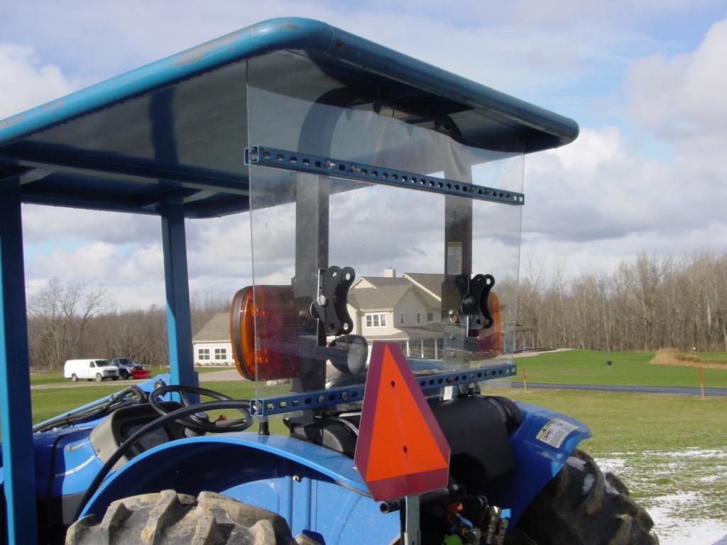

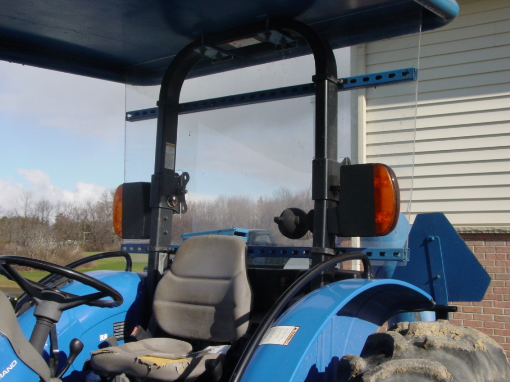

Last summer I added a 3/8" Lexan (polycarbonate) shield to the rear of my NH TN65. I was getting pinged frequently while brush cutting. Since I added the shield, it's already full of pot marks. It also helps catch the dirt from the rototiller, harley rake & snowblower.
Next summer I intend to make another shield that wraps forward around the seat to protect me from tree branches. Polycarbonate can be bent on right angles at room temperature with a metal brake.
The steel bars simply clamp the sheet to the ROPS using U bars with no tractor modifications.
The steel top in the middle picture is 1/4" steel plate. I smashed the instrument panel with a branch falling out of a tree while in the woods.
Total cost was less than a single ambulance ride.
