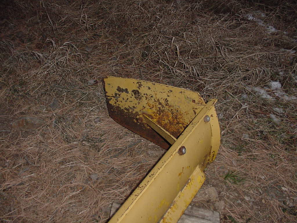

Congratulations! I'm sure you will be having a lot of fun. Make sure that there is some sort of shear pin or slip clutch on the PTO shaft to the mower. That's what protects the tractor's PTO gears if/when the mower blade comes to a sudden stop against a hidden rock or stump. There is also another type of clutch - sometimes built into the tractor itself - that is called an over-running clutch. That clutch s what prevents the blade momentum from driving the tractor forward when you slow down. I don't know if the 641 has that feature, but someone will know.
The PTO shaft needs grease on the sliding splines and in the U joints. Most bush hogs also have lube in the right angle gearbox that sits on top of the bush hog body. It is common for lube to leak out the seal between that gear box and the mower blade. That's not a problem; most older hogs will leak some there. Check it before use.
Back blades.... all of them have an adjustment for blade angle. Better back blades also have an adjustment to offset the blade from one side to the other. The top of the line back blades will have a total of three blade adjustments as well as bolt on end pieces that turn the back blade into a sort of box blade. Hydraulic control on the back blade is nice, but not necessary. Pins and cotter pins for adjusting blade angle, offset, and tilt are more common and work fine.
Be careful. Go slow. You can't go too slow to start. Bush hogs can throw things an astonishing distance. Don't ever trust a spinning hog.

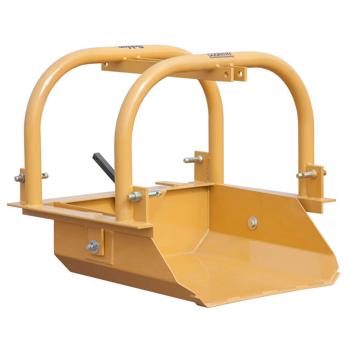

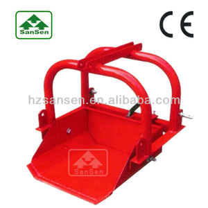

I'd agree with all of that. And for $5000 it is going to be well used and probably has some shortcomings. Around here there are occasional decent older homeowners selling FEL tractors for that price, but they go fast.
My friend who has a Massey very similar to the 641 Ford put a rear 3pt dump bucket on it and said the main problem he had with the rear bucket was that the tractor ran so well and the rear bucketworked just good enough to keep him from justifying buying a real FEL & tractor..... which would of course be quite a bit better.
He ended up haying his 10 acres for 20 years without a loader. "Stubborn" is the word that comes to mind.
Most FELs today are quick attach/detatch (QA) type so having a FEL is no longer an impediment for mowing. More and more we are seeing buckets that are also quick attach/detach (SSQA) too, and that's even easier since the hydraulic hoses can stay plugged in.
